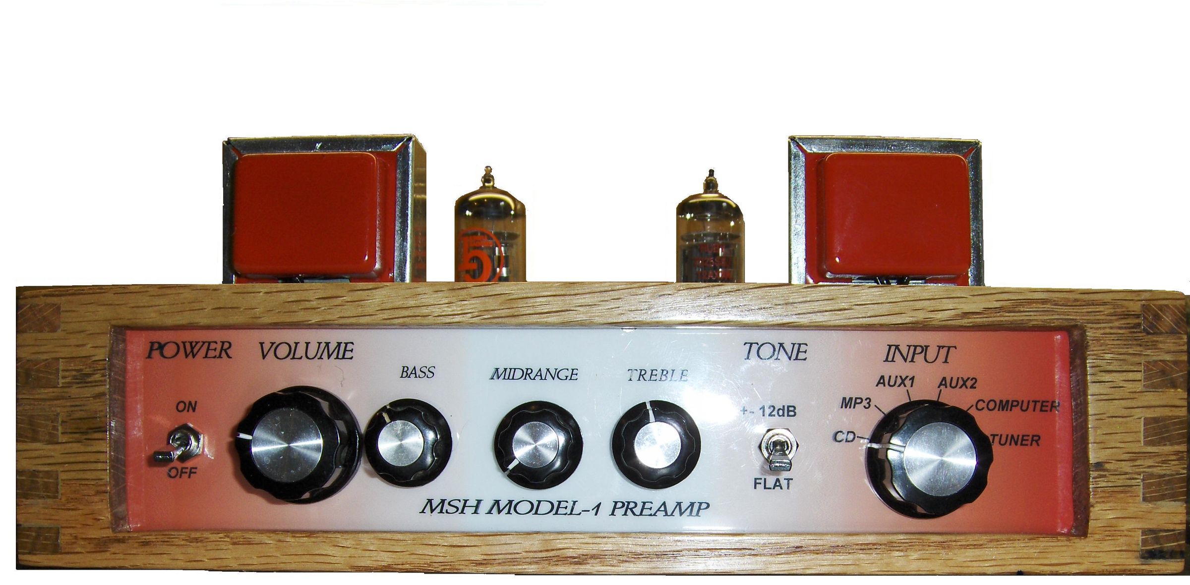

Below is the mono HIFI preamplifier I built to go with the Model-1 Power Amp.
