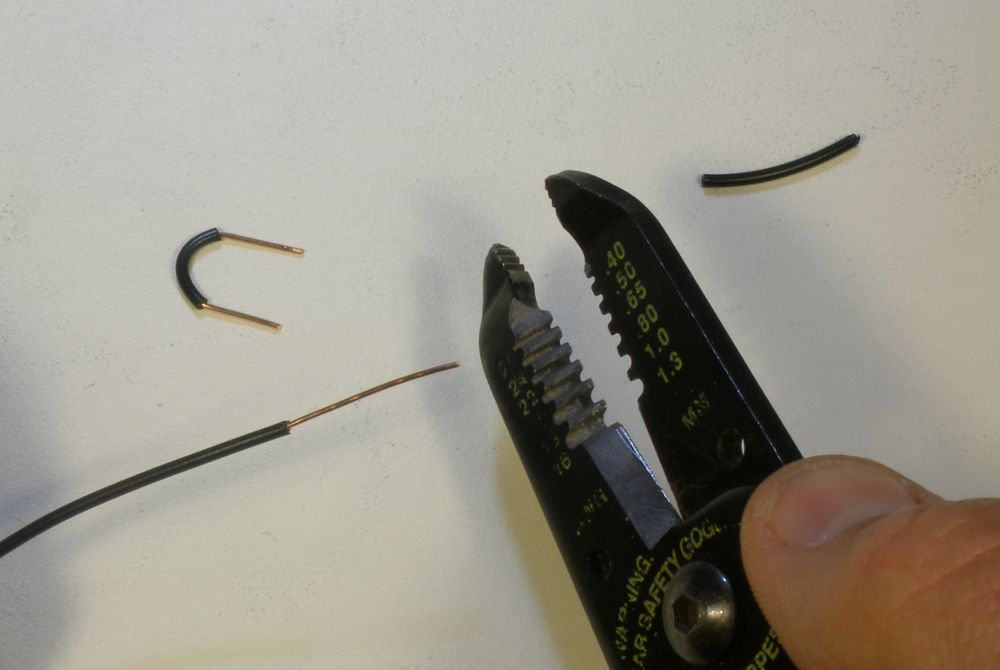

Pull the breakout out of your breadboard very carefully. Rocking it back and forth slightly can help ease it off. Now take that length of insulation that you stripped off to make the GND pin and cut two tiny pieces that will serve to insulate either side of our GND pin.

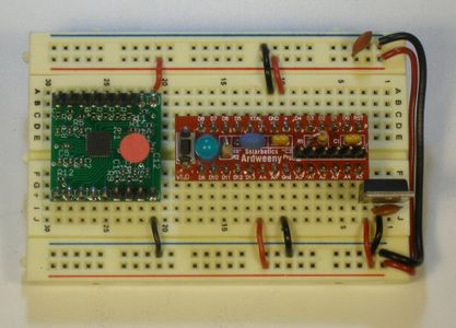

Step 3: Lashing the Breakout to the Arduino
These are the pin connections that we need to make for SPI:
- Pin Name Breakout Arduino
- SCLK 11 Digital 13
- SS 12 Digital 10
- MOSI 13 Digital 11
MISO 14 Digital 12
There are also two pins used for something called 'Handshaking' where each device confirms that they are ready to communicate. The pin connections are:
- DRDY 10 Digital 9
- CHNG 2 Digital 8
When the QT1106 decides that a sense event has occurred (touch, release, or slider movement), it sets the CHNG pin HIGH. This signals the Arduino that it should ask for new key and slider data via the SPI interface. When the Arduino starts the SPI, it first has to wait for the DRDY pin to go HIGH, otherwise, the QT1106 will miss all or a part of the communication. ALL OF THIS IS TAKEN CARE OF IN THE LIBRARY! THE LIBRARY WORKS HARD... SO YOU DON'T HAVE TO!
The last thing that you need to do is drop a couple of caps across the rails. These are Power supply conditioning capacitors, and they should be placed right next to the breakout +V and GND pins. I'm using 1uF, but 2.2uF will work just as well. If you don't have these in place, your sensor will go a little crazy and spit out a lot of noise and spurious touch signals!
