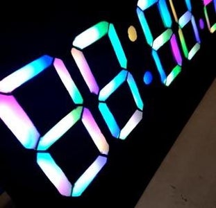

Introduction: 7-Segment Digital Clock Using LED Strip Lights
This instructable will guide you through the exciting process of building a LED digital clock from scratch, making it a perfect beginner-friendly project that blends electronics, coding and web development. We’ll start by assembling a segmental LED display, creating a reliable power supply using a 5V mobile charger and setting up an Arduino IDE to program our clock. Along the way, we’ll write code in Arduino IDE, design a sleek webpage using HTML, CSS, and JavaScript, and integrate it all to create a customizable timepiece that can change colors with a simple web interface. While this tutorial is designed to be detailed and beginner-friendly, it's important to note that soldering this clock can be a tiring task, requiring patience and precision, which might challenge your motivation—so take breaks when needed! Additionally, while my version was crafted using cardboard, you have the flexibility to 3D print, laser-cut, or use acrylic for a more polished and professional look. Get ready to dive into a rewarding DIY experience and bring your digital clock to life!

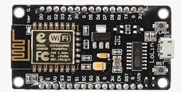

  1. ESP8266 NodeMCU CP2102 Development Board (microcontroller)

  3. The microcontroller acts as the brain of the project, managing the interactions between the LED strip and the RTC module. It processes the time data from the RTC and controls the LEDs to display the correct time.

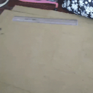

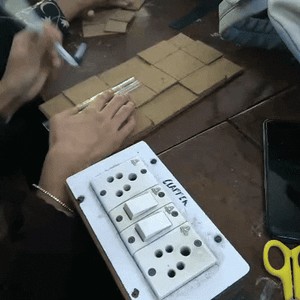

Step 5: Making Template to Trace Digit on the Cardboard
Here I made a template of a 7-segment digit and colon so I can just trace it on my base easily.

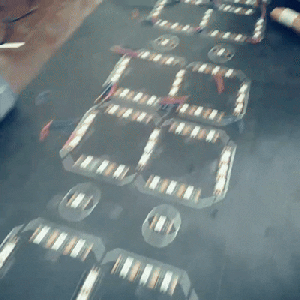

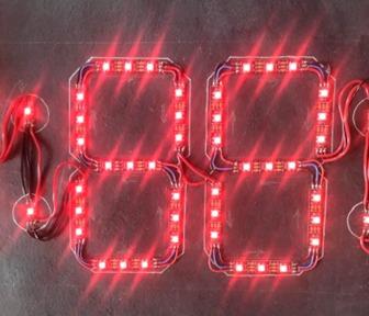

Step 6: Cut Strip Lights & Paste
To arrange and solder the WS2812B LED strip for a 7-segment digital clock, follow these steps:
  1. Determine the number of LEDs required for each digit (this is what I used you can use less leds to reduce the size of the clock)
  2. LEDs per segment- 3 LEDs
  3. LEDs per digit- 3×7segments= 21 LEDs
  4. No. of digits to display hours, minutes & seconds- 6 digits
  5. No. of colons (:) between digits- 2 colons
  6. LEDs required for colons- 4 LEDs
  7. LEDs required for all 6 digits- LEDs per digit×6= 21×6= 126 LEDs
  8. Total LEDs used- 126+4 colon leds= 130 LEDs
  9. Carefully cut the WS2812B strip into pieces:
  10. 42 segments (each with 3 LEDs).
  11. 4 colon pieces (each with 1 LED).
  12. Always cut on the designated copper cutting line to ensure the circuits of the individual 3-LED segments remain intact.
  13. Identify the DIN (data input), GND and VCC pins.
  14. Secure the LED strip on the base using adhesive.
  15. Before pasting see the diagram to get idea of how to arrange the cut LED strips.

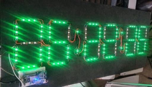

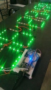

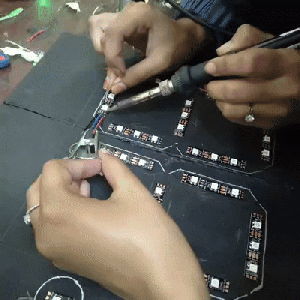

Step 7: Solder the Strip Lights
  1. Before soldering see the diagram to get idea of how to connect the cut LED strips.
  2. Solder the GND and VCC pins along the entire strip.
  3. Connect the DIN pin of each section to the DOUT (data output) pin of the previous section.
  4. Use thin wires to connect the sections if necessary.
  5. Add connectors for power (VCC and GND) and data input (DIN).
  6. Wire the entire display in a single, continuous data chain:
ESP8266 > Digit 1 > Digit 2 > Colon 1 > Digit 3 > Digit 4 > Colon 2 > Digit 5 > Digit 6
(code file attached below is for this clock to work without webpage control)

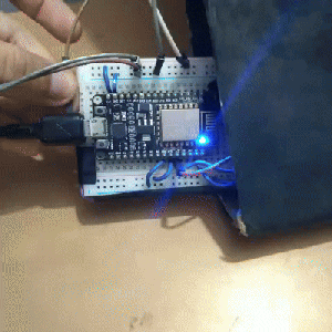

Step 8: Circuit Diagram Connections
  1. ESP8266 Microcontroller:
  2. Power Supply:
  3. 3V3 pin: Connected to RTC module’s VCC.
  4. GND pin: Connected to RTC module’s GND and the GND of the LED strip.
  5. Data Pins:
  6. D1 (SCL): Connected to RTC SCL pin.
  7. D2 (SDA): Connected to RTC SDA pin.
  8. D6 (DIN): Connected to the data input of the LED strip.
  9. RTC Module (DS1307):
  10. VCC: Connects to the 3V3 pin of the ESP8266 for power.
  11. GND: Connects to the GND pin of the ESP8266.
  12. SCL: Connects to the D1 pin of the ESP8266.
  13. SDA: Connects to the D2 pin of the ESP8266.
  14. LED Strip Lights (WS2812B):
  15. Power Supply:
  16. +5V: Connects to an external 5V power supply.
  17. GND: Connects to the GND of both the power supply and the ESP8266.
  18. Data Input (DIN): Connects to the D6 pin of the ESP8266, allowing the microcontroller to send data to the LEDs.
  19. Power Supply:
  20. Provides 5V to both the ESP8266 (via VIN pin) and the LED strip.
Common ground connections ensure a stable circuit.

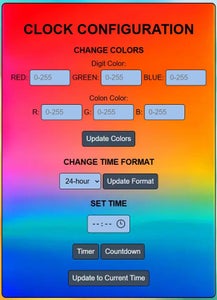

Step 9: What Does the Code Say?
Web interface for User Control: This webpage enables us to:
  1. Customize clock colors: Users can modify the RGB values for digits and colons.
  2. Change time format: The clock supports 12-hour and 24-hour modes.
  3. Set custom time: Users can manually enter a specific time.
  4. Enable timer and countdown modes: Provides additional functionality for timed events.
Web Page Implementation:
The ESP8266 hosts a local web server, allowing remote access to the clock's controls via a smartphone or computer.

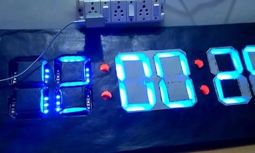

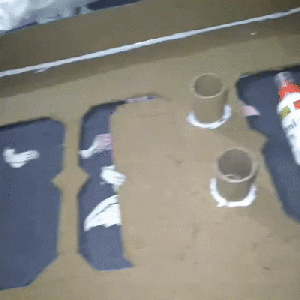

Step 11: Build the Outercover of Clock
To build this clock I made it layer by layer:
  1. Took a plane cardboard base, drew the digits, stick & solder the leds.
  2. Took another cardboard sheet to make the digits in 3D.
  3. Covered the outer cover with brown covering paper.
  4. Painted the whole clock with black paint.
  5. Covered the digits with tracing paper and painted it edges with paint to give it a clean look.

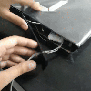

Step 12: Cover the Clock to Protect It
Finally took a transparent covering paper and covered the whole clock with it. And with black tape I secured the edges of the clock.
Previously, I left some space to place electronics inside it. So, that space will be used to program the clock in future and give it external power supply.
Step 13: Use External Power & Hang the Clock
I can't run this clock on batteries so I used a 5volts mobile charger. I separated its positive and negative terminals and gave power to my clock. It runs perfectly now.
