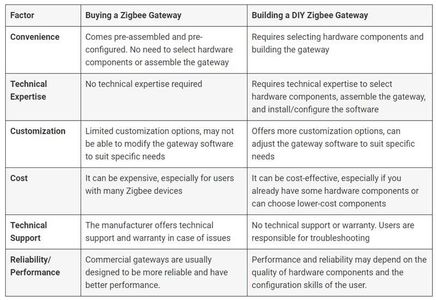

Since commercial Zigbee gateways can rarely be customized, some users may think of building their own Zigbee gateway. Meanwhile, making your own Zigbee gateways can save you money. However, before building a Zigbee gateway on your own, you should think about your technical skills. Installation, use, and debugging call for considerable technical abilities.
