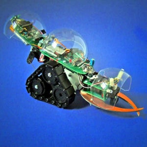

If size is not an issue, allow more room than you think you need to fit the main components. Packing too tight can make soldering difficult and slow and increase the chance of noise problems between components. Pic 1 was hard to solder because I was trying to fit a remote control on a ring.
