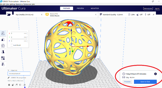

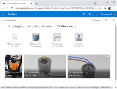

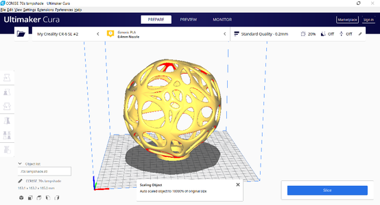

Step 1: Download STL Files - Open in Cura - Slice and Save
In my OneDrive 4 STL files are stored:
Please download these files and store them on you computer.
These 4 files need to be 'sliced' on your computer in order to get a printable file for your own 3D printer. Only then they can be printed. 'Slicing' is method to change objects (meshes) into a pattern that can be drawn in layers by a 3D-printer (lines in XYZ coords). Ultimaker Cura is a program that can do slicing.
You can download Cura here. After installing Cura, please change default settings to fit your own 3D printer.
Now you are ready to open the first STL file and slice it.
After slicing you're asked to save the result to disk or a SD card. Then use the interface on your 3D-printer to print the file. As you can see in one of the pictures....printing can take some time.

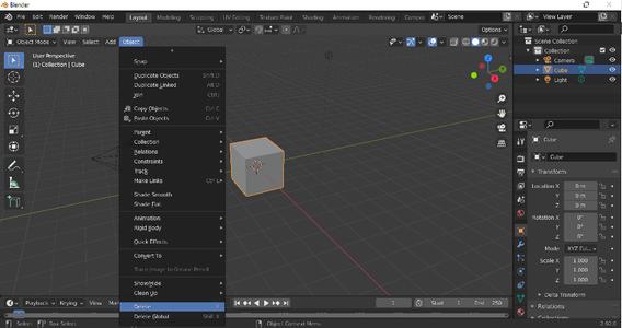

Step 5: Additional Paragraph: Designing the Lamp in Blender
So, you want to design your own lamp?
Here's how I created the lampshade

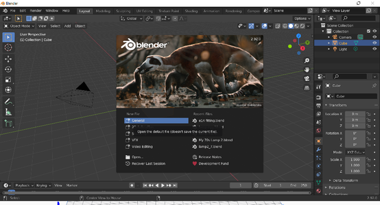

- download and install Blender https://www.blender.org/

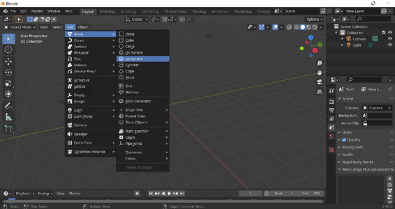

- Aftsr installing, open Blender. Start with the default scene.
- Delete the default Cube

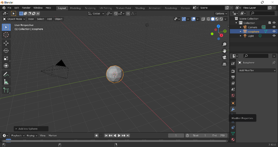

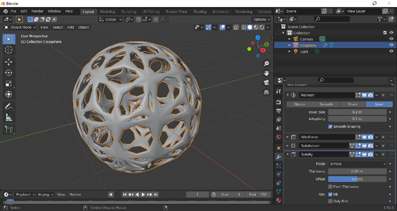

- Add an IcoSphere

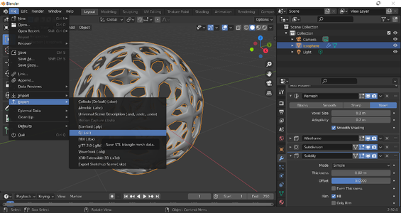

- Go to the modifiers tab
- Add a Remesh modifier, set it to Voxel, set Voxel size to 0.2m, adaptivity to 0.2m and enable Smooth Shading
- Add a Wireframe modifier and a subdivision modifier
- Add a Solidify modifier and set offset to 0 and thickness to .05m
- Apply modifiers
- Do some additional editing and sculpting
- Then export the selected object as STL file.
