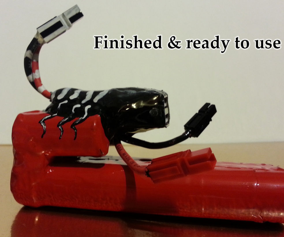

This is a Simple Supplement to my Scorpion 12v Battery Pack
https://www.instructables.com/id/THE-SCORPION-USB-P...
