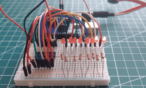

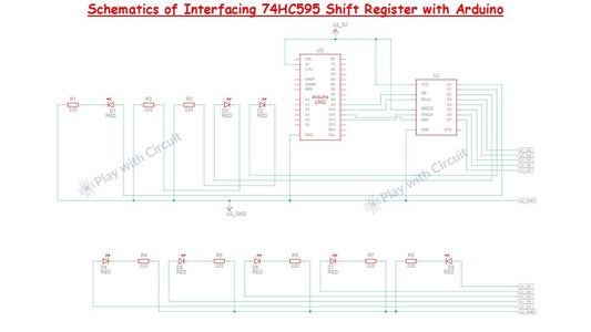

Step 3: Wiring a 74HC595 Shift Register to an Arduino
Let’s start interfacing 74HC595 shift register with an Arduino UNO.
We will use the shift register to control 8 red LEDs connected to output pins QA to QH.
Place the 74HC595 IC on your breadboard, with each side of pins on separate breadboard rails.
Identify Pin 1 — it’s just to the left of the small notch or dot on the IC.
Connect Power Pins:
  1. Pin 16 (VCC)5V on Arduino
  2. Pin 10 (SRCLR)5V on Arduino (disables clearing)
  3. Pin 8 (GND)GND on Arduino
Enable Output:
  1. Pin 13 (OE)Arduino Pin 9 (PWM-enabled for brightness control)
Connect Control Pins:
  1. Pin 11 (SRCLK)Arduino Pin 12 (Shift Clock)
  2. Pin 12 (RCLK)Arduino Pin 10 (Latch Clock)
  3. Pin 14 (SER)Arduino Pin 11 (Serial Data Input)
Connect Anode of LEDs to Output Pins (QA to QH):
Pins 15 (QA), 1 (QB), 2 (QC), 3 (QD), 4 (QE), 5 (QF), 6 (QG), 7 (QH)
  1. Connect a 220Ω resistor in series with each LED.
  2. LED anodes go to the shift register outputs; cathodes go to GND.
