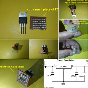

Step 3: Prepare the PCB and Solder the Components
Follow these steps to create the module:
  1. Cut a small piece of PCB.
  2. Mount the IC and solder it.
  3. Position the 10 uF capacitor in front of the 7805 and solder the leads.
  4. Connect the positive lead (longest one) to the first pin of the 7805.
  5. Connect the negative lead (short one) to the middle pin (pin2) of the 7805.
  6. Mount the 100 uF capacitor behind the 7805 and solder.
  7. Connect the positive pin of the capacitor to pin 3 of the 7805 and the negative pin to pin 2 of the IC.
  8. Position the 0.1 uF capacitor parallel to the 100 uF capacitor and solder the leads alongside.
Refer to the attached pictures for further clarification.
Step 4: Wire Connections
Connect the wires for input and output:
  1. Solder a blue wire to pin 2 (middle) of the 7805 and a red wire to pin 1, both for the input.
  2. Solder a black wire to pin 2 (middle) of the 7805 and a red wire to pin 3, both for the output.
