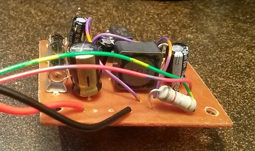

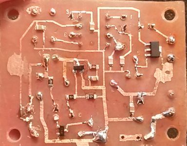

Step 2: Driver Board
The circuit's very similar to my previous microcontroller based boost converters. The main difference is that a 20 MHz oscillator was used. A 24V zener diode was selected in case of open voltage or too high of an LED string voltage. If the output exceeds 24.7V, the NPN transistor turns on, causing the microcontroller to reset which protects the MOSFET, output capacitor, and Schottky diode from overvoltage.
Note that the drive current was selected for a 0.82 ohm current sense resistor.
