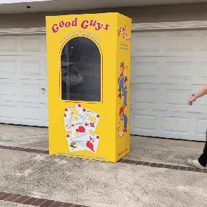

I wanted to build a life-size 7-foot-tall toy box photo booth for people to take photos in and enjoy.
My goals for the build:
  1. Collapsible & portable – easy to store and transport.
  2. Weather-resistant – durable enough for outdoor displays for a month or two.
  3. Swappable “skins” – easily switch themes, like a Chucky box for Halloween or a Turboman box for Christmas.
  4. Fully enclosed – looks like a solid toy box from the outside, with hidden entry doors on the sides.
  5. Seamless panels – no gaps between sides for a clean, professional look.
  6. Removable top – adjust lighting based on location.
  7. Lightweight but sturdy – strong enough to stand up to weather and use, but still manageable to move around.

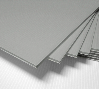

  5. 4mm thick corrugated plastic panels: https://signworldamerica.com/products/intepro-corrugated-plastic-silver
  6. I chose gray because I thought it looked best as the backdrop inside the box but choose any color you’d like

If your corrugated plastic and acrylic panels weren’t pre-cut, cut those now:
  1. Clear acrylic front panel: 84" tall x 44" wide
  2. (2) Side corrugated plastic panels: 84" tall x 24" wide
  3. Back corrugated plastic panel: 84" tall x 44" wide
  4. Top corrugated plastic panel: 44" wide x 24" deep
If you want fewer reflections on your box, you can use another piece of corrugated plastic for the front instead of acrylic. Just cut the window out of it after applying the vinyl. If you do that, you may want to reinforce it with an extra cross member of 2x2 wood since corrugated plastic isn’t as sturdy as acrylic.

You now have a 7-foot-tall Chucky Box Photo Booth!
To collapse it for storage, fold the sides over the front (this also protects the vinyl graphics), then lay it down on its face and remove the top and back panels. Unscrew the wooden back frame and side edges (just 8 screws total). It can be disassembled or reassembled by one person and stores fairly flat.
Adding a small LED light strip to the inside top makes a big difference with lighting and reflections, or you can leave the top off for more natural light.
My plan is to make more toy box versions like Turboman or Woody from Toy Story. You can reuse most of the frame and back panels, just remake the front and side panels.
