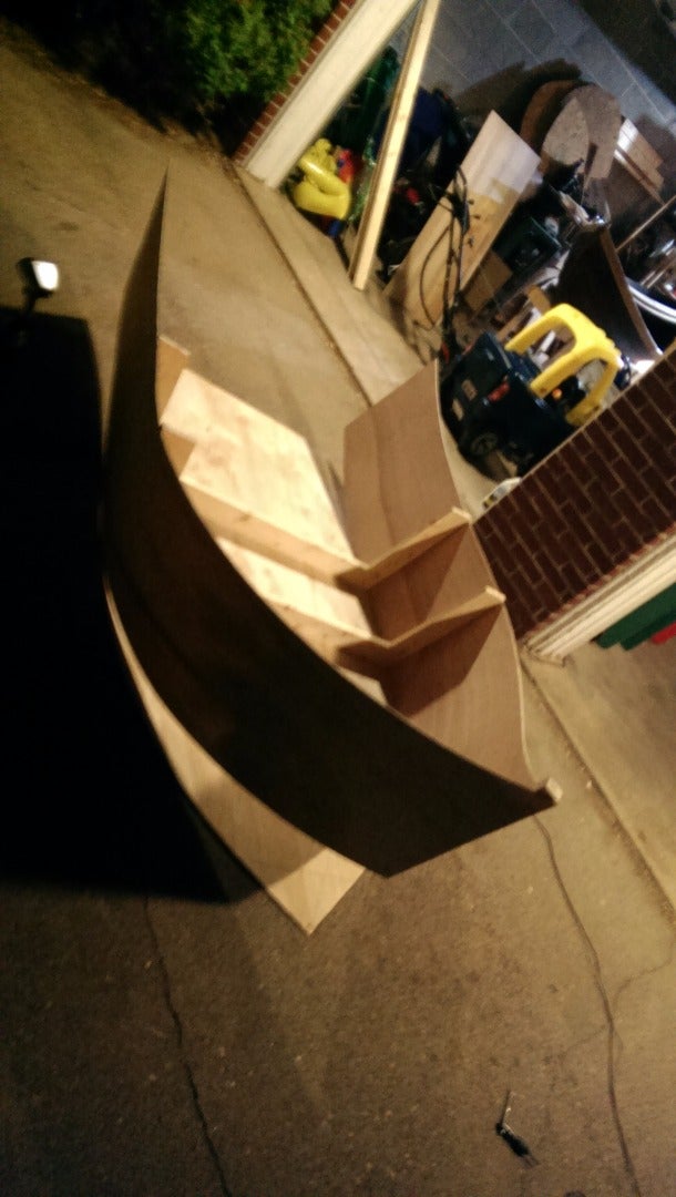

Step 3: Cut and Add Beams
The boat had to be strong enough to keep out 6 cubic feet of water (a cubic foot of water weighs 64 lbs), but light enough to portage short distances. And it had to withstand collisions with branches and rocks. 1x4 beams provided this strength. Cutting these was a matter of guesswork. In order to look boat-like, these were angled so the boat's maximum width would be 4 feet at the top rail (the gunnels) and 3 1/2 feet at the bottom. A jigsaw works fine for these cuts. The beams were spaced on foot apart. This spacing, like many things about this boat, was based on a guess.

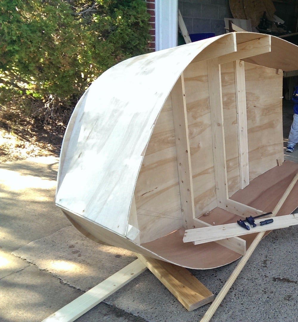

Step 4: Cut and Add the Sides
With two beams added (maybe there is a more technical term than 'beam'), the sides panels of the boat could be added. To create the sides:
- Cut a 4x8 sheet of plywood into two 2x8 peices.
- Lay these on top of each other.
- Draw out the side. Make the ends curve up slightly. The height should be between 1 and 1 1/2 feet.
With the sides made, screw them to the beams. Be careful to make sure the beams connect to the sides at the same spot. Otherwise, the boat will be asymmetrical. Boat design is very forgiving, with few exceptions. This is one of them. An asymmetrical boat has large cracks to fill and looks bad.
To get the front ends to meet, cut a 2x2 and screw it to the front of one of the plywood panels. Bend both panels until they link up to the 2x2. Make sure they are screwed in. The front, or stem, of the boat is almost ready.
Finally, lift the front of the bottom panel and screw it to the bottom of the 2x2. Sand or saw off any excess wood from the bottom panel.
The most difficult part of the build is complete.

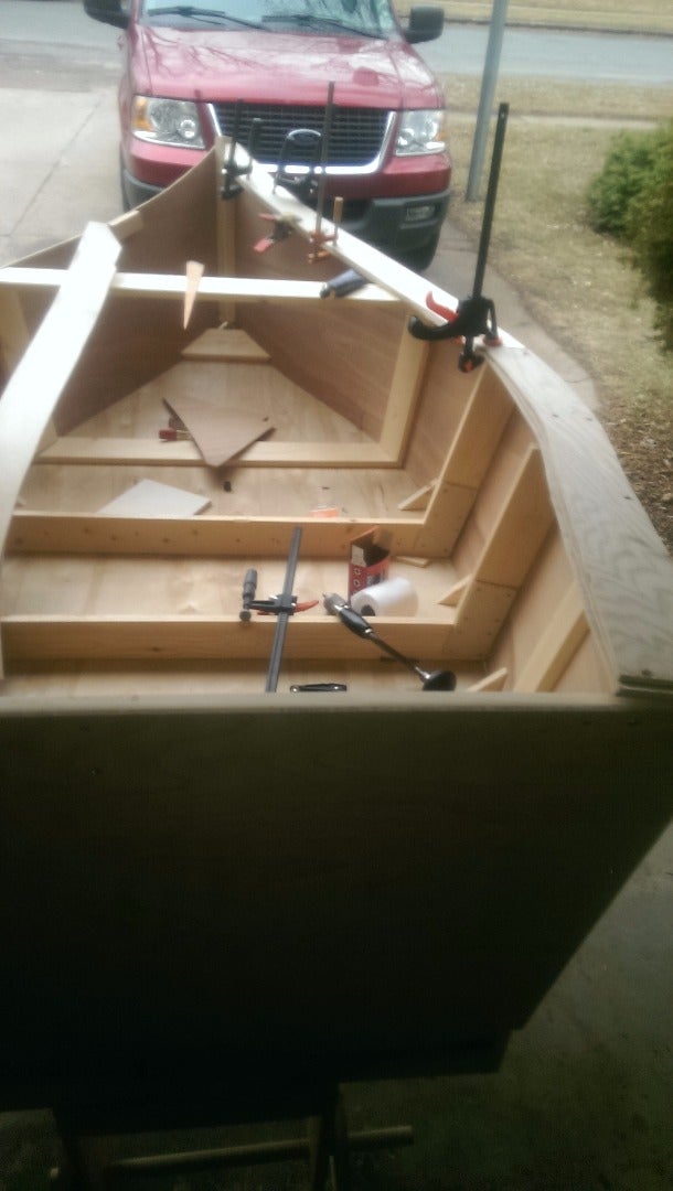

Step 5: Add the Transom
The transom is the back of the boat, shaped like a trapezoid. Determine how wide you want the top rear of the boat and draw out the shape in a piece of plywood. Be mindful of symmetry and make sure the height of the part matches the two side panels. Cut the shape out, then cut and screw in 1x4 chords to give it strength.
Step 6: Complete the Hull Structure
Right now the sides are not well attached to the bottom and large gaps line the edges of the bottom. Reduce these by cutting small triangles out of 1x4's and place these along the bottom edges half way between the beams. This should reduce these gaps. The smaller the gaps are, the less epoxy is needed later.
This is also a good time to add the mast holder. Cut a 1x4 and place it across the top of the structure, close to the stem. Cut a 1 1/2 inch hole in the center with a jigsaw or (if you have one) a 1 1/4 inch drill bit. This will keep the mast in place. Take another 1x4, cut a similar hole in the center, and place on the bottom panel. Carefully line it up to the top mast holder. If these top and bottom mast holders aren't lined up closely, the eight-foot mast will have an obvious lean.

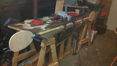

Step 7: Create the Gunnels
Gunnels are the side rail. These add to the structural strength and provide a good place for your hands to grip when boarding, lifting or portaging the boat. To be light, strong and good-looking, take a 4-foot long piece of plywood and trace it along the top of one of the sides. Draw another line four inches parallel to it, then cut. Do this four times:
Along the starboard (right) front. Along the port (left) front.Along the starboard rear.Along the port rear.Make sure there is some overlap between the front and back pieces. You'll have four curvy panels to line along the top of the boat. Use these parts as a template to make two more copies of each panel.
The goal is to create three layers of panels. These three layers are visible in the image, clamped together. When all three are complete, sandwich them together. Glue them together with Epoxy and clamp down. More on Epoxy in the next section.

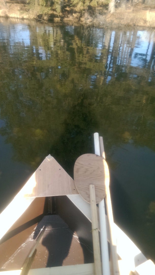

When both gunnels are complete. Cut a triangle out of 1x4 plywood and place it on top of the stem. This is just for looks.

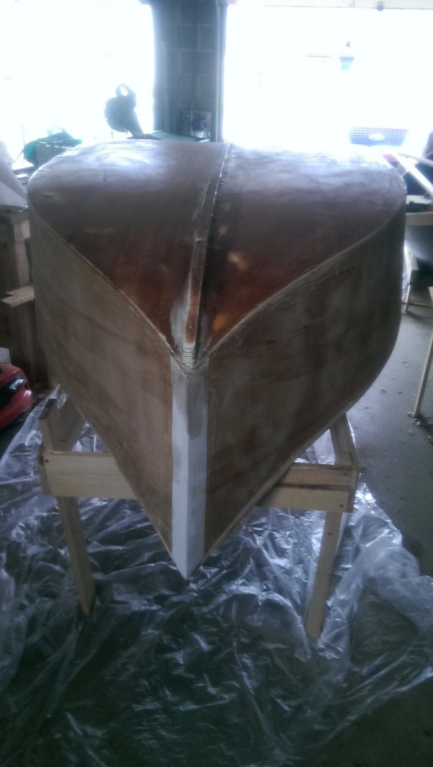

Step 9: Add the Keel and Cover the Stem
The keel helps keep the boat stable and helps it grip the water and stay strait. Most small sailboats have a deep keel that you sink into the water before setting sail. Usually the setup is complex. I've built two boat that don't have one, and I haven't found a need for a deep, removable keel. This boat uses five strips of plywood. Cut five 1-inch-wide strips of plywood and place them along he bottom center of the boat. Screw them and glue them together. Cut off any excess wood that sticks out in front of the stem. Just that simple. No special detachable keel needed.
The stem has an unsightly crack where the front of the side panels meet. Cover this with a piece of tag board. Yep, paper. Everything will be water proofed, so paper works fine.

Each oar is a 2x2 chord of pine. Cut the corners with a jigsaw and sand it down until the wood is rounded. Closet hangers also work, require no cutting and sanding, but are five times as expensive. Cut a notch into one end of the wood. This is where the paddles will go. The paddles are made of half-inch plywood panels. Glue the paddles and oars together with epoxy. Screw them together for added strength. Spray each oar and paddle with 2-3 coatings of Spar Urethane.
