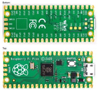

We are now going to build our circuit on a breadboard. To do this effectively, it helps to understand the pinout and layout of the Raspberry Pi Pico W (2W). This knowledge will make it easier to identify which GPIO pins to use and how to wire your components properly.
I recommend you take some time to study the provided diagrams and pinout images, as well as refer to the official Raspberry Pi Pico W datasheet, which includes detailed technical information about the board, its pin functions, and electrical characteristics.
📄 Official Raspberry Pi Pico W Datasheet:
👉 Download the PDF from Raspberry Pi Foundation
Understanding the physical pin numbers vs. GPIO numbers is especially important when connecting buttons, buzzers, and other peripherals to your project. This preparation will help avoid common mistakes and ensure a smoother building process.

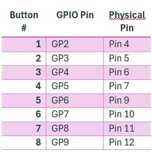

Step 4: Connect the Push Buttons
Connect each button between a GPIO pin and GND. We'll use internal pull-up resistors in code, so no need for external ones.
Since I cannot upload the Table please refer to the picture of the table.
Also note that I have choosen these certain PGIO pins but in theory you can use every GPIO.
If you do change the pins, make sure you also change this in your Thonny Code later on.

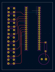

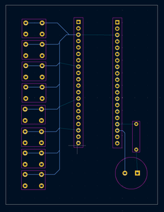

Step 9: Optional: Make a BCP Design
Step 10: Connect the Right Lines
Step 11: Have Some Fun

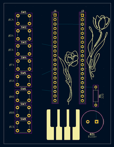

Have some fun and make it your own.
You can put nice text and pictures on the silkscreen.
Pictures can be imperted in a DXF or SVG file.
