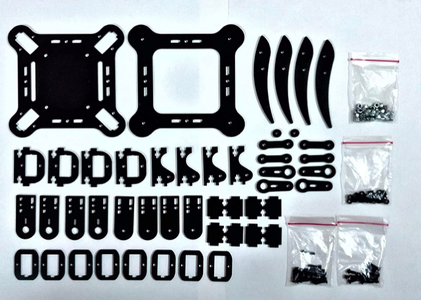

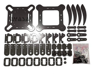

Step 1: Assemble the Physical Model
In my case i followed the instruction in the manual and all the components were given in the booklet itself. However, you can find a similar model on the internet and 3D print it or get an acrylic cut according to the model. Do not forget to properly add the motors at right places.
