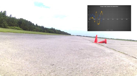

First let's look at just the accelerometer data. We can create a scatter plot of the lateral acceleration versus the linear acceleration over a given lap. This will give us a cluster of points which will show where the car's strengths are as well as how well we're following the traction circle. Overall, this plot is mostly useful for analyzing our own driving technique.
Next, we can start performing some basic tests. By finding a quiet road to do a pull from second gear, we can use the accelerometer to back calculate real world torque curves. (Keep in mind that rolling resistance and aerodynamic drag will alter this number. These can be found through a simple coast down test.)
Plotting acceleration versus time will allow us to further analyze our driving by showing where we gain and loose time from lap to lap.

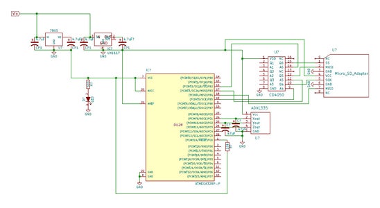

The circuit consists of four parts: the voltage regulator, the accelerometer, the micro controller, and the memory card.
The voltage regulator will consist of a 5v regulator to power the micro controller, a 3.3v regulator to power the sd card, accelerometer, and provide a reference for the micro controller, and some capacitors (caps) to filter out any fluctuations in the voltage coming in and coming out of the regulators. Soldering these components is pretty straight forward, just keep in mind that the pinout is different between the two regulators and be sure to check the polarity of the caps before soldering.
Assembling the accelerometer will include the accelerometer and two caps. I chose not to filter the z-axis as I'm not taking any measurements other than ride frequency using this axis. If you wish to look for specific frequencies the accelerometer's data sheet gives capacitance values to cut off a given frequency. Remember to connect the 3.3v line, not the 5v line to the sensor.
Soldering the micro controller may look intimidating, however keep in mind that we will not be using all of the pins. Pay close attention when making the connections in this step as the micro controller can easily be damaged if power is sent to the wrong pins. I would also highly recommend taking some dielectric grease and coating the pin slots in the socket. This makes it much easier to install and remove the chip and reduces the likelihood of damaging it in the process (I've actually had the slots pull out of the socket without the grease!).
Finally, there's the memory card circuit. This applies to the rest of the circuit, but especially when dealing with the memory card keep your wires as short as possible. I've found that this part of the circuit is very sensitive to noise and will act up if there's any questionable solder connections, excessively long wires, or anything else that could introduce noise into the circuit. So go slow and double check each connection as you go.
