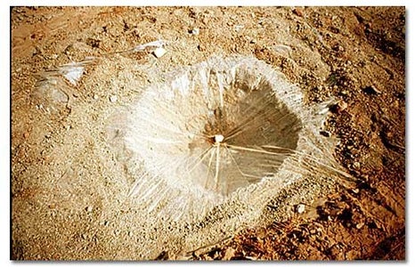

Desert-style "Pit" Solar Still
Pros:
  1. Portable
  2. Cheap
Cons:
  1. Requires a lot of creation/maintenance time (you have to dig a pit and fill it with plant matter)
  2. Inefficient (you don't get much water out, largely because the pit is not very well sealed no matter how much dirt you add)
  3. Risk of wildlife getting into the still (or someone falling in)

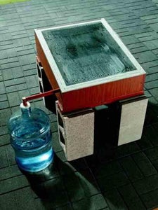

Glass-style "Permanent" Solar Still
Pros:
  1. Efficient
  2. Safest for long-term use (materials hold up well to UV light)
Cons:
  1. Not Portable
  2. Expensive
