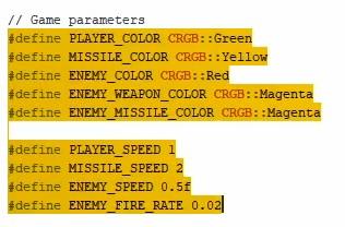

Step 4: Code Settings
As for the code, it should be noted that it is not as simple as I initially imagined, but it is highly customizable and at the beginning of the code we can change many parameters, of which the most important for the gameplay are: PLAYER_SPEED, MISSILE_SPEED, ENEMY_SPEED and ENEMY_FIRE_RATE. Regarding the installation of the code, I used Arduino IDE v 1.8.16, and ESP8266 Core v 3.1.2.
