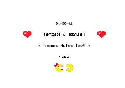

It seemed like a nice idea to put a wedding wish on the back of the case. A few weeks ago I saw a technique I liked very much and I thought was perfect for this project. If you print a design (mirrored) on wax paper using an inkjet printer, you can then transfer your design directly onto the wood, which I think gives a beautiful effect.
There are manyInstructables explaining how to do it, but I have one good tip if you want to try it yourself. If you feed the thin wax paper into your printer, it will probably jam. Some tell you to tape the wax paper to normal paper, but that didn't stick in my case. What worked for me was staple the wax paper to normal paper. Be sure to put the staples in along the top edge, not vertically, otherwise they may get stuck in your printer. The normal paper also enables you to use painter's tape to fix the printed paper to the case when transferring the image on with a plastic card.
My design is the wedding date, the happy couple's names, the wish and my name, with 8-bit hearts on the sides and Mr. and Ms. Pac-Man to complete the arcade feel. I've attached the design as an xcf-file for you to edit using free image editor GIMP.
I first tried a great arcade type looking font called 8 bit wonder, but a test on a piece of wood showed that the ink from the thick black letters would run. The second time I tried with the thinner font Mozart NBP, which has the added advantage over the first font of containing asterisks, an ampersand and an exclamation mark. I am very pleased with the result.
