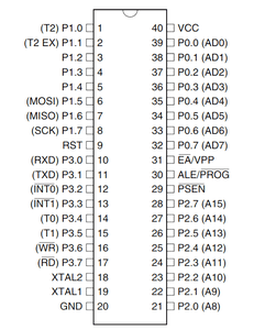

  1. Insert the AT89S52 Microcontroller chip on the breadboard.
  2. Connect the Vcc pin(40) of IC to +ve line(rail) of the breadboard with a red(you can choose any color, it has no technical sense) jumper wire.
  3. Connect the EA/Vcc pin(31) to the +ve rail of breadboard.
  4. Connect the GND pin(20) Pin of the IC to -ve line(rail) of the bread board.
  5. Connect a 12 MHz crystal on XTAL1 pin(19) and XTAL2 pin(18) of IC and also connect a 22PF or 33PF ceramic capacitor on XTAL1 and XTAL2 pins and -ve line (GND).
  6. Connect an LED on PORT1.0 pin(0) of in such a way that anode of the LED is connected to +ve line and cathode is connected to PORT1.0 pin of the IC in series with a 330 ohm Current limiting resistor.
  7. Connect the SPI(Serial Peripheral Interface) pins and reset pin of IC to the ISP programmer(Arduino UNO) according to following wiring scheme.
P1.5 (MOSI) pin(6) ----------------> Pin 11 of Arduino UNO.
P1.6 (MISO) pin(7) ------------------> Pin 12 of Arduino UNO.
P1.7 (SCK) pin(8) -------------------> Pin 13 of Arduino UNO.
Reset pin(9) ---------------------------> Pin 10 of Arduino UNO
Connect the +ve(red) line and -ve(blue) line of the bread board to the 5V and GND pins of Arduino UNO respectively.
now all the wiring is finished here.
NOTE: Please check and match all the wiring connection of your circuit with the help of given circuit diagrams.
