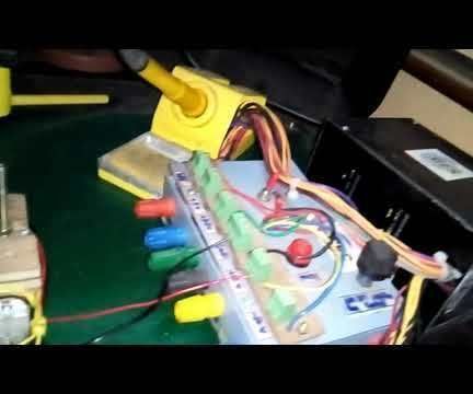

This is a 8051 MCU based SBC with monitor program (PAULMON 2) which is used to develop 8051 based projects quicker and easier.
I have implemented the PCB according to the schematic.
In this circuit 32kB SRAM is connected to DATA and ADDRESS bus of 8051 and is available (CE chip enable) in the address range of 8000h to FFFFh. So reading and writing of DATA and COMMAND is in this range.
