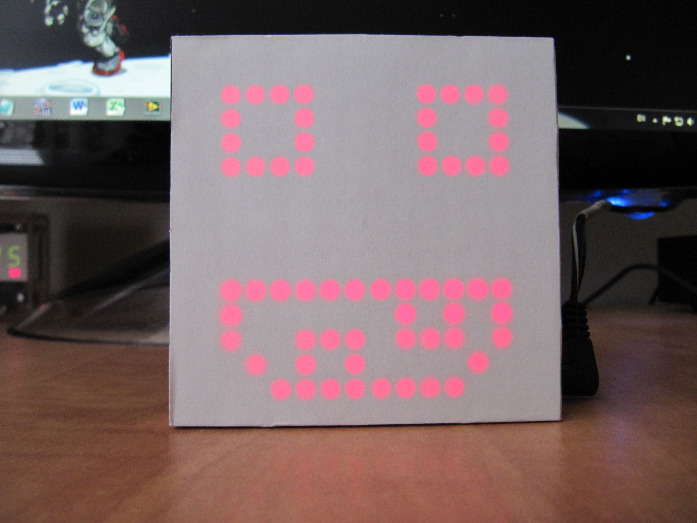

In this instructable I will show you how to build a quite fancy 8 by 10 L.E.D matrix(with scrolling text and animations) using the Arduino and 4017 decade counter. This type of matrix is easy to make and program and it is a good way learn how to multiplex.

In our case we split the image that we want to display to 10 peaces (10 rows), We want to scan the rows of the matrix( light up one row at a time) and send info from the Arduino to the columns.
All the columns are positives of the LEDs and the rows are negatives so if the first row is connected to ground and we send information to the columns we will only light the first row.
To get a good display we need to scan the rows very fast, so fast the the human eye thinks that all of the rows are connected at the same time.

The first one is the one I used and this way takes a lot of time and effort but the end result is very nice and pretty.You need to connect all the positive leads of the LEDs in columns and the negative lead in rows.
Now you do this by taking the positive lead of the first LED and bend it down to the other LEDs, solder the pins which touch each other, from here take the last lead that you soldered and bend it again down and repeat till you have all the positive leads connected in the column. snip the leads that you didn't use.
Now the tricky part is connecting the negative pins in a row because you can't bend them and solder like you did with the positive leads. Now I used little jumpers from solid core wire and connect them like you can see in the picture below( this takes lots of time and work).
The second way is to start the same way as in the first way but the only difference is in connecting the negative pins. This method saves lots of time and is a lot simpler.
The trick is to put some tape or another thing on the columns connections to isolate them from the negative pins and if you do that you can bend the negative leads too and connect them like you did with the positive ones.
