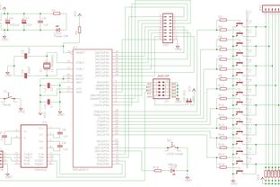

this is a 8*8*8 led cube
Here is what you need to make a LED cube:

Step 1: Making
first make the 4*4*4/5*5*5/6*6*6/3*3*3 led cubes for practice
then try 8*8*8 led cube
Step 2: Circuit
follow the circuit and make the led cube
Step 3: Code
upload this code to ardino and check the working
