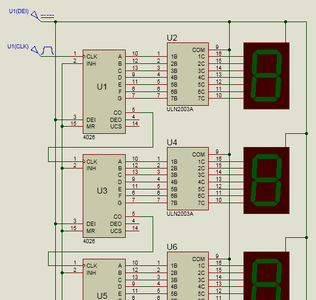

Step 2: Simulating the Circuit
Simulations are generally a good idea to implement when constructing circuits, they help spot bad biasing, incorrect voltage dividers, currents larger than some components can handle, and so on. Even though my circuit is quite simple, I wanted to know for sure that the IC inputs are polarized as intended and I don't end up having to negate the reset, or worse: cut traces on the nice factory PCBs.
The circuit shown on the above image can be continued to infinity, this version would use a single clock input instead of the independent clocking I ended up with. I made one stage and just had to copy a few more, just for the fun of it. The simulation works and I am happy to share it with anyone. The editor didn't allow Proteus simulation files to be added, but I can e-mail it to anyone interested.

After one glance at the schematic one can see that it's not very complicated. The schematic I attached to this step is for one digit only, imagine it multiplied by the number of digits you need. I needed five, which was convenient from the PCB ordering point of view - five pieces is always a minimum anyway, so nothing goes to waste!
The main components of this circuit are the counter IC, the driver, and the display. The rest of the components are just setting current limits, biasing to certain rails, decoupling noise, or level-shifting the Arduino's 5V signals.
The counter IC - CD4026BE
This component turns the clock signal into counts on the display. This IC has the following inputs and outputs (apart from the power pins, which simply go on the 12V rail with decoupling caps) that we need to use:
- DEI - display enable - this can be toggled to enable/disable the display module. It would have been a nice alternative to showing leading zeros on the display, but nothing to worry about if you just bias it to 12V. Maybe it will motivate the tenants to smile more and make the zeros go away.
- CLK - clock input - the counter will increment by one at every rising edge seen on this pin. This pin is brought out on a pin header so the Arduino can connect to it easier. There is a transistor level shifter between the piin and the header!
- RST - reset input: the counter will reset to zero if there is a rising edge on this pin. This pin is also brough out on a pin header to allow the Arduino to reset the counter. There is a transistor level shifter between the piin and the header!
- INH - clock inhibit: this must be pulled low to enable increments on CLK rising edges. I had no special use, so this is just pulled low and allow every pulse on CLK to increment the counter.
The buffer IC - ULN2003A
This component is just an array of Darlington transistors packed into a neat DIP package. It has seven channels, exactly the amount we need for a seven segment display.
The display - SA40-18SRWA
The display has LEDs inside its segments. The number of series LEDs changes depending on the size of the segment. I decided not to allow half smiles so I killed off the DP segment. All other segments have two strings of 4 LEDs each, in parallel. The anodes of all segments are tied together to pins 1 and 8, the cathodes are connected to the rest according to the datasheet drawing. The datasheet specifies a 10V forward voltages on all segments other than the DP, and recommends a current of 20mA as a safe value. Since we have a 12V PSU, we will do the math like this:
RLED = (12V - 10V) / 0.02A = 100R
This is the resistor we will put in series with the segments to set the recommended 20mA running through the LEDs. The current flows from the 12V rail - display anode pins (1 and 8) - internal LED string - cathode pin - 100R resistor - ULN2003A internal transistor CE junction - ground. Whether or not the segment lights up depends only on the state of the ULN2003A transistor. If the transistor is turned on, current can flow through it and the LED segment lights up, if not, the segment turns off.
The counter IC offers decoded outputs, which means that we can route the output directly into the ULN2003A inputs.
