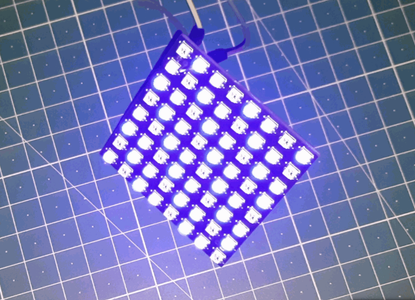

I am very curious to know Quality of SMT assembly service provided by JLCPCB. So, I designed an 8X8 neo pixel matrix with ws2812b-mini led. This is addressable color led, we can control this neo pixel matrix using Arduino.
So, after 10 days I received the JLC package, Let’s see my experience with this SMT Assembly service.

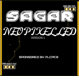

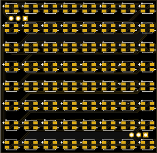

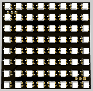

Step 5: PCB Design:

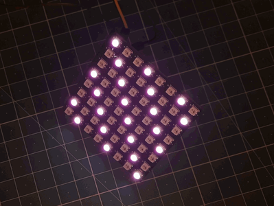

Step 6: Pcb and Components Quality:
Good and proper aligned components, each component is in working condition. All the components (led RGB neo pixel) are soldered in a very good manner. Watch Our video for proper instructions and get PCB Gerber files from description.

8x8 panel draws about 1000mA of power and Arduino’s Ams1117 is capable to handle this much. Here are some examples, test them with your neo pixel panel.
