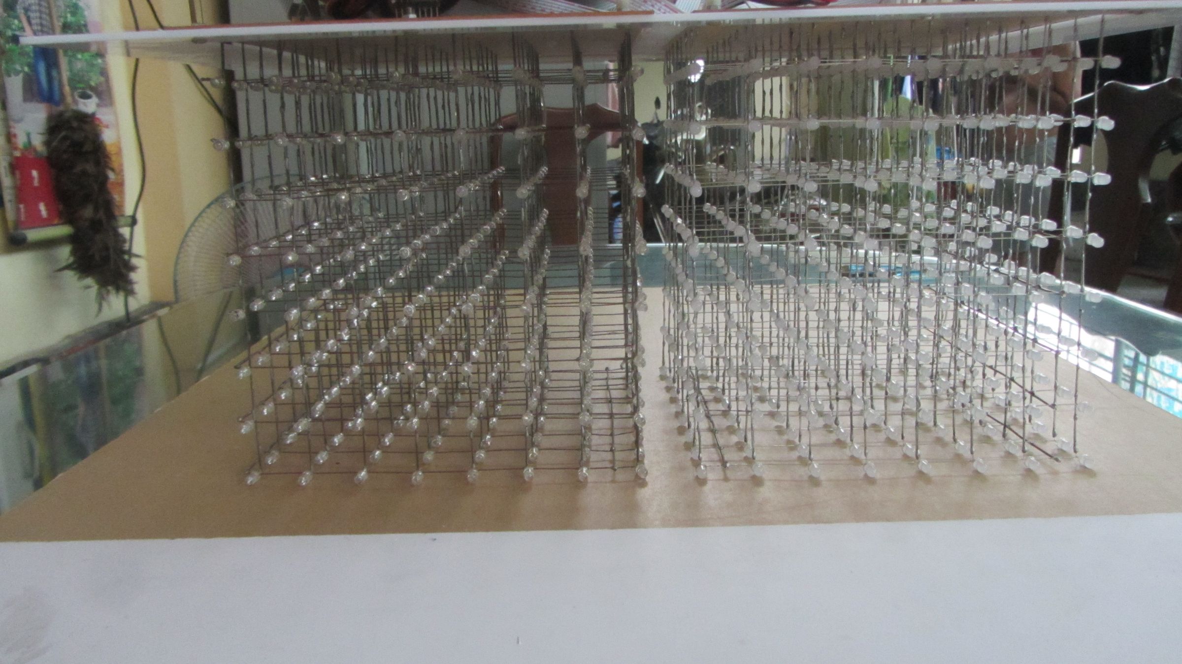

Step 3: LED SOLDERING
This step took the most time and effort. Before and after every single led soldering, I had to check it carefully. Otherwise when these leds were pieced together into cube block, it would cause us lot of troubles if there were some broken leds in the middle of led cube.

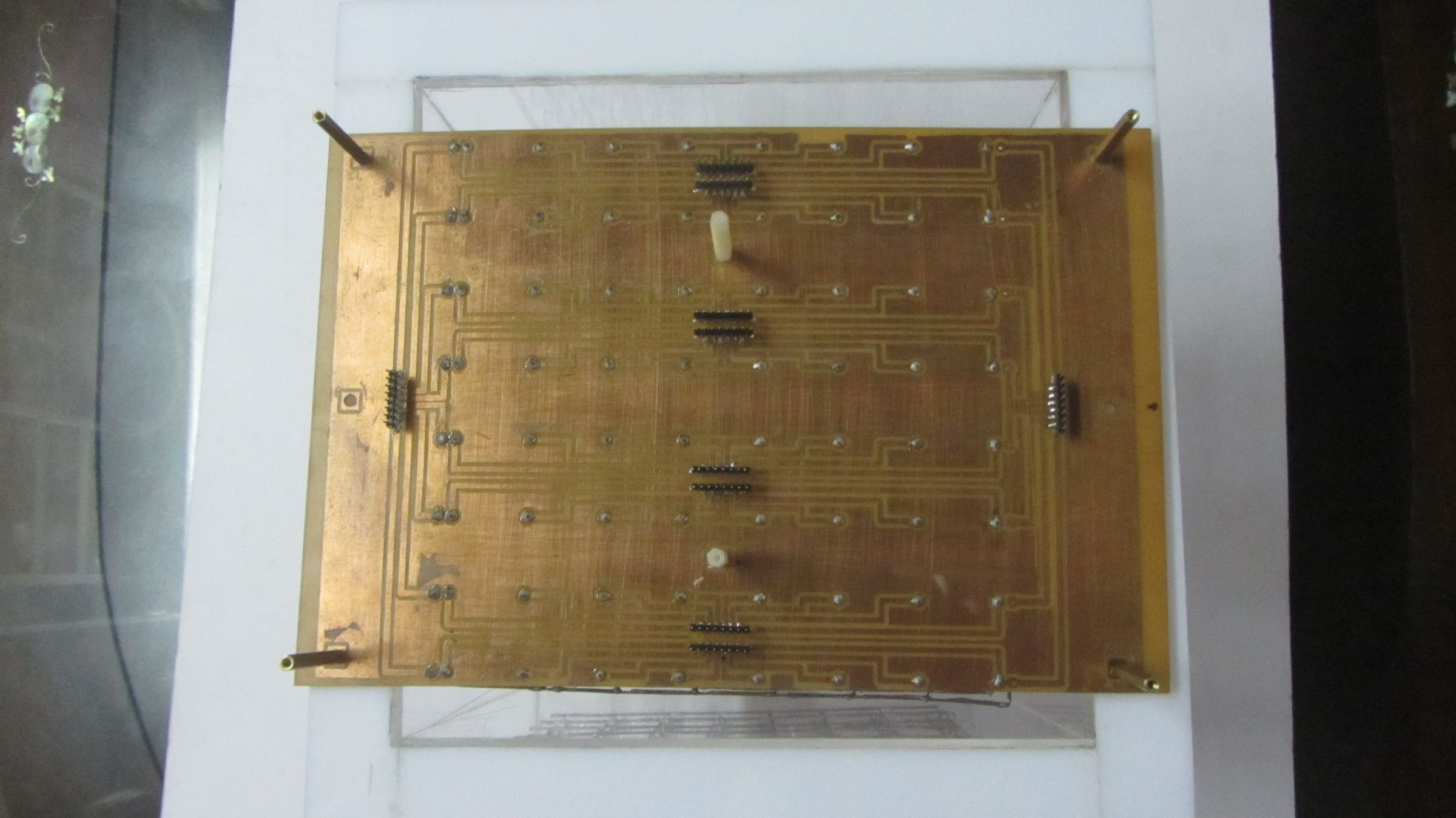

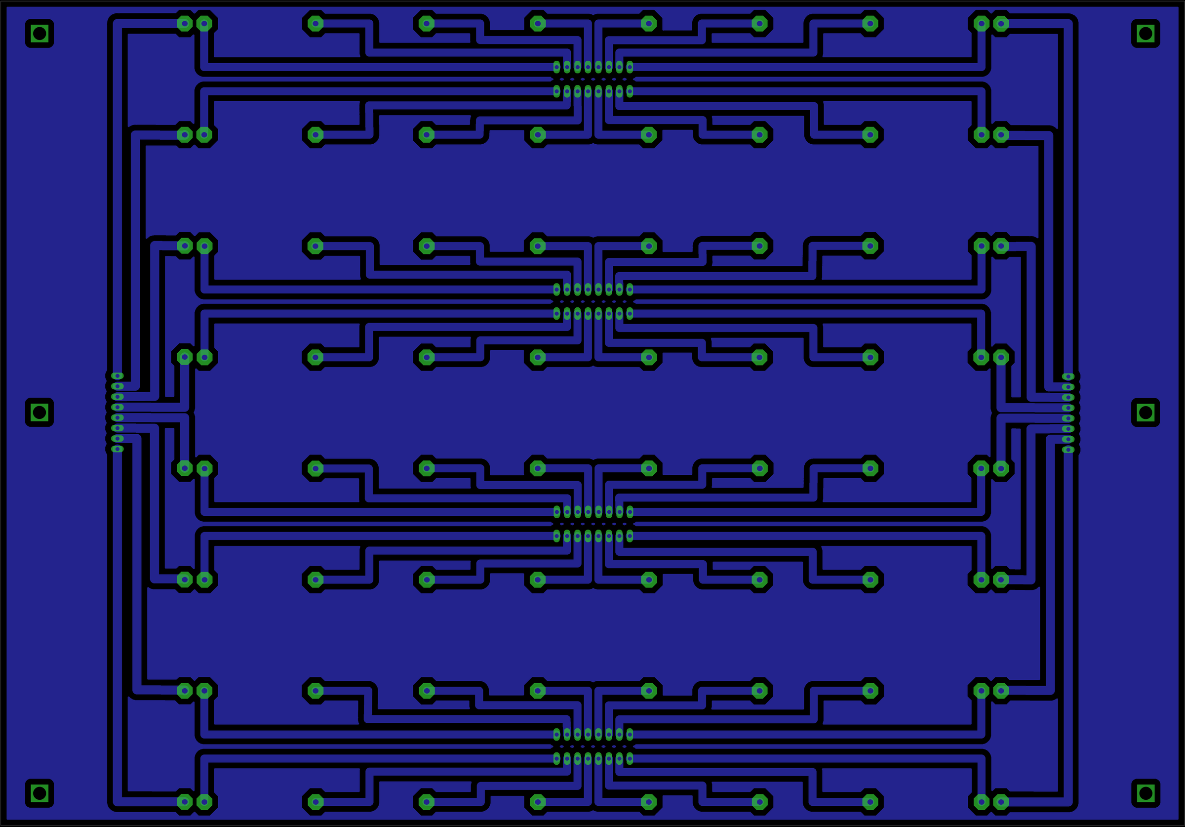

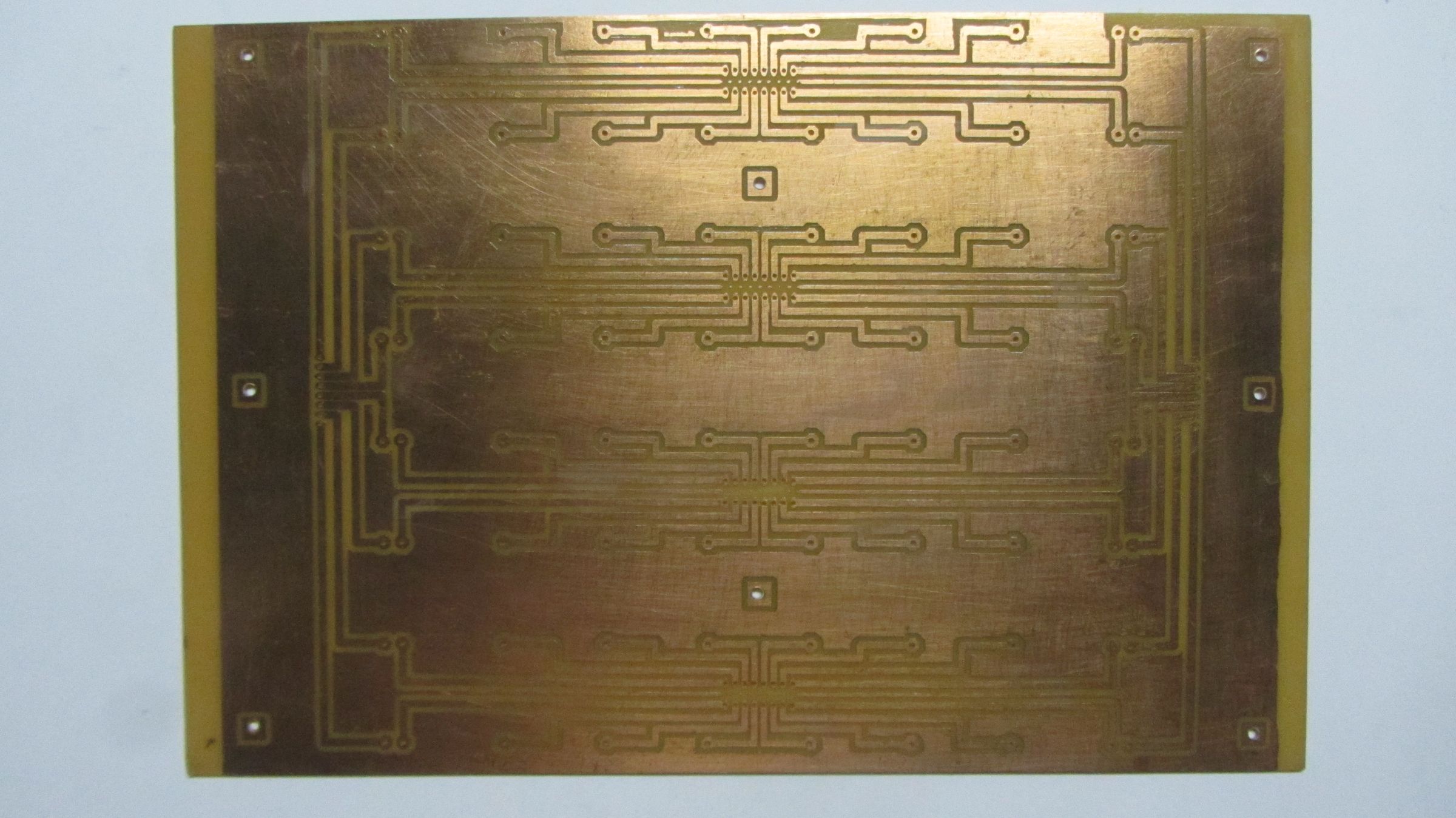

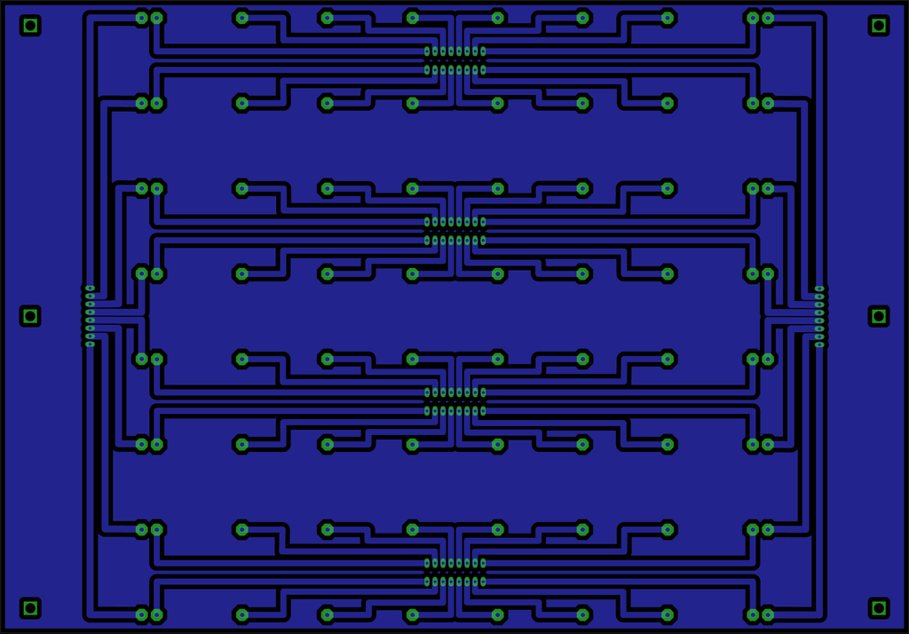

Step 4: CUBE BASE BOARD
For cube base PCB and wooden cube template, distance between leds is the same together. After soldering 64 leds on wooden cube template, we can place them exactly on print circuit board of cube base.
PCB Eagle design & pictures:
PCB real size download file: CUBE BASE PCB

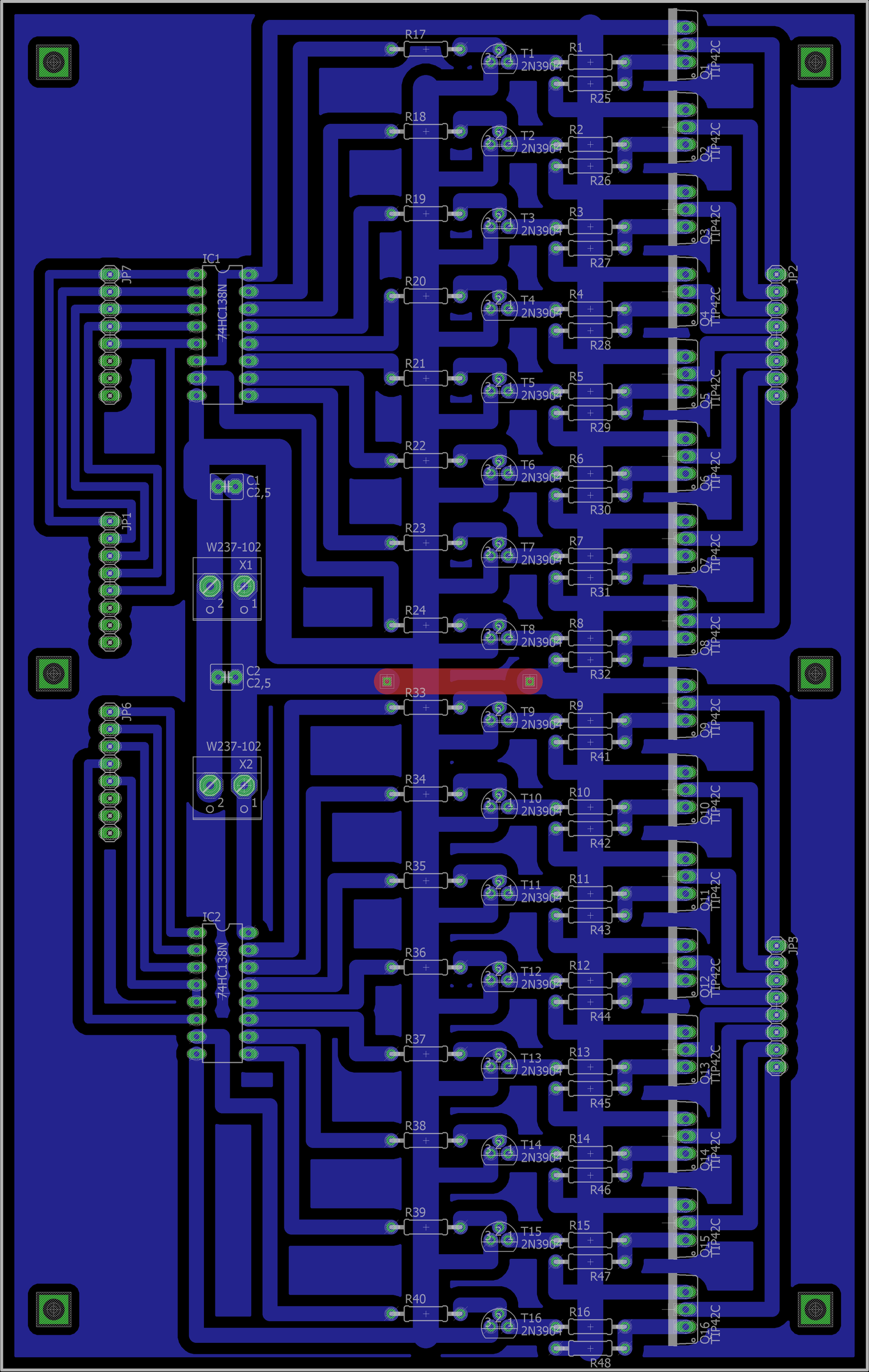

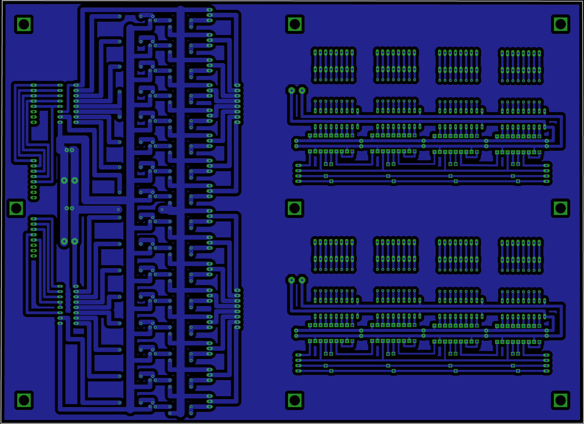

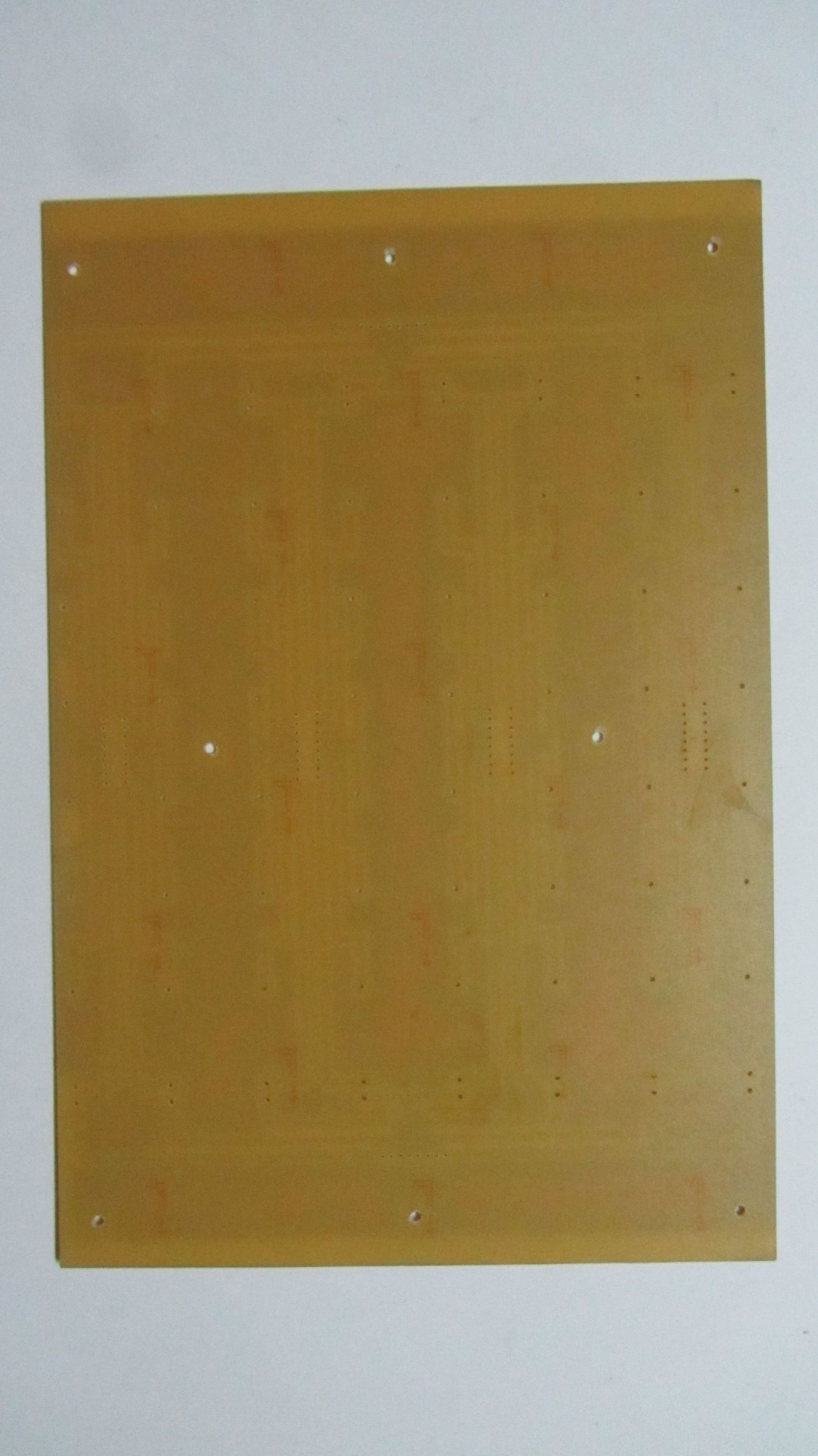

Step 5: LAYER BOARD

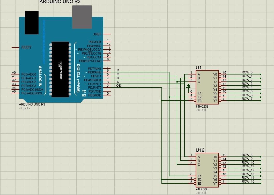

I used 2x74HC238 (with active HIGH outputs) to control 16xNPN - 2N2222 + 16xPNP - TIP42C Transistors. You can download real size PCB picture above.
PCB layer board
PCB real size download file: LAYER BOARD

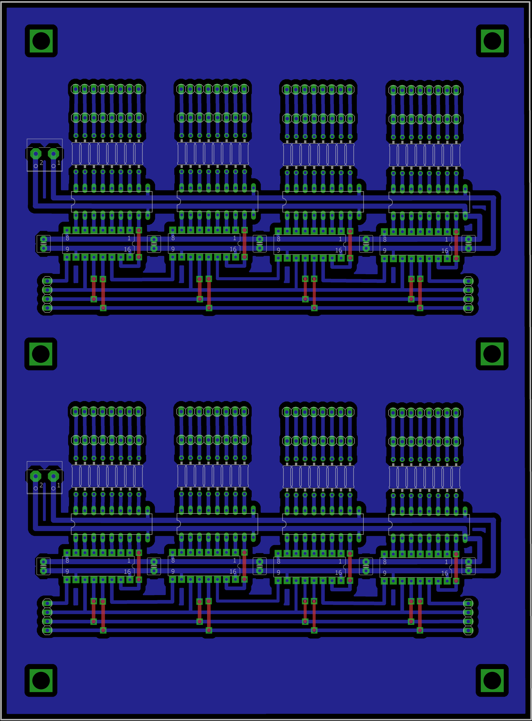

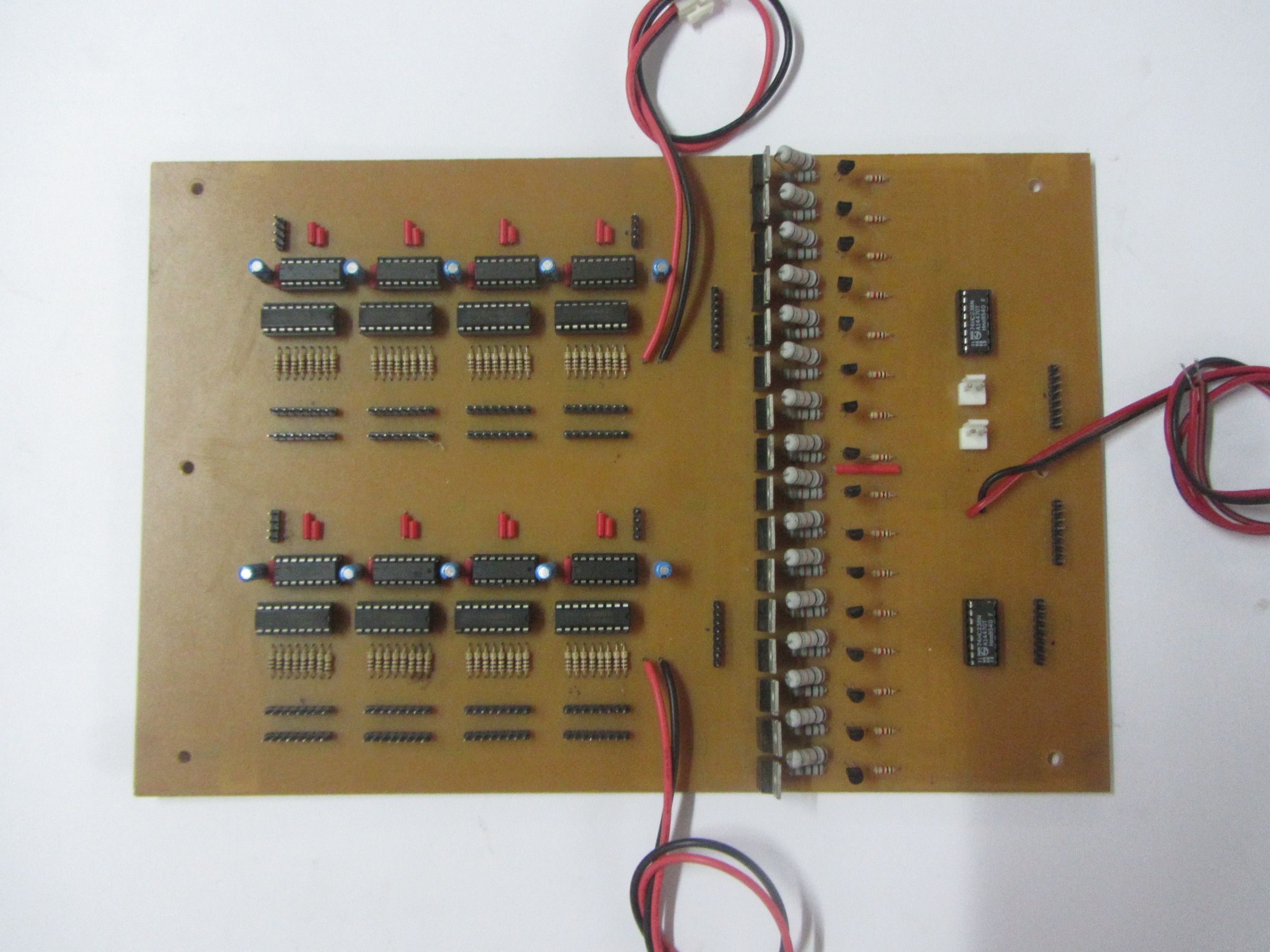

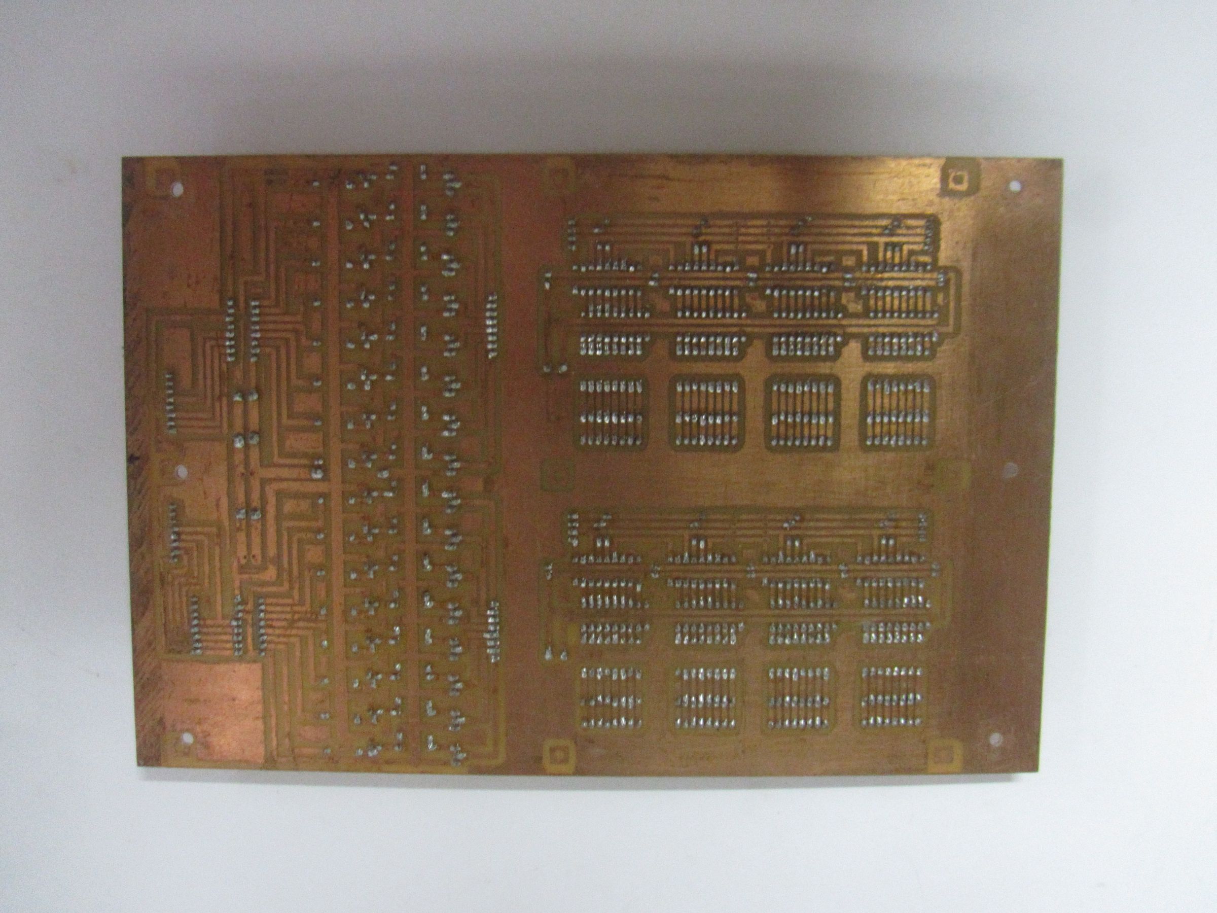

Step 6: SHIFT REGISTER BOARD
Shift Register Board include 8x74HC595, 8xULN2803, 64xR100, 10x0.1uF decoupling capacitors.
PCB file: SHIFT REGISTER BOARD

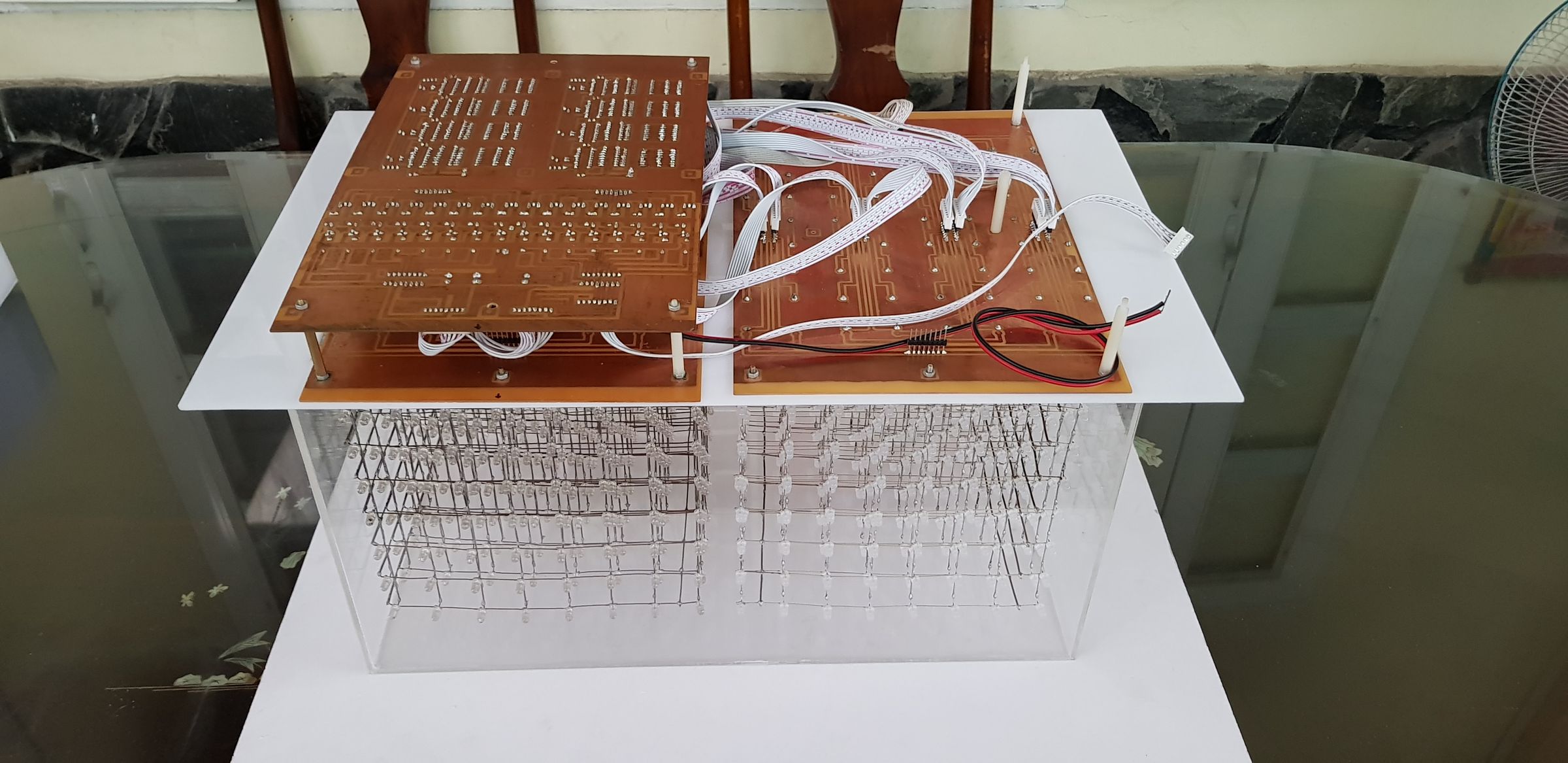

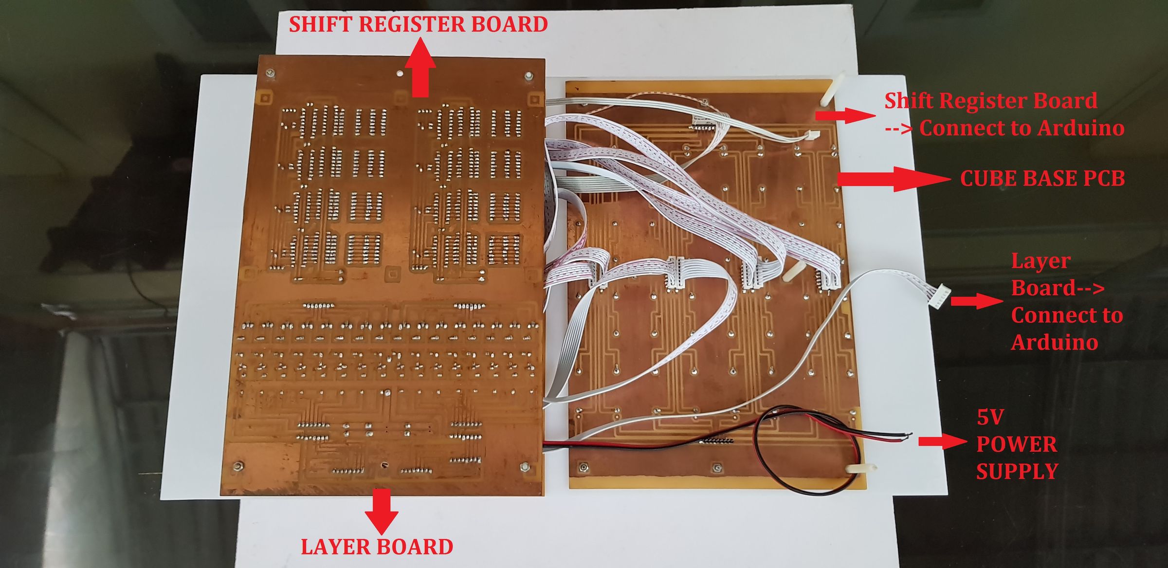

Finally, I joined Layer Board & Shift Register Board into one cooper glad A4 size. It's really well-fitting in A4 size.
Step 7: CUBE ASSEMBLY

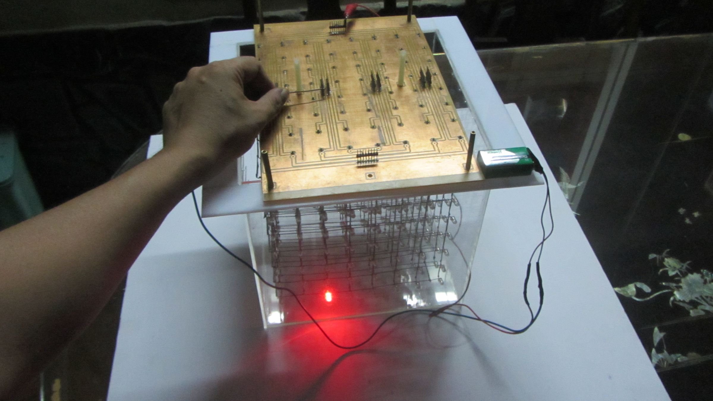

- Soldering LEDs to 1st cube base PCB:
- Testing every single LED:
- Soldering LEDs to 2nd cube base PCB & testing:
- Installing Shift Register Board & Layer Board:

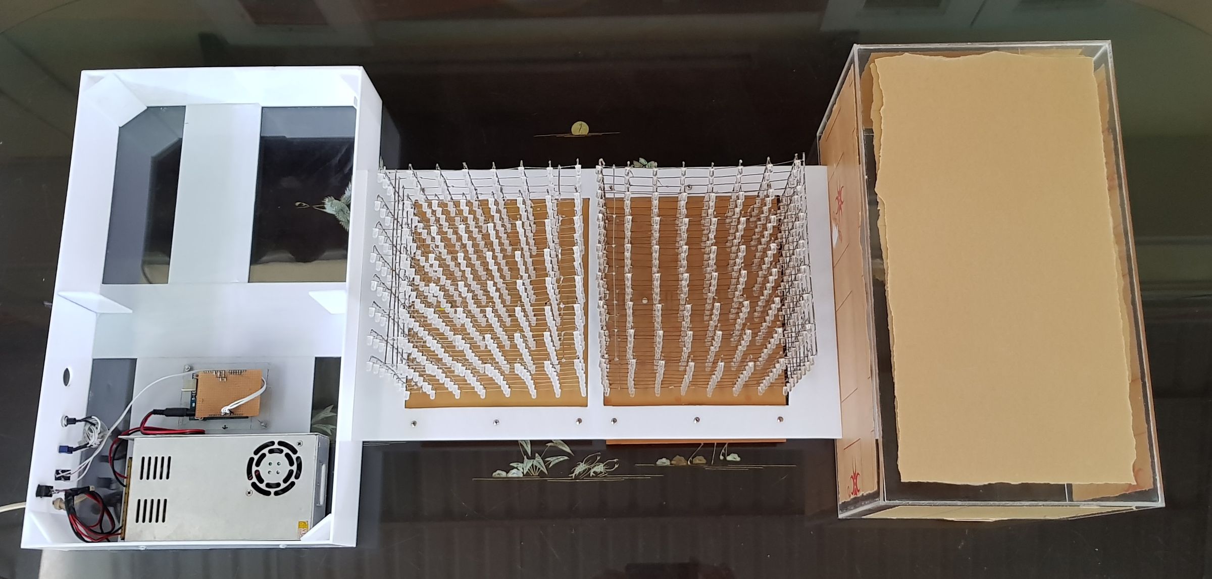

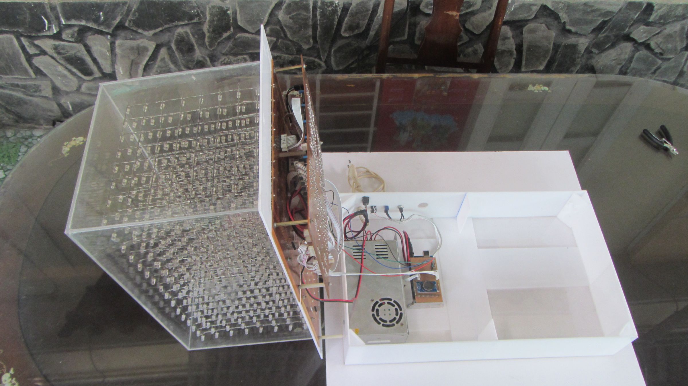

Step 8: CUBE BOX
- Preparation

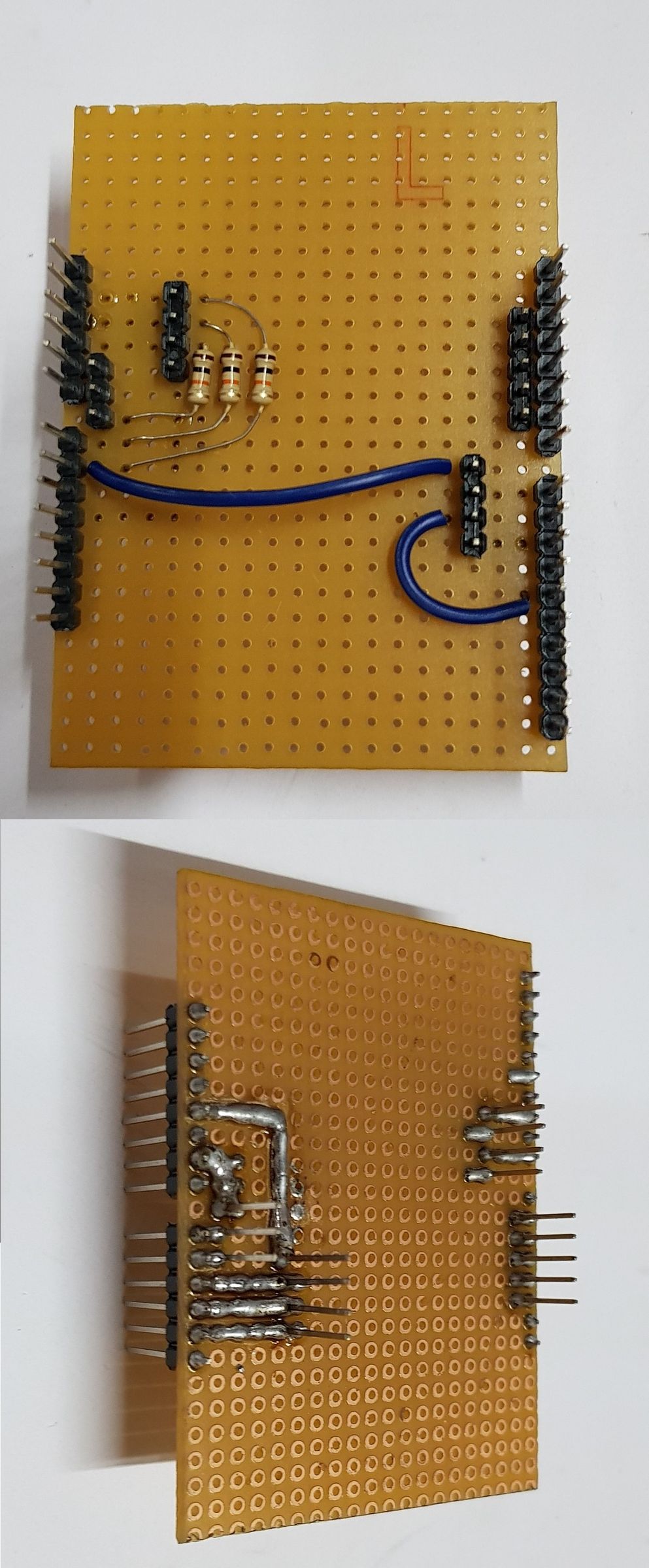

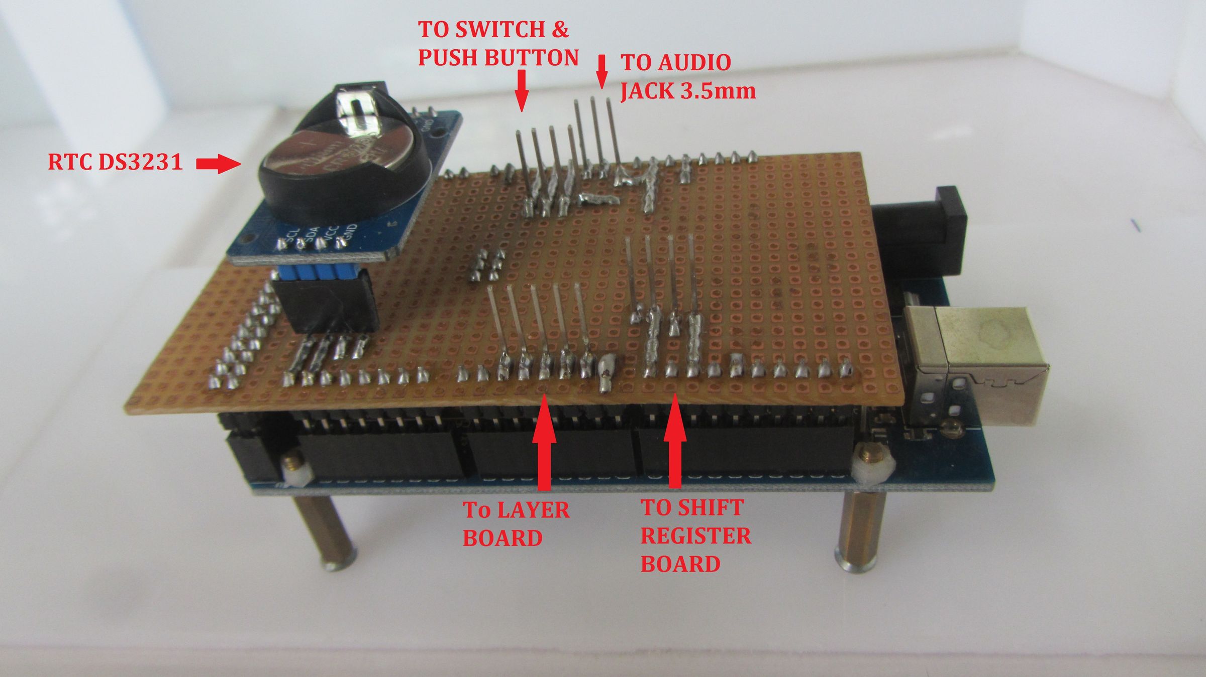

I made one small adapter board for connecting between Arduino and PCB boards.
*** For Arduino Uno version: This version only included animations & spectrum analyzer functions with female audio jack, 3 way toggle switch & push button.
*** For Arduino Mega 2560 version: This update version included one more function "handwritten clock" so I added RTC DS3231 as picture

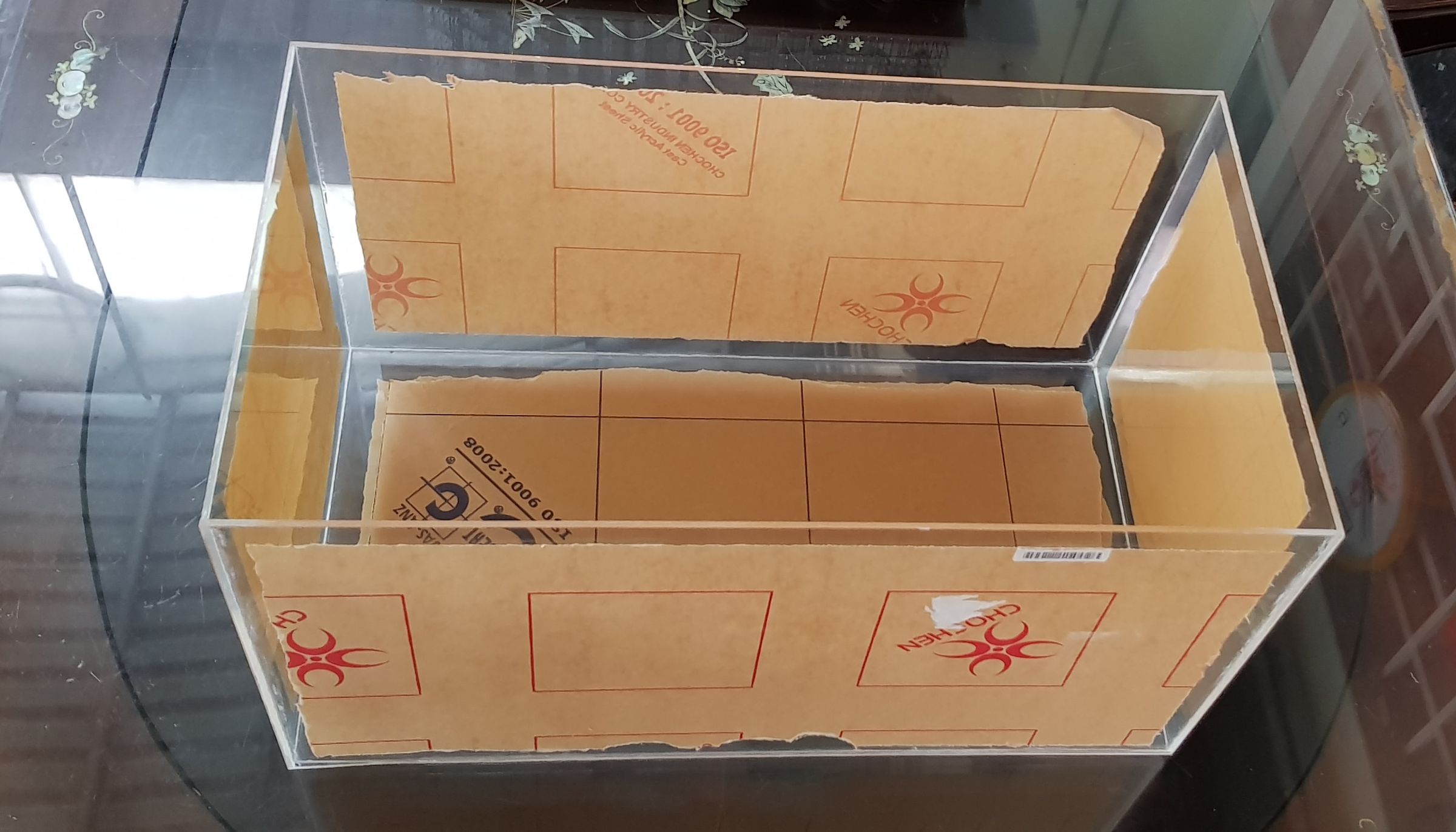

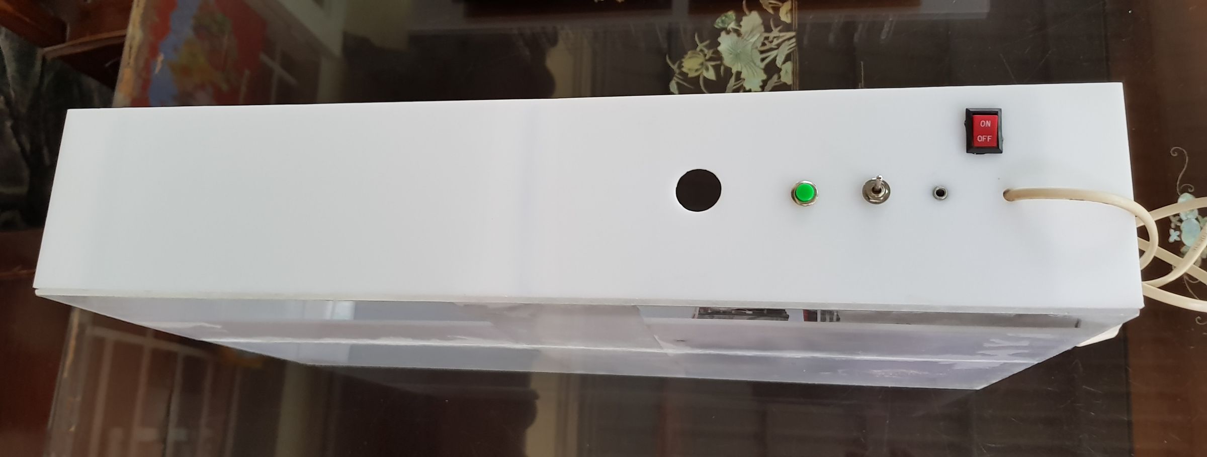

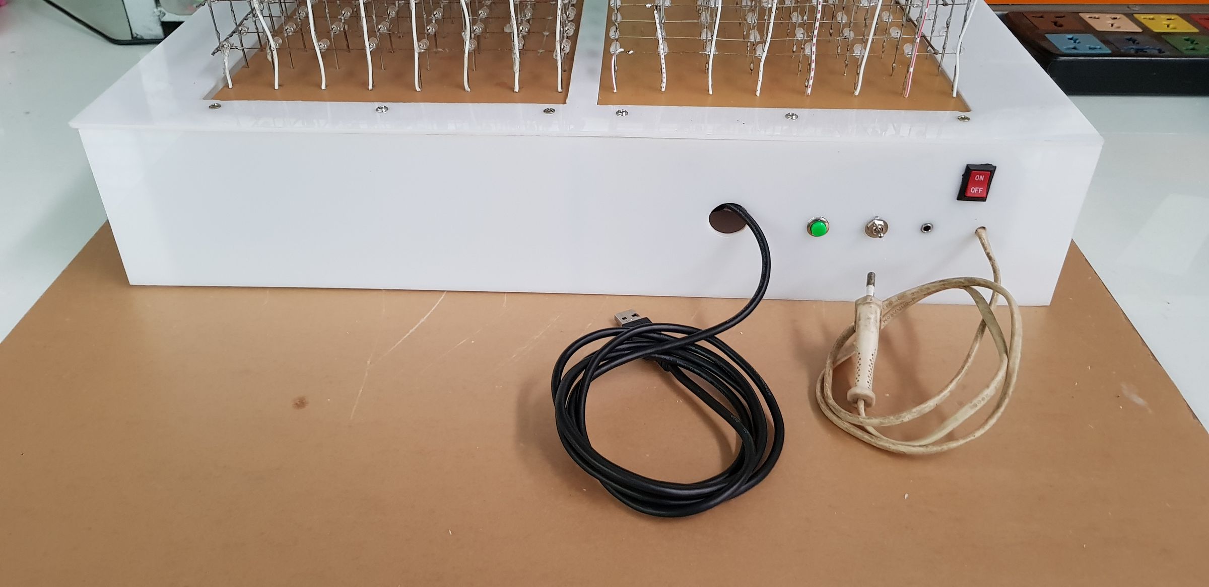

- Bottom box
Making a bottom cube box to contain: Power Supply, Arduino Uno/ Mega, Shift Register Board, Layer Board. At back side of cube box, I mounted power switch, push button, 3 ways toggle switches & female stereo audio jack.
- Top box
- Connecting all together

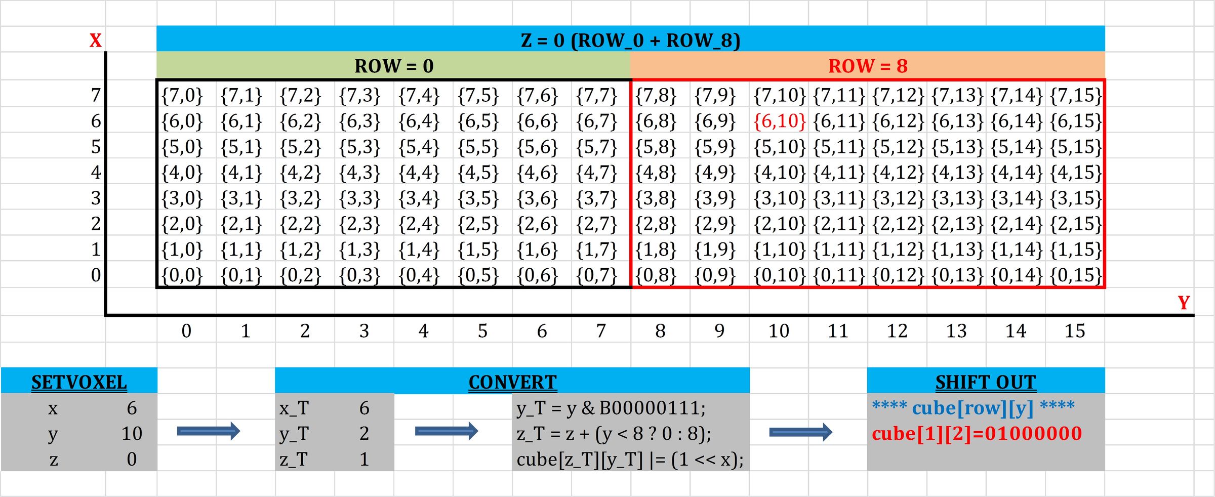

Step 9: PROGRAME
Led cube size is defined:
- X = 8
- Y = 16
- Z = 8
We have total of 8 layers for this cube. With my hardware, we have to convert 16 rows to 8 layers as follow:
- Z0 = Layer 0 = Row 0 + Row 8
- Z1 = Layer 1 = Row 1 + Row 9
- Z2 = Layer 2 = Row 2 + Row 10
- Z3 = Layer 3 = Row 3 + Row 11
- Z4 = Layer 4 = Row 4 + Row 12
- Z5 = Layer 5 = Row 5 + Row 13
- Z6 = Layer 6 = Row 6 + Row 14
- Z7 = Layer 7 = Row 7 + Row 15
See picture below:
For Y axis, we also do some modification in program to get correct coordinates:
For detail, let see example above for command setvoxel(6, 10, 0).

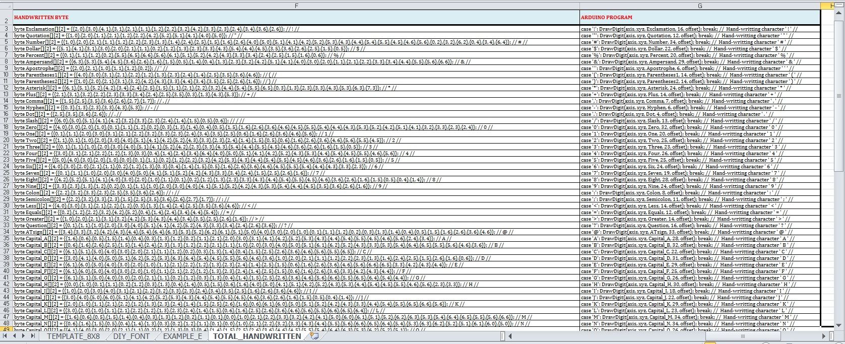

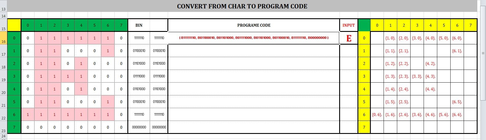

Step 10: HANDWRITTEN TEMPLATE

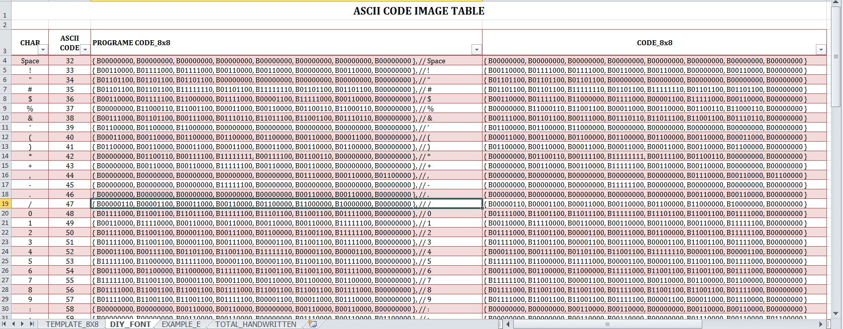

Creating ASCII code in handwriting is a time-consuming work. Luckily, Microsoft Excel can help me do this job very well, not only create fonts but also create programming codes for Arduino. You can download my excel template file at link: Excel Handwrtten Template
This file has a total of 4 sheets:

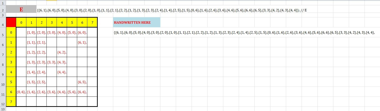

- Sheet "TEMPLATE_8X8": be used to create 8x8 ASCII fonts for leds or look up from this font library after all symbols are created. And then specific symbol is converted to coordinates (x, y). With this sheet, you can make a font or image with size 8x8 for yourself. See image below for capital letters "E".
- Sheet "DIY_FONT": contains the entire ASCII font that was created
- Sheet "EXAMPLE_E": is a typical example of creating handwriting character. Based on coordinates of capital letter "E" in step 1, we will create handwritten letter by allowing which coordinate to be displayed firstly and which coordinates are displayed secondly, thirdly... and endly. I used the “&” (ampersand) operator to combine coordinates from multiple cells in order of showing priority. Result for handwritten capital letter “E” is: {{6, 1},{6, 0},{5, 0},{4, 0},{3, 0},{2, 0},{1, 0},{1, 1},{2, 1},{2, 2},{1, 2},{1, 3},{2, 3},{2, 4},{1, 4},{2, 5},{1, 5},{0, 6},{1, 6},{2, 6},{3, 6},{4, 6},{5, 6},{6, 6},{6, 5},{3, 3},{4, 2},{4, 3},{4, 4}}; // E
