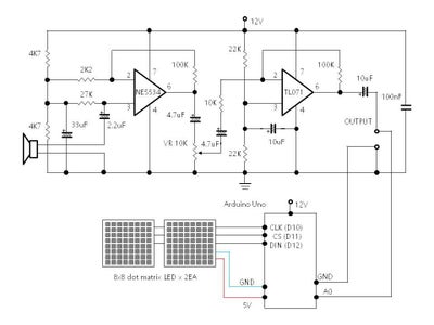

Step 1: Schematics
When you looked at the schematics above, the same old pre-amplifier circuit is reused instead of the Adafruit MAX4466 MIC-Amp breakout board.
The sound voltage captured by electrets MIC fed to pre-amplifier and subsequently connected to analog A0 port of the Arduino Uno board.
As this pre-amplifier requires 12V input voltage, the same voltage of the power supply is connected to the Arduino Uno board.
The Arduino Uno board has a circular-shaped power socket (Usually it is connected with a 9V~12V wall socket adapter) and output power from LM7812 is directly connected to this socket.
When you buy two units of hardwired 8x8 dot matrix display, you don’t need to solder anything.
But as bought two separate 8x8 dot matrix displays, I need to connect 5 lines (Vcc, GND, DIN, CS, CLK) of matrix modules.
Overall hardware wiring for this circuit is relatively easier than others as only 5 lines are connected between the dot matrix display and Arduino.
But controlling the two 8x8 dot matrices is not easy and entirely dependent on the sketch program that will be explained in other steps below.

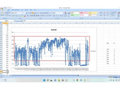

Step 3: Digital Processing of Audio Signal
As the audio sound capturing device is changed (such as from MAX4466 MIC Amp to an old op-amp-based pre-amplifier), the sound level pattern also changed.
But similar to the MAX4466, input audio signal voltage levels are about 30mV to 3.8V range.
Initially, I tried to figure out the signal range by viewing printed data on a 16x2 character LCD module.
But later I added an SD card reader to Arduino Uno to get the detailed data for 20 minutes length of various YouTube videos.
Firstly I started to capture sound data from common news broadcasting videos.
Subsequently, very noisy hip-hop music video and later capturing sound data level of documentary video.
When you look at the picture above, the sound levels (300~400) suddenly peak up from the middle part of the graph.
That part of the data was captured from the hip-hop music video.
The data included in the red box are showing the dynamic and active sound levels. (From 100 to 400)
As the active sound input range is about 300, this value is divided by 8 (LED display levels of 8x8 dot matrix).
Then the following sound level base and gaps between levels are defined.
All LEDs are off when level < 100
Turn on 1 LED among 8 LEDs (1 column of 8x8 matrix) when level > 100 and level < 137
Turn on 1 and 2 LEDs among 8 LEDs when level > 137 and level < 174
Turn on 1, 2 and 3 LEDs among 8 LEDs when level > 174 and level < 211
Turn all LEDs when level > 359
For each 37 (0.037V) audio input level, one more LEDs are turned on to show the present sound strength level.
When the recording volume of a certain YouTube video is very high (such as more than 300), the 10K potentiometer included in the pre-amplifier can adjust the amplification ratio to get a reduced (200~300) level of audio signal voltage.
This method is more simple and more intuitive than using a complex control mechanism with two potentiometers (setting base and gap values) in the previous SLM project.

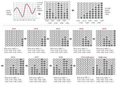

Step 4: The Sketch Program
As explained in the step right before, the audio signal voltage is recalculated (ex: level = volts * 100) to produce a sound level value.
Subsequently, the calculated sound level mapped to the number of LEDs to be turned on.
For an 8x8 dot matrix display, an internal controller chip (MAX7219) decodes how many LEDs are turned on like below.
// bar pattern
byte bit0 = 0x00; // All LED turn off
byte bit1 = 0x80; // LED 1 turned on within column (8 LEDs in the one column)
byte bit2 = 0xC0; // LED 1, 2 ON
byte bit3 = 0xE0; // LED 1, 2, 3 ON
byte bit4 = 0xF0; // LED 1, 2, 3, 4 ON
byte bit5 = 0xF8; // LED 1, 2, 3, 4, 5 ON
byte bit6 = 0xFC; // LED 1, 2, 3, 4, 5, 6 ON
byte bit7 = 0xFE; // LED 1, 2, 3, 4, 5, 6, 7 ON
byte bit8 = 0xFF; // LED 1, 2, 3, 4, 5, 6, 7, 8 ON
As shown on the top right side of the picture above, each LED pattern and its hexadecimal code is depicted.
According to the calculated sound level values (multiples of 37), LED pattern values are calculated from t1 to t8 times like below.

Among two 8x8 dot matrices, eight LED pattern data (byte) are stored in the left byte array while another 8 LED pattern data are stored in the right byte array.
As shown in the picture above, the first sound level data is entered and stored in the right byte array like below at t1 time.
Byte array right = (
0x00, 0x00, 0x00, 0x00,
0x00, 0x00, 0x00, 0xF0 }
When second sound level data is entered at t2, shifting (to left) all data in the right byte array to enter new data like below.
0x00, 0x00, 0xF0, 0xF8 }
Likewise, each data in left and right byte arrays are shifting when new data is entered from t1 to t8 as shown in the picture above.
At each time slot from t1 and t2, the 8x8 dot matrix display is updated with the following “LedControl” library codes.
int i = 0;
for(i=0;i<8;i++) {
     lc.setRow(dev,i,character[i]);
According to the LED pattern hexadecimal codes stored in the left and right byte array, the “LedControl” library setRow command turn on one column of the 8x8 LED matrix.
Until now I keep saying column of 8x8 matrix, but actually, the command mentioned above is a row!
It seems like a mistake in the code above.
But many Chinese 8x8 dot matrix manufacturers are usually making the device (wiring internally) as 90 degrees rotated clockwise.
Therefore, if you want to display a column then you should use setRow command.
Then it makes the same result of rotating display as 90 degrees clockwise! (I know this explanation will make it confusing. But it’s true!)
In a conclusion, before displaying the LED pattern on the 8x8 matrix, you can shift sound level hexadecimal data and insert newly captured values to the left and right byte arrays.
Actual LED pattern showing happen after changing data.
This way you can show continuously shifting LED patterns on the two cascaded 8x8 dot matrix displays.
