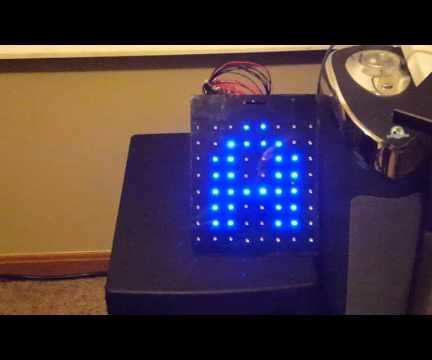

Building the LED Array In the picture, you can see that the first thing I did was run a 20 gauge bare copper wire through the outside holes where it lays nice and flat across the tops of the jig. This also give you extra wire on each side to work with, say if you were building a cube. Next, take all of the positive anodes and bend them at a 90 degree angle and inserted the LED into the jig’s holes, and have the anode lay across the bare wire. Now, you have a nice solid surface to be able to solder all of the LEDs to the copper wire. The next two pictures show the item in the jig soldered, and then removed from the jig. There you have it, the first “row” of your matrix is done! By using the jig, you know that each of your LEDs are exactly 1 inch apart. The 20 gauge bare wire is perfect to work with in this application, as it has the stiffness to allow you to bend and shape it however you wish without breaking. So, now do another 7 sets of these to finish up your 8 rows. I’ll wait.
Step 3: Assembling the LED Rows
Awesome! You now have 8 rows of LEDs that are not connected together! Now, for some bad news….I did not take a picture of the next step…so, we will need to have to use a little imagination...
Take your plexiglass sheet and measure out your 64 holes in your 8x8 pattern, one inch from each other from the center of each hole…again, make the hole only 5mm to fit the LED in, but not large enough for the LED to slide all the way through it. DO NOT REMOVE THE PLEXIGLASS COVERING! Again, I’ll wait…
Now, with all 64 of the holes drilled, take each of your rows of LEDs and place them into the plexiglass. This will now hold all of your rows in place, so now you need to solder all of the cathodes together in columns so you have all of the LEDs in a row soldered by anode and all of the LEDs in a column soldered by cathode.
This is the reason you did not remove the cover from your plexiglass, as that covering would protect the plexiglass from any splattering or popping of solder that may happen. Now, once you have all 64 together, you can remove the matrix, then remove the plexiglass cover, and replace the matrix.
Ok, so I am really, really hoping you have something that looks similar to what I have above. Now, the fun part is, more testing! Yep, that is the REAL reason I have those alligator clips! So, once again, fire up your favorite 3V power source, add the alligator clips and start testing. The rows, as you remember (I hope so) are the anodes, so clip the positive onto the row, and then on by one, touch the negative to the cathodes that are running across the bottom. You should see the corresponding LED turn on for each place you touch the negative on the row that the positive is connected. In the picture above, the positive is connected to the fourth row from the bottom, and the negative is on the fourth column from the left. The two connected = light! We are on the way now. Repeat 63 more times.

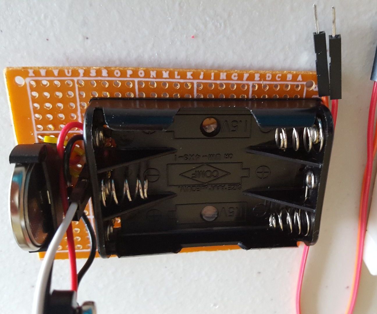

Now, the matrix is fully formed, we just need to make it usable for connecting to something. So for that we are going to break out the prototype board and build the following.
First the two rows of screw-down connectors (Green things on both sides) are used to connect the wires from the matrix to the board. I then connect each of those connectors to a set of female connectors. These female connectors is what you will use to connect to your Arduino, Raspberry, or any other circuit.
Notice that I added some resistors to mine…that’s because I really didn’t want to try to replace any LEDs if they got fried. It may be a good thing for you to add as well, unless you are a brave person and like to live dangerously!
After the board is created, I just simply used some cable ties to attach it to the LED matrix, and voila, you are ready to go!
