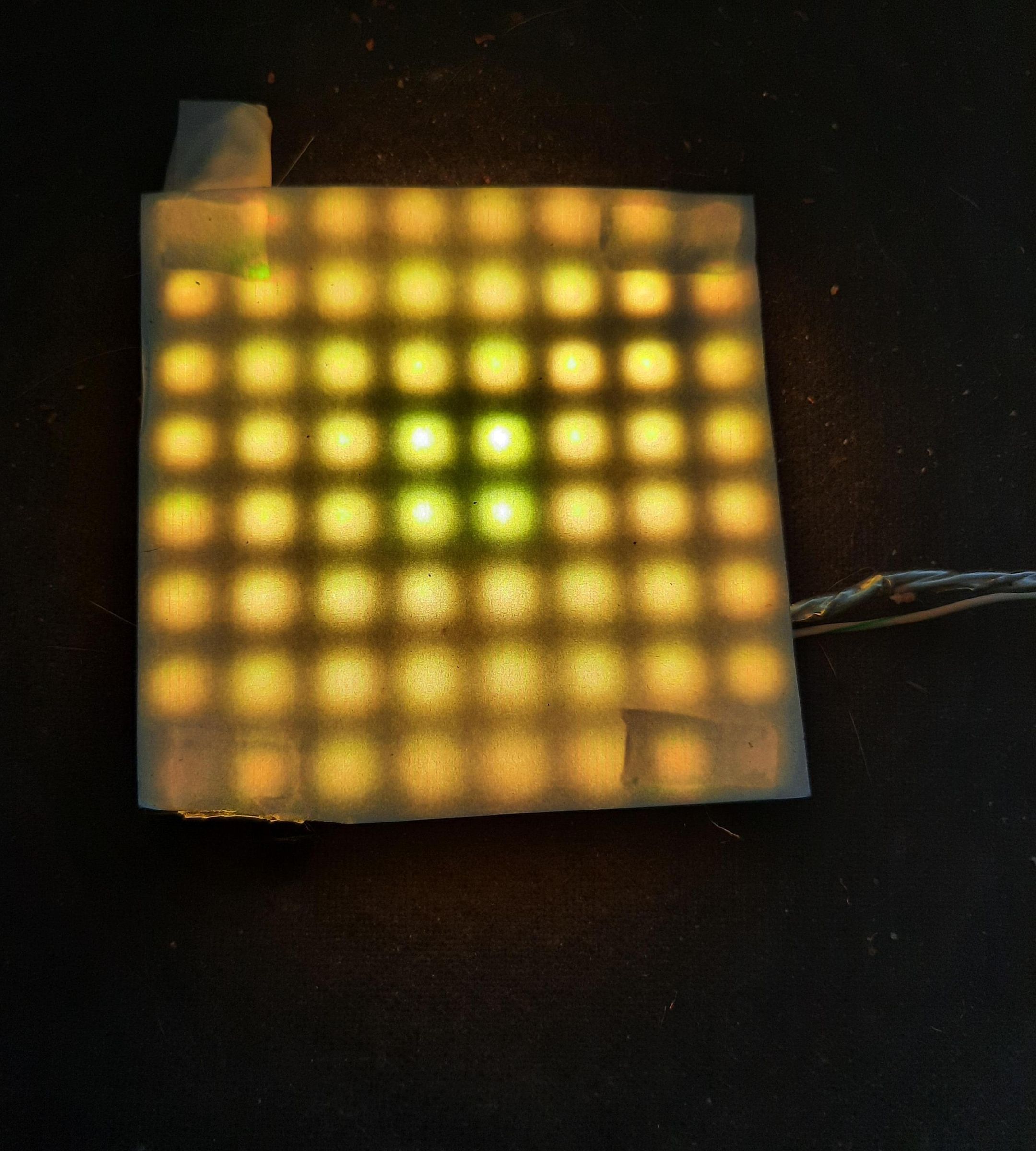

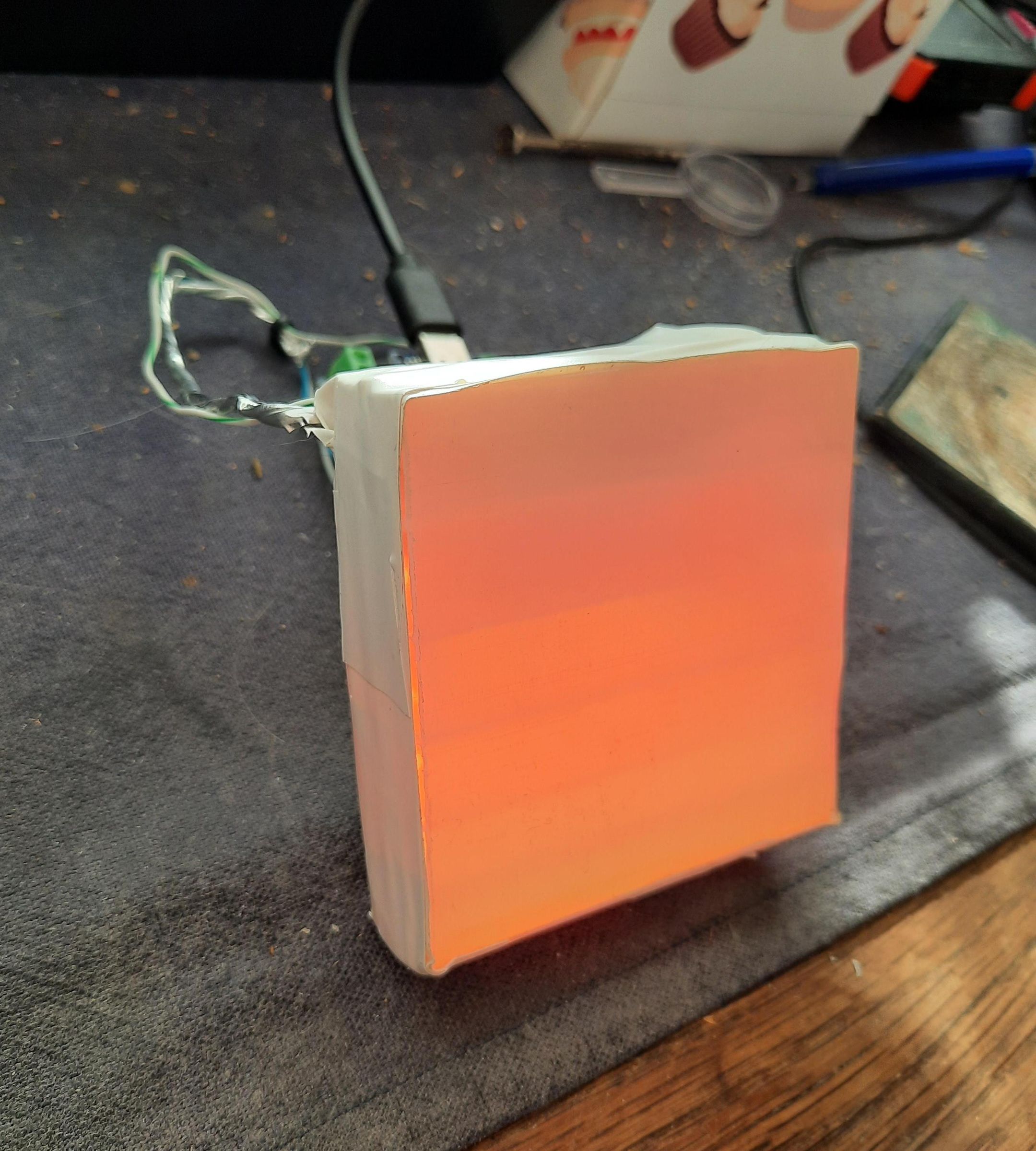

Step 1: Info
Colourful soft Starry Sky Effect for 8x8 matrix.
Code is in void and void is called in loop.
Connection Resistor to Matrix on PIN 5.
