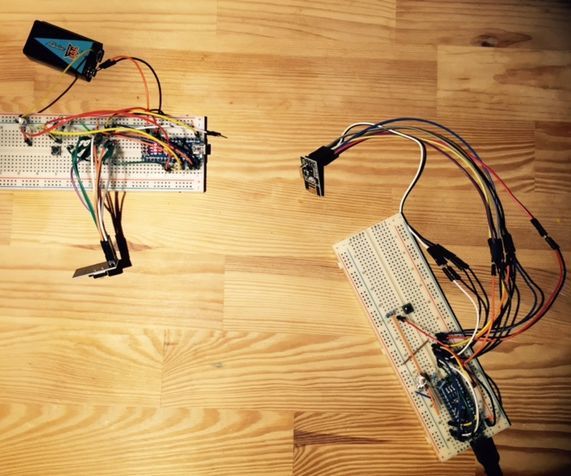

Introduction: LED Matrix - Game of Life
This project will execute Conway's game of life on a 8x8 LED matrix.
It has 2 buttons, one for setting up a random field, the other to start or stop the iterations.
Step 1: Materials
- An 8x8 LED matrix
- 2x aprox. 1kOhm resistances
- 2x buttons
- cables
- Arduino Mega 2560 (or similar)
- Breadboard might be helpfull
Step 2: Connecting
Step 3: Code
