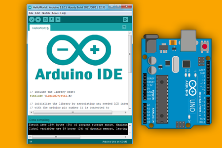

Step 9: Programming
For programming I used the original Arduino IDE which is not the easiest programming language because it is used C++ and you need to know how to use the programming with C++.
