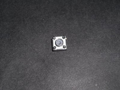

Microswitch
Small light bulb (or Christmas tree light)

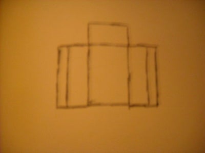

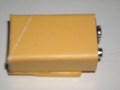

Pretty simple step. Trace around 4 sides of the 9 Volt and add an extra quarter of an inch around the skinny sides to attach this to the main light. This will be your battery holder.

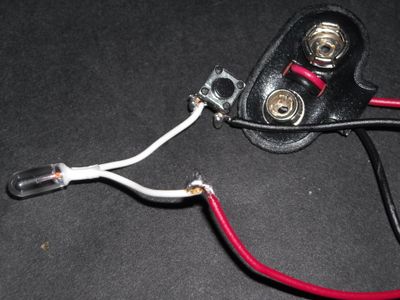

Step 2: Soldering

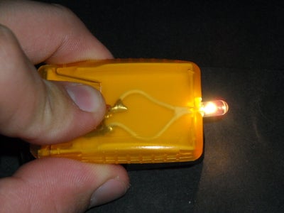

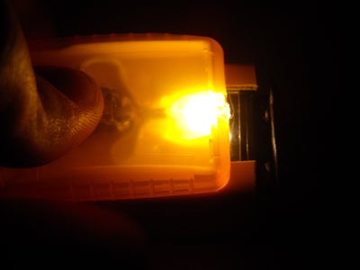

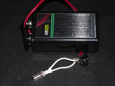

Take your light, microswitch, and 9 Volt adapter and solder them in this fashion. Once everything is soldered, test it before placing it in the light holder.

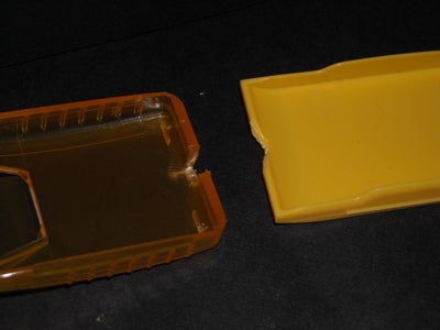

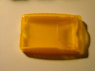

Step 3: Cutting the Pocket Packs Box

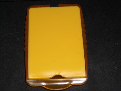

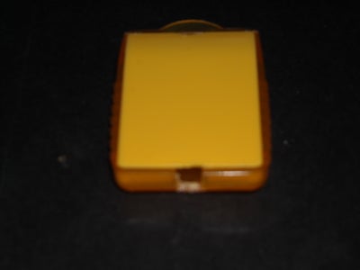

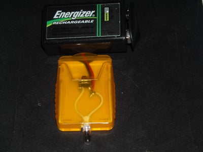

Cut a hole in the side opposite to the opening for the light.. Then cut a smaller hole in the other side for the cords to go through. After that, glue the solid yellow part to the battery holder.
Step 4: Gluing the Battery in Place.
Attach the battery to the light and place the light in the holder. Test where you want your switch to be and glue in place. Careful not to glue the switch so that you cant press it down, be light with the glue there.
