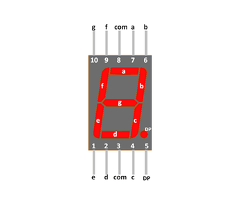

Step 4: Wiring the 7 Segment Display
A 7 Segment Display has 10 pins in total with 5 on top and 5 on the bottom. The middle pins in both groups will be given power with a 560 ohm resistor. Using the photo labelling the 7 Segment Display, connect the letters to the corresponding pins on the Arduino: a to pin 2, b to pin 3, c to pin 4, d to pin 5, e to pin 6, f to pin 7, g to pin 8.
