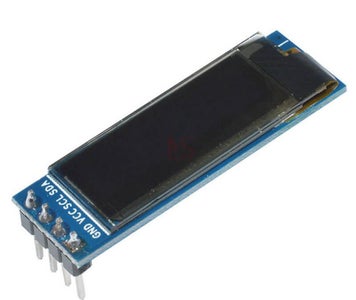

  2. 1X OLED 0.91 inch

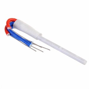

  3. 1X A1321 Heating element

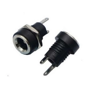

  4. 1X DC jack 2.1X5.5mm 2 pins

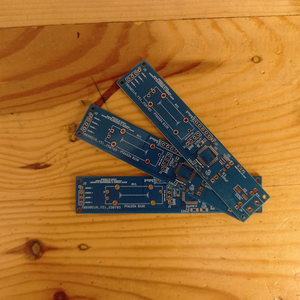

Step 1: PCB Design
this is my first design experiment with KiCad software. Printed with JLCPCB service.
Gerbers, schematic, firmware, etc: Google Drive

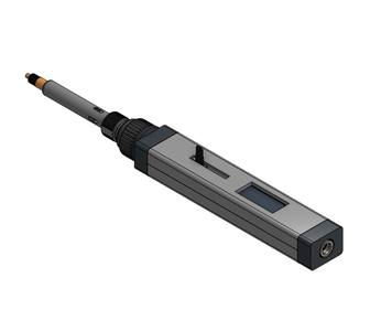

Step 2: Enclosure Design
i'm using PLA+ for the main body (grey) and ABS for the lock (black). kinda hard to assemble beacause ABS shrink more than PLA+, but i don't want the PLA to melt because the heat. so i add some fiberglass insulation tube to reduce the melting risk.
3D case: Google drive, GrabCAD

Upload the progam to an arduino nano, then transplants the Atmega328P MCU to the custom PCB. the MCU is located under the OLED 0.91. So, don't put it upside down when soldering it.

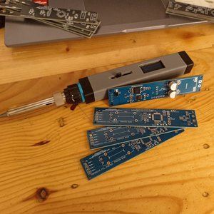

Step 5: Soldering Results
Quite good for manual soldering. even though i have a hot air station, my solder paste kinda low quality and i didn't order the stencil to reduce the cost.
Step 6: Assembly
No need screws or bolts. easy to dissamble, just slide out the two caps one both sides.
Step 7: Final Results
I'm very happy with this project. I don't need to carry a thick and bulky soldering iron. This soldering iron fits in palm of my hand. The only issue is the large power adapter. Perhaps this can be fixed by modifying it to fit a USB-C PD and a 65W adapter.
