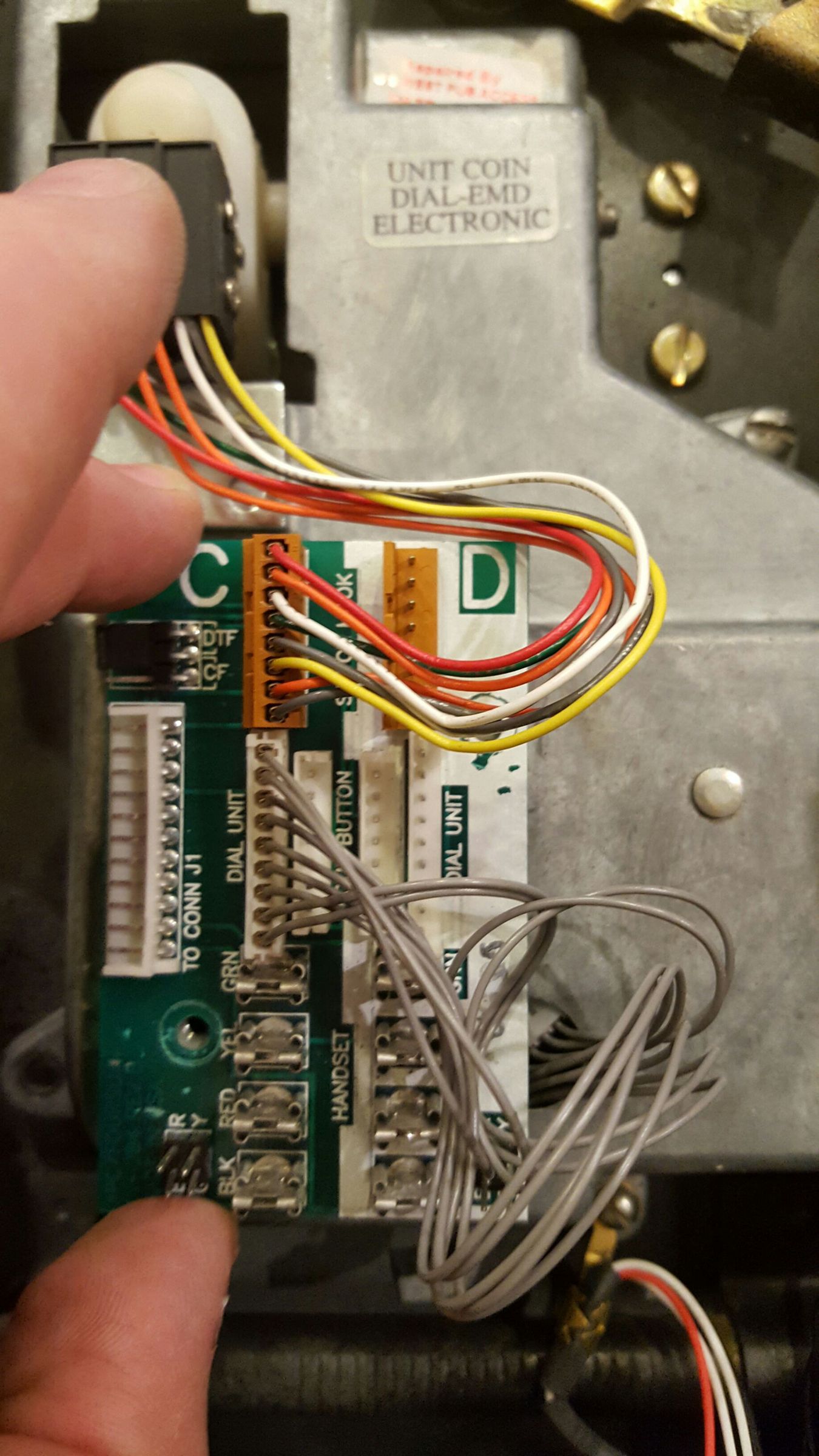

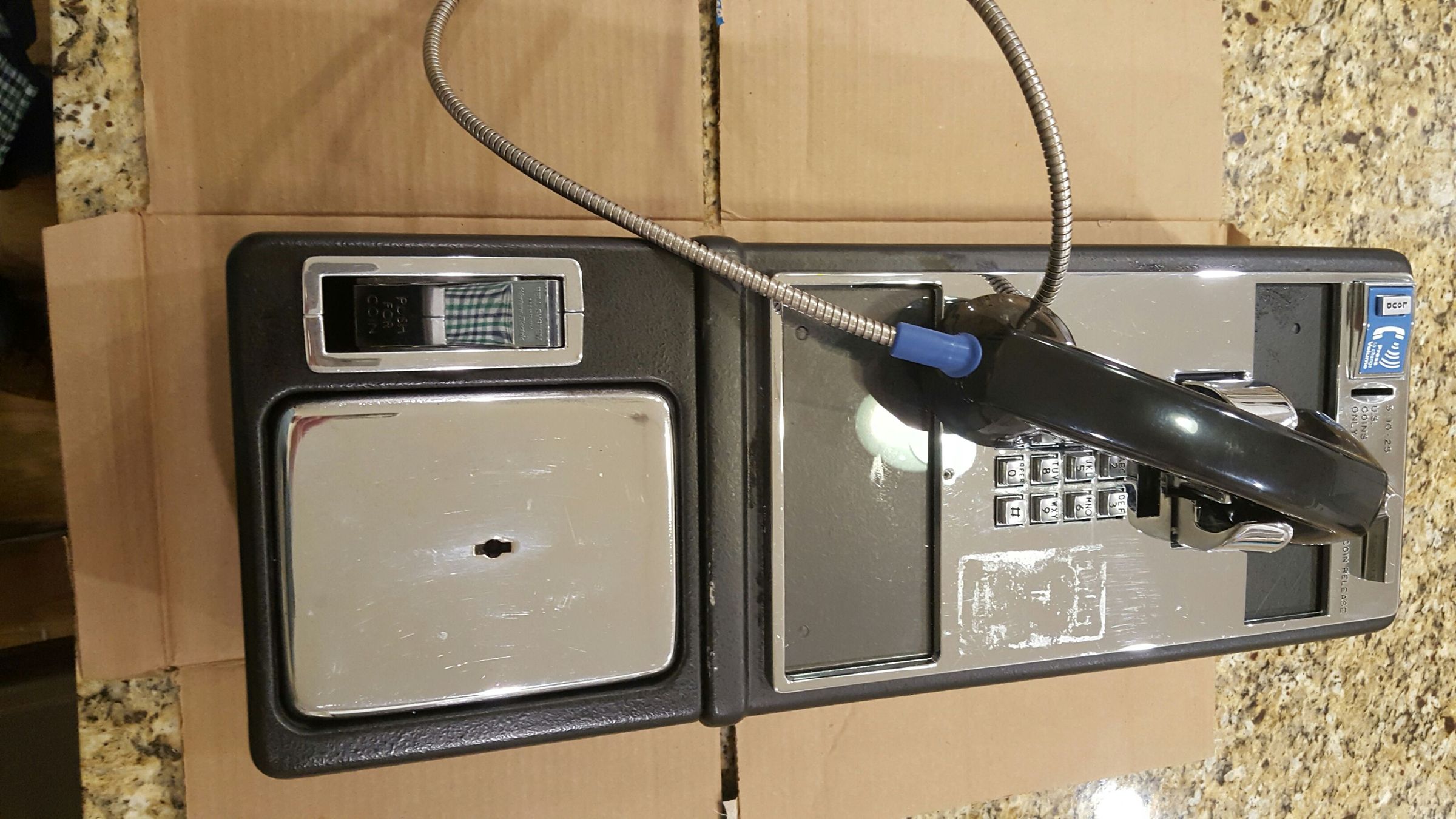

Step 2: Gut Your Phone
Wow look at those guts! The good news is our modern shields and microprocessors allow us to do away with all this antiquated junk.
There are 4 things to remove:
  1. The coin machine. Use the release at the top.
  2. The main CPU. Use the giant flathead screw.
  3. The weird grey thing. Just pull on it.
  4. The wild screw terminal thing. Cut all the connections leading to the screw terminal. We don't need any of them. If you have an older style phone you will need some brute force to remove this. If you have a newer style you can just unscrew it.
If you are feeling ambitious I believe it is possible to also hack the coin machine, but I only saw it as a hassle for people using my phone.
** Remember I hacked a few of these phones so some pictures may look slightly different because all the phones internals are slightly different. Even though the internals are slightly different all phones connections/routing are identical. **

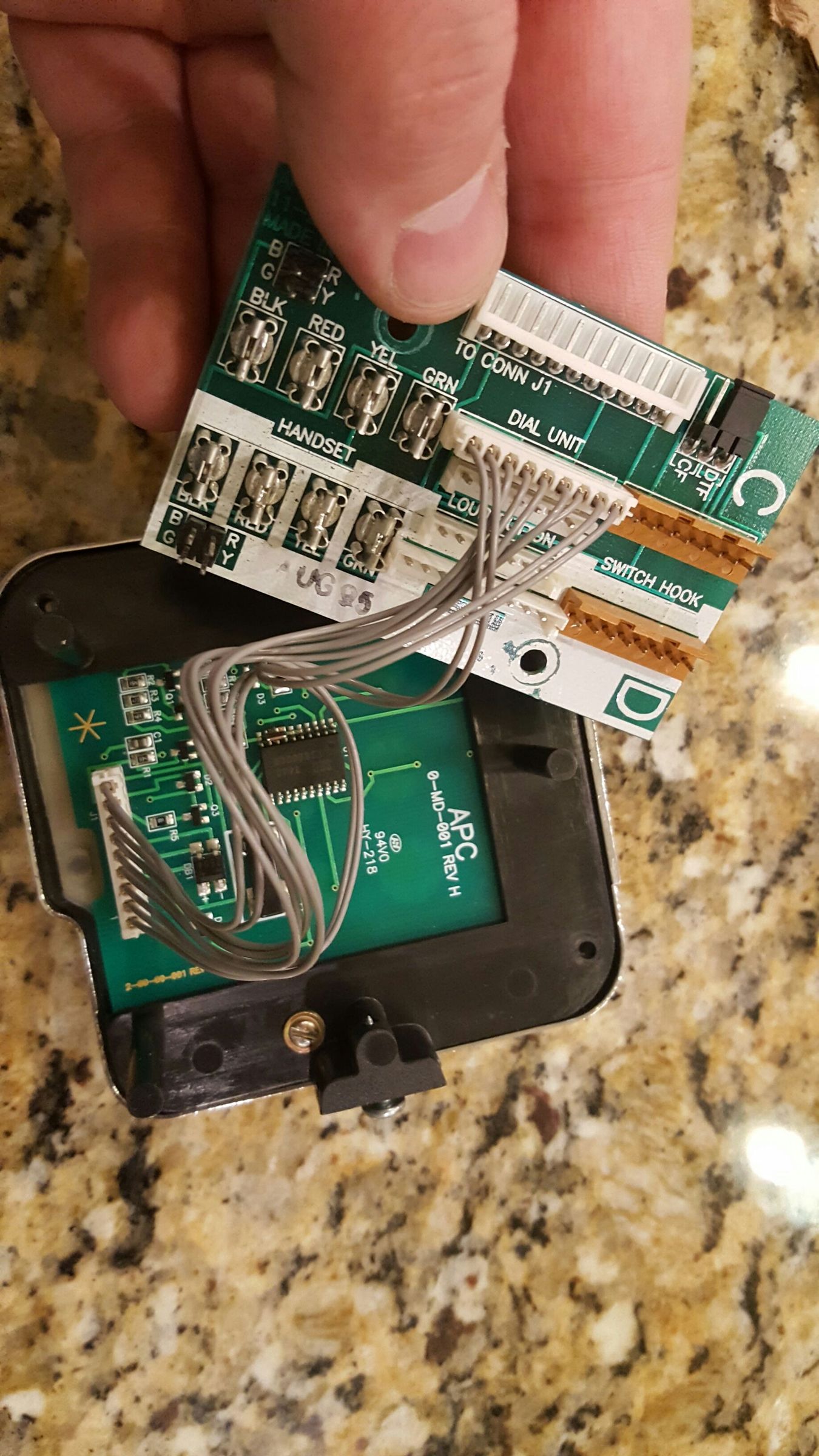

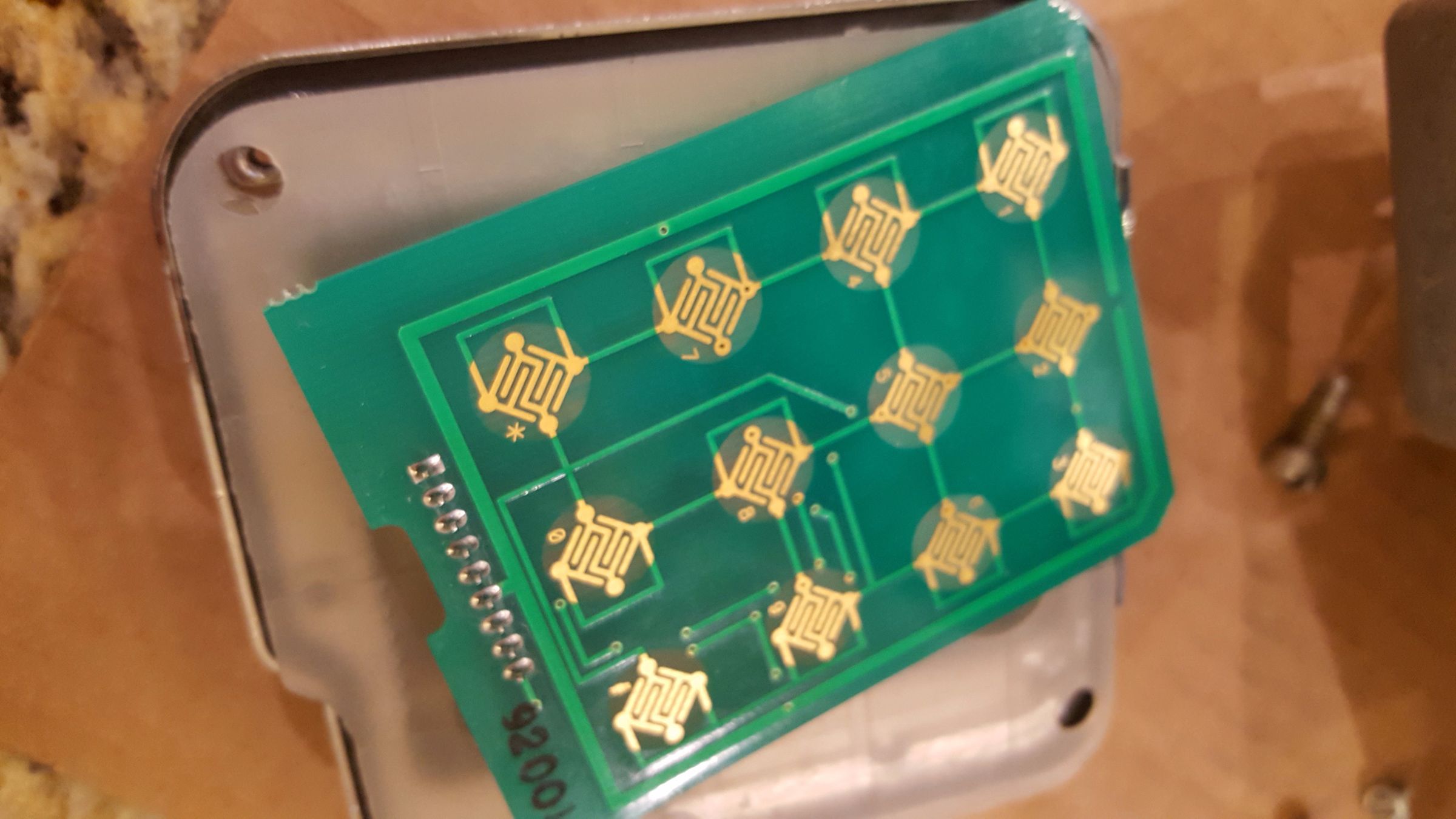

Step 3: Intercept the Keypad
The most critical part of this hack is to intercept the keypad. Thankfully the phones use a conventional 8pin-keypad-style circuit, which makes this extremely easy :)
Pull out the keypad and start taking apart each layer. The only layer that is challenging is the plastic tan-colored enclosure. It is snap fit so you have to grab a flat-head screw driver and use brute force to detach it.
Just like the last part you can cut all the free wires. We don't need them.
** Remember to cut the grey ribbon cable or the keypad will not work as expected. **
Solder 8 wires to the pins on the keypad circuit.
Every phone has the same pinout on the keypad (numbered left to right).
1 – ROW 1
2 –
ROW 2
3 –
ROW 3
4 –
COLUMN 0
5 –
COLUMN 1
6 –
COLUMN 2
7 –
ROW 0
8 –
NA
All the keypad code has been beautifully packaged into an Arduino Keypad Library. So all we need to do is connect pins to our Arduino. Specify the pins in the code. And the keypad should be working!
For our code we are using pins 30-36 of the Arduino Mega.
COLUMN 0 – pin30
COLUMN 1 – pin31
COLUMN 2 – pin32
ROW 0 – pin33
ROW 1 – pin34
ROW 2 – pin35
ROW 3 – pin36
NA – GND

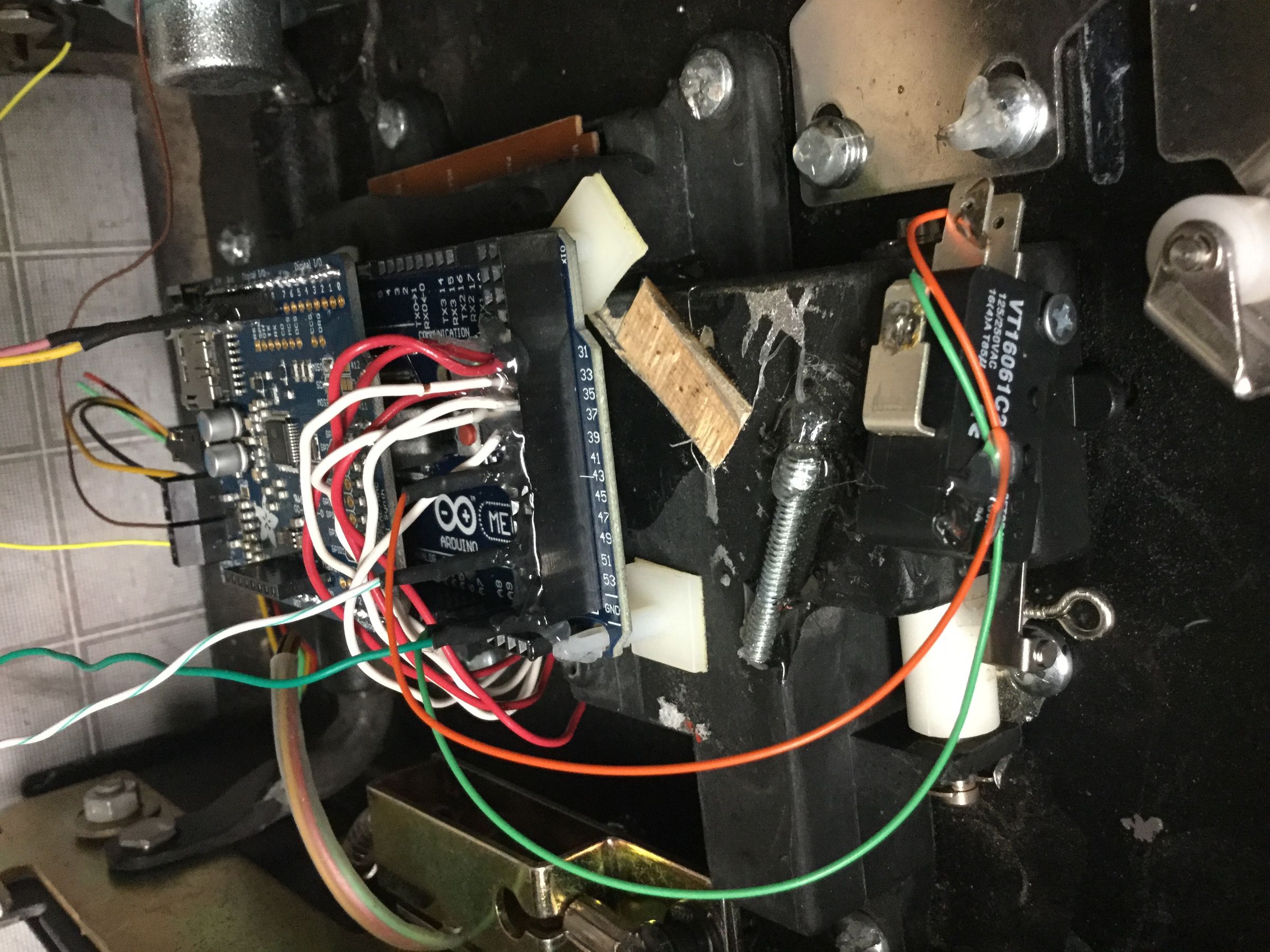

Step 6: MP3 Maker Shield
Build it!
Here is an amazing step-by-step by Adafruit.
** Remember to close the three jumpers so it will work with an Arduino Mega **
The shield has 3W outputs, which work perfectly for the speaker in the handset. Connect ONE of them to your handset speaker. And if you are just using a ringer and no music, connect the other one to a 3W speaker.
The handset has four cables connected from it. Two from the mic and two from the speaker. They are always different colors and never labeled so the only way to figure out which ones go to the mic and which ones go to the speaker is through trial and error. What I did was simply play a track from the shield and then plugged in different combinations until I found the two for the handset speaker.
Note that I did NOT use the mic for my project, but as you probably know, the MP3 Maker Shield has a mic input! So much hacking potential right there :)

Spankythemusical
Spankythemusical
4 years ago
Fuzzy, how are you connecting power to your amplifier? I've looked through all the photos and cannot see any power connections. Any guidance?
0
Fuzzy-Wobble
Fuzzy-Wobble
Reply 4 years ago
"If using the 20W speaker it is important to have 12V and >1.5A."
Just running that directly into the AMP DC INPUT.
0
Spankythemusical
Spankythemusical
Reply 4 years ago
I apologize, I think I phrased my question incorrectly. Both the amp and the Mega need power, so I'm curious if there's two power supplies needed, or if one piece is pulling power from the other piece. Thank you for your reply!
0
Fuzzy-Wobble
Fuzzy-Wobble
Reply 4 years ago
Hmm i think I actually just sent the power directly to the Mega, then used the Vout/GND pins to power to the amp (or visa versa). I definitely only used ONE power cable from the AC socket.
0

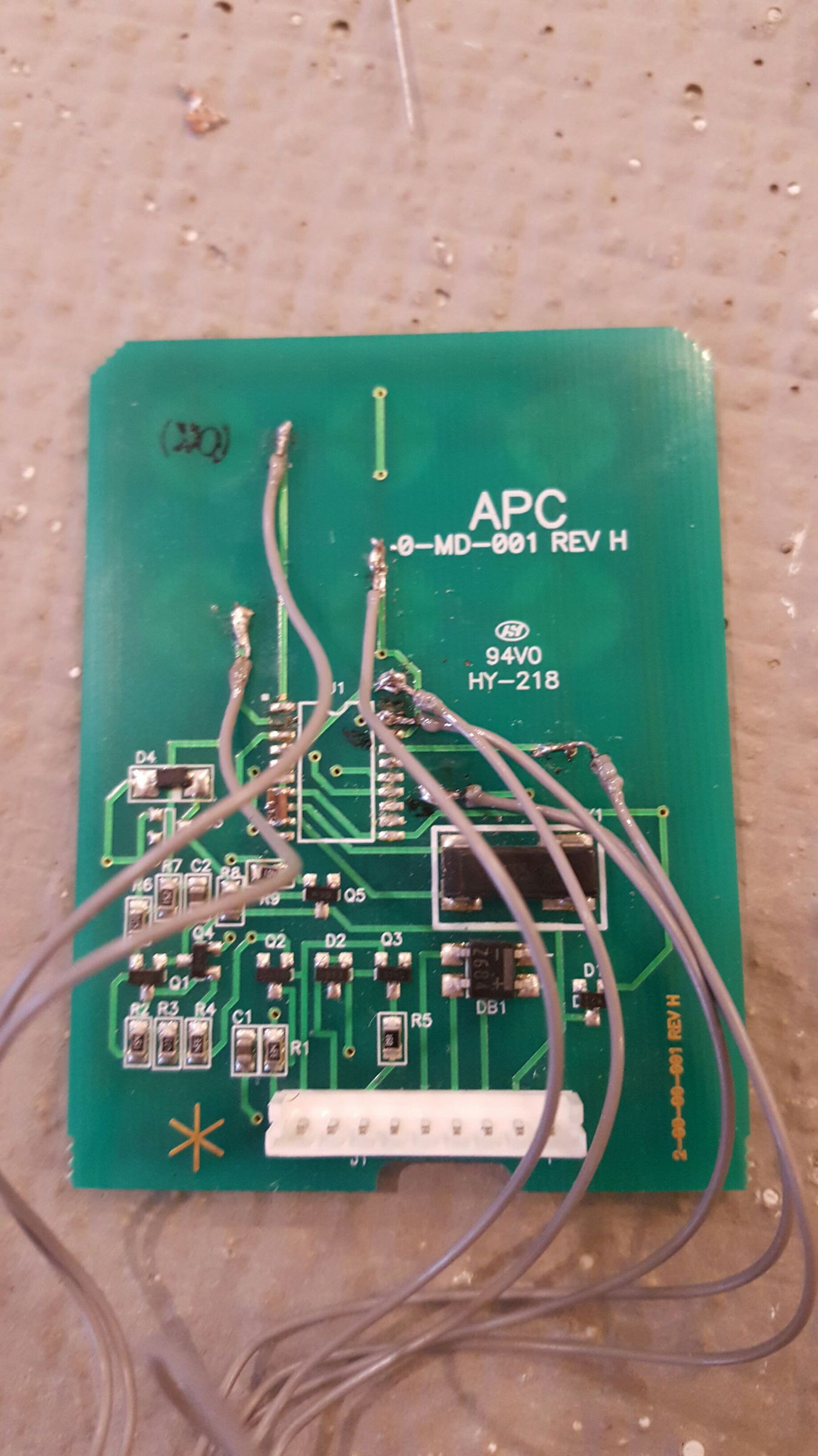

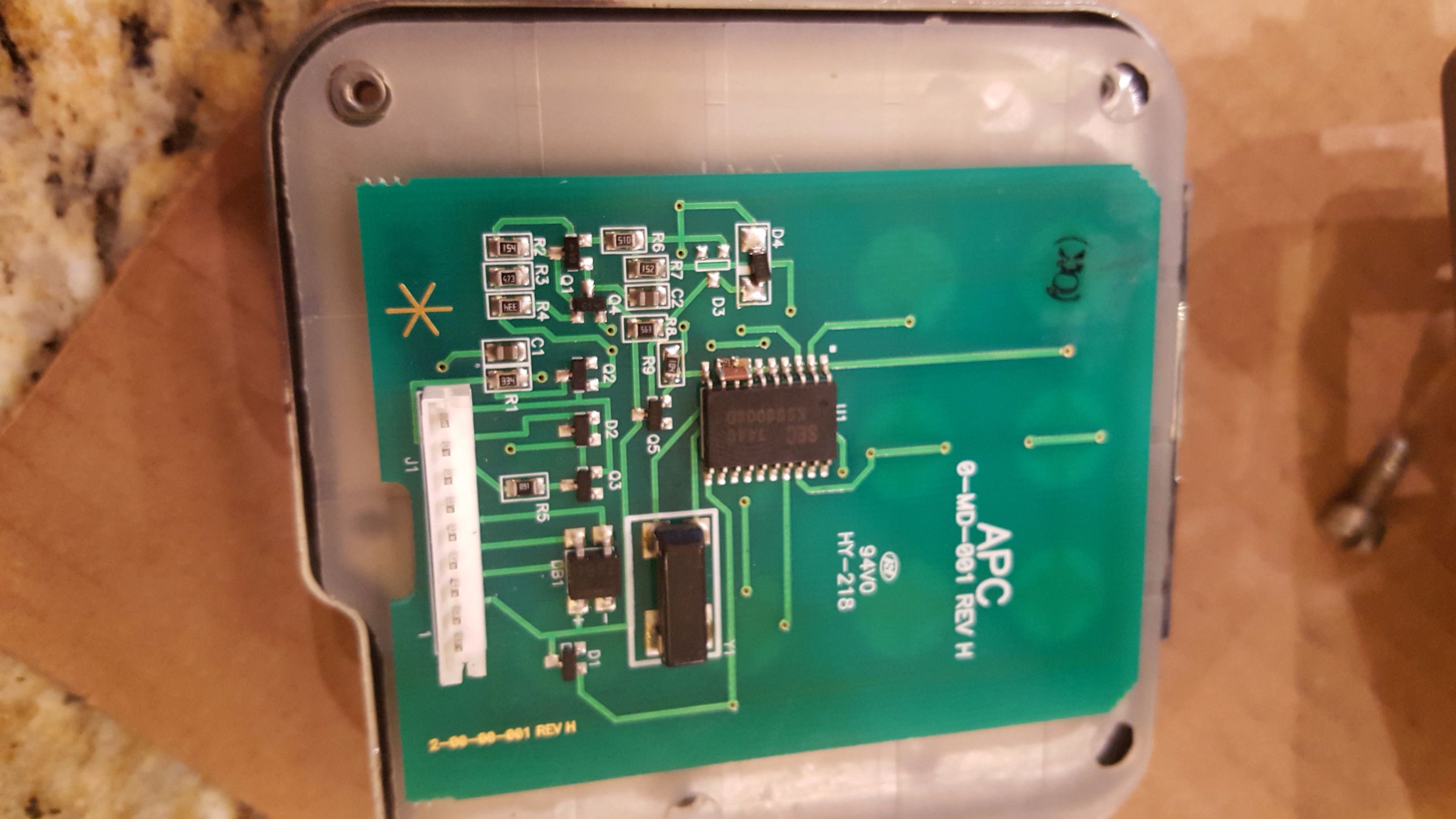

suilenrocc
suilenrocc
4 years ago
Fuzzy, thanks for posting your payphone hack, very neat creation out of some old technology.
I am newer electronics but I thought I'd try to "hack" using an old payphone I had. When I opened the keypad and used my multimeter against the circuit board, I could not get a reading on a continuity test. It's probably just me (not knowing what I am doing). The keypad on my Western Electronics looks a little newer than the phone you hacked. I am unsure on where to go to next. Would you be able to take a look at these pics and point me in the right direction? Thanks!
0
Fuzzy-Wobble
Fuzzy-Wobble
Reply 4 years ago
cool! did you try the 'procedure' explained here: http://playground.arduino.cc/Main/KeypadTutorial ?
(it was a bit confusing to me)
here is what i did. examined the traces to try and guess which ones are rows and which ones are columns. used my silicone-membrane-button-thingys to close one button at a time while getting the readout from the multimeter on the pins. within no time I knew the association between each pin and each row/column.
the thing is, that grey ribbon cable i you see in the diagram HAD to be sliced for it to work correctly. somehow the circuit on the other side of the ribbon cable was messing up the readings :( i am hoping that circuit on the backside of the PCB is not doing the same. if it is, you will have to get REALLY creative by starting to cut traces on the backside of your PCB.
can you please share a photo of the front of your phone?
0
suilenrocc
suilenrocc
Reply 4 years ago
I read through the tutorial and followed the steps. it dixnt work at the pins, and there isn't the same grey cable to cut. I did remove the extra board, but connected and took a picture of it to show that in addition to the phone. I did some more searching, mine looks like this phone, he/she provided a short explanation on how the keypad pcb could be modified. https://www.dnalounge.com/backstage/src/phonebooth/index2.html I may try that unless you have any suggestions.
0
Fuzzy-Wobble
Fuzzy-Wobble
Reply 4 years ago
If you can't get it to work just call payphone.com and request an older keypad (should be around 25$). Your phone guts look super modern compared to the ones I opened up.
0
suilenrocc
suilenrocc
Reply 4 years ago
Thanks for the direction. I worked on it this weekend and now have the keypad working. I also started on the other steps and will post when finished. Thanks again!
