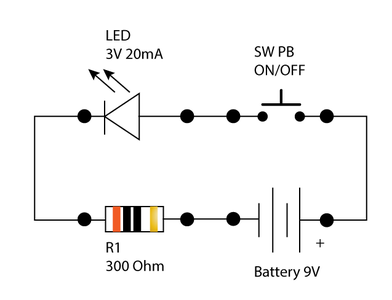

An LED gives off light when electricity passes through it. It can run at almost any voltage as long as the current stays within the design limits of the LED. Our circuit uses a 9 volt battery. To keep it from burning out the LED, we use a resistor to limit the electrical current. A switch turns the LED on and off.
The schematic shows how the parts relate. We will construct this circuit using "dead bug" techniques, so there is no need for a printed circuit board.
The math (from http://www.electroschematics.com):
(Source Voltage – LED Voltage Drop) / Amps = OHMs
Amps = mA/1000
If your LED has different ratings, you can use this formula to adjust the value of the resistor.
The wrong resistor could cause your LED to burn out!
Example:
Source Voltage = 9 volts
Voltage Drop = 3.1 volts typical for a blue or white LED
Desired Current = 13 milliamps
(9 – 3.1) / ( 13 / 1000 ) = 452 ohms; 470 ohms would be the nearest standard value.
Our LED specs:
Water Clear White 5mm
3.0-3.2V Voltage Drop
20mA Desired Current
Using the math from above, (9-3.0) / (20/1000) = 300 ohms would be an appropriate resistor.

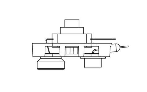

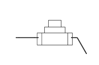

Step 5: Prep the Switch
Bend one leg of the switch to match this drawing.

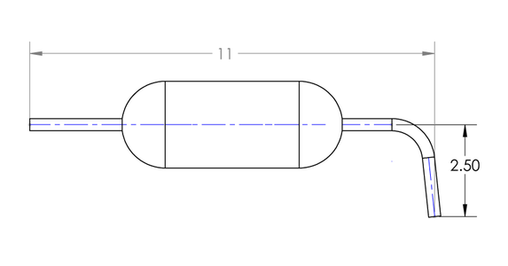

Step 6: Prep the Resistor
Bend one leg of the resistor to match the drawing. You can trim the leads to match the print, or solder it in place (next step) and then trim the ends, whichever works best for you.

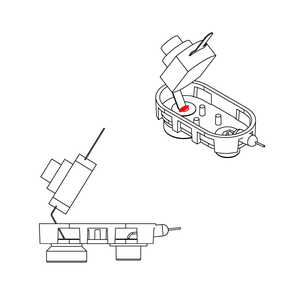

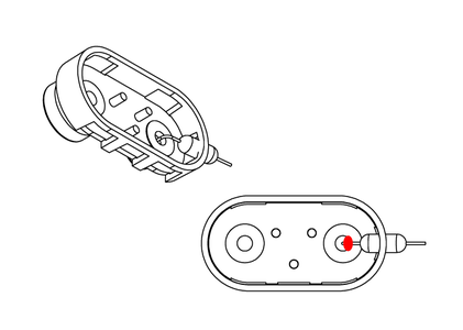

Step 7: Solder the Resistor to the Battery Clip
Feed the bent lead of the resistor into the negative terminal (-) of the clip. That's the smaller of the two terminals. There should be a hole in the plastic at this end of the clip; the resistor goes through this hole as shown.
Solder in place.
TIP: Limit the solder time to 3 seconds or you may melt the plastic on the battery clip.
Step 8: Solder the Switch to the Battery Clip
Feed the bent lead of the switch into the positive (+) terminal of the clip. That's the bigger terminal. Also the one not connected to the resistor.
Solder in place.
Step 9: Bend the Switch Into Final Position
Bend the switch until it touches the three posts on the battery clip. It should be centered between the battery contacts.

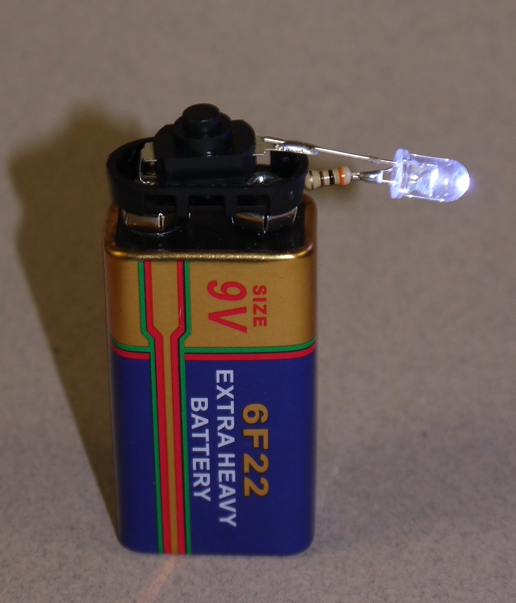

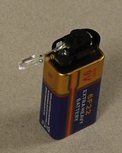

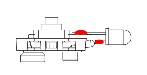

Step 10: Solder the LED in Place
Look at the picture, and make the connections to the LED:
  • Solder the long lead of the LED to the switch.
  • Solder the short lead of the LED to the remaining lead of the resistor.
TIP: Depending on how you prefer to work, it may be easiest to connect the short lead to the resistor first, and then trim the long lead to fit the switch. Or connect the long lead to the switch first, using it to position the short lead in contact with the resistor lead.
PRO TIP: The photo shows a small alligator clip holding the LED in place while the short leg is soldered. Saves burnt fingers and a lot of cussing.
Step 11: Test the Assembly
Snap the electrical assembly onto your 9V battery.
Press the button on the switch a few times. The LED should turn on and off. If it does not, go to the troubleshooting section and figure out what’s wrong.

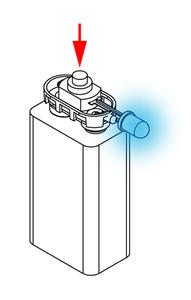

Step 12: Assemble the Electronics to the Plastic
Assemble the case:
  • Slide the LED into the groove in the flashlight case (1).
  • Press the switch into the hole in the top of the case (2).
  • Snap the battery clip into the case (3).

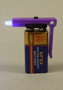

Step 13: Done!
Check the flashlight for function.
If your flashlight doesn’t work, consult the trouble shooting section (next step).
You’re done!
An alkaline battery should last for about 25 hours. The LED will get dimmer as the battery runs down. You can use any 9v battery as a replacement.

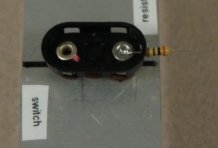

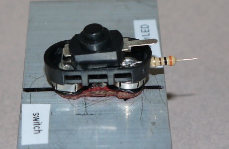

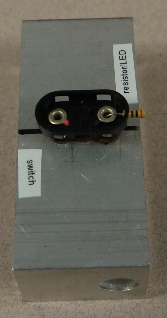

Step 15: Bonus Step: a Jig for Assembling Flashlights
Because make7i7 does these in volume, we use a jig to simplify assembly. It's easy to make your own:
  • Find a chunk of aluminum for a heat sink. Our jig uses a slice of 1x3 heavy-wall tubing, about 1-1/2" (38mm) wide.
  • Modify a 9V battery clip by trimming away the plastic until it lies flat.
  • Use 2-56 miniature machine screws through each battery contact to fasten it to the heat sink. We clamp the contact to the sink, then drill and tap using the center hole of the contact as a guide.
  • Label the jig to reinforce correct placement of the electronic components. The LITTLE contact should be labeled SWITCH. The BIG contact should be labeled RESISTOR/LED. This is the opposite of the actual assembly, because the battery clip mates to the contacts on the jig.
