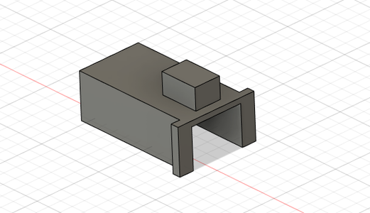

Step 2: 3D Print?
The design of this light was made simple so that everyone should be able to build this, irrespective of knowledge in the field. The 3d models were made with software called Fusion 360. All the parts were printed using PLA+ filament. Altho I printed using white filament, I would recommend going with black since the led lights can leak through the body. The files to print can be found on my Thingiverse page.
Parts to Print
1 x Base Plate
5 x Holder
1 x Power-port
1 x Cover
My print settings
100% infill
Support needed
Hot-end temperature: 200
Bed temperature: 50

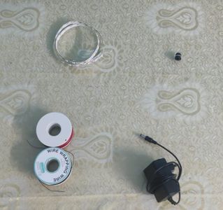

Step 4: Wiring Up
The circuit for this light is fairly simple. The circuit diagram can be viewed by clicking here. The led strips are cut into three pieces and glued using a glue gun as shown in the picture. The positive terminal is connected to the positive and the negative terminal of the led strip is connected to the negative of the power jack. And with that, we are almost done.
