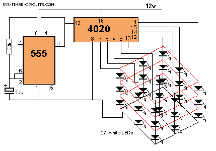

For my first build, I decided to attempt a simple 3x3x3 led cube! Which would involve absolutely no programming (I have bought an arduino but it is staying in the box for the time being). I came across a straightforward design involving a 555 timer and a 4020 14 stage binary counter at instructables.

I first built the cube using the exact values of components (except for leds, unknown) on a breadboard. I had a problem, it would not work, and I checked all connections, several times, not a flicker from the leds. Being a very simple design with only 4 components (apart from the leds), two of which were pretty much fixed. I started to play about with the capacitance; resistance and I also lowered the voltage. After a lot of trial and error, I finally came up with a working cube using the following values.
Voltage = 4.5volts.
Capacitor = 100uf.
Resistor = 91ohms.
The design of the circuit remains the same and I used 3mm leds.
Note: I don't yet know how to use CAD packages to produce pcb's so I simply used windows paint, a very painless method. As long as the proportions for the IC sockets remain the same, then the jpeg image can be pasted into Microsoft word and stretched to the correct size (works for me).
I built two one using all red leds and one using three colours, green, yellow and red like a traffic light.
