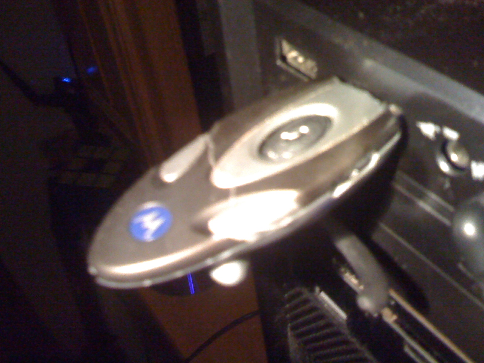

Step 3: Rigging the New Antenna
this was a pretty simple procedure all i did was run the wire thru the pen tube and the hole in the original antenna that i broke in half
i did have to widen the hole to fit the connector but that was easy to do with the knife on my multi tool
Step 4: Reassemble It Now
thats all thats left i added a little strip of tape to help it stay together but thats optional
