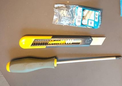

Iron
cutter
Screwdriver
Self-tapping screws
Used/Recycled speaker (of your choice)

 4. Cut the sheet of bags obtained with a cutter to the measurements necessary to compose the body of the speaker (depending on the components of the speaker used).

 7. Drill the holes of the correct size (use tools accordingly with the type of hole: cutter, screwdriver etc…).

9. Screw the shells to the edges with self-tapping screws.
