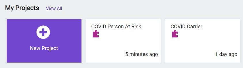

Step 2: Creating the MakeCode Projects
To prepare for this activity you need to create two different projects in the MakeCode editor.
  1. "COVID Carrier" - This project will contain the code for a micro:bit that represents a person who is already infected with COVID-19.
  2. "COVID Person At Risk" - This project will contain the code for all the other micro:bits in the simulation, representing people who are not yet infected with COVID-19.
Follow these instructions to create these two projects (we will start adding code to them in the next step)
  1. Open the MakeCode editor at https://makecode.microbit.org/
  2. Click on the "New Project" button and name the project "COVID Carrier". This will open the project, but don't do anything to the code just yet.
  3. Click on the "micro:bit" link (top left of the editor) to take you back to the front page that lists your projects
  4. Add another new project called "COVID Person At Risk"
  5. Click on the "micro:bit" link again to take you back to the front page. You should now see both projects listed (as in the picture above)

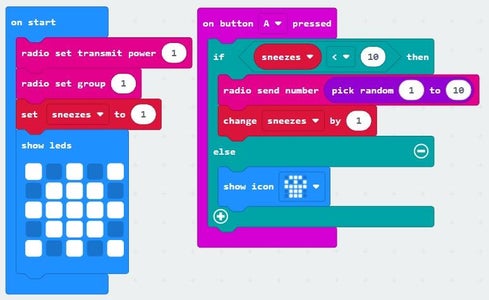

Step 3: Coding the COVID Carrier
Adding blocks to the COVID Carrier project
There are two different blocks of code that need to be added to the "COVID Carrier" project. These have the following tasks:
  1. To initialize the LED display, set up the radio channel (transmit power and group) and set a variable counter ("sneezes") that will count possible COVID transmission events.
  2. To respond to button A being pressed on the micro:bit by sending out a random number to the radio channel, up to a maximum of ten button presses. After ten presses no more radio signals are sent and the LED display changes to a skull icon to indicate that the virus in dead.
You can see the code in the image above, and also in this shared project file
https://makecode.microbit.org/_6211XEK4q0Ew
Not that the radio transmit power is set initially to 1. If you are working with a small group in a small space you can set this to 0 (the minimum). For a large group in a large space you might set this to 2. The power value will impact on how far away surrounding micro:bits can receive signals.
Note also that the radio group number has been set to 1. It doesn't matter what this value is (the possible range is 0 to 255) but it is essential that all the micro:bits used in the simulation are set to the same radio group number so they can communicate with each other.

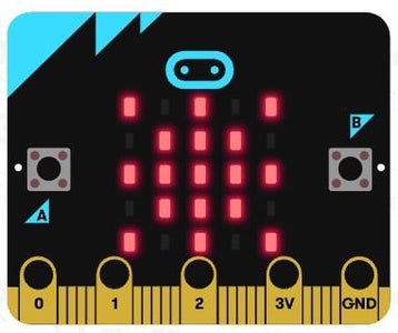

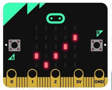

It is easy to check which code has been loaded on to a micro:bit by connecting it to a battery pack. A "COVID Carrier" micro:bit will show a COVID virus icon, while a "COVID Person At Risk" will show a tick icon

  2. When a micro:bit is infected, it first scrolls a message before showing the COVID-19 icon. Peprare the learners to look out for this message.
