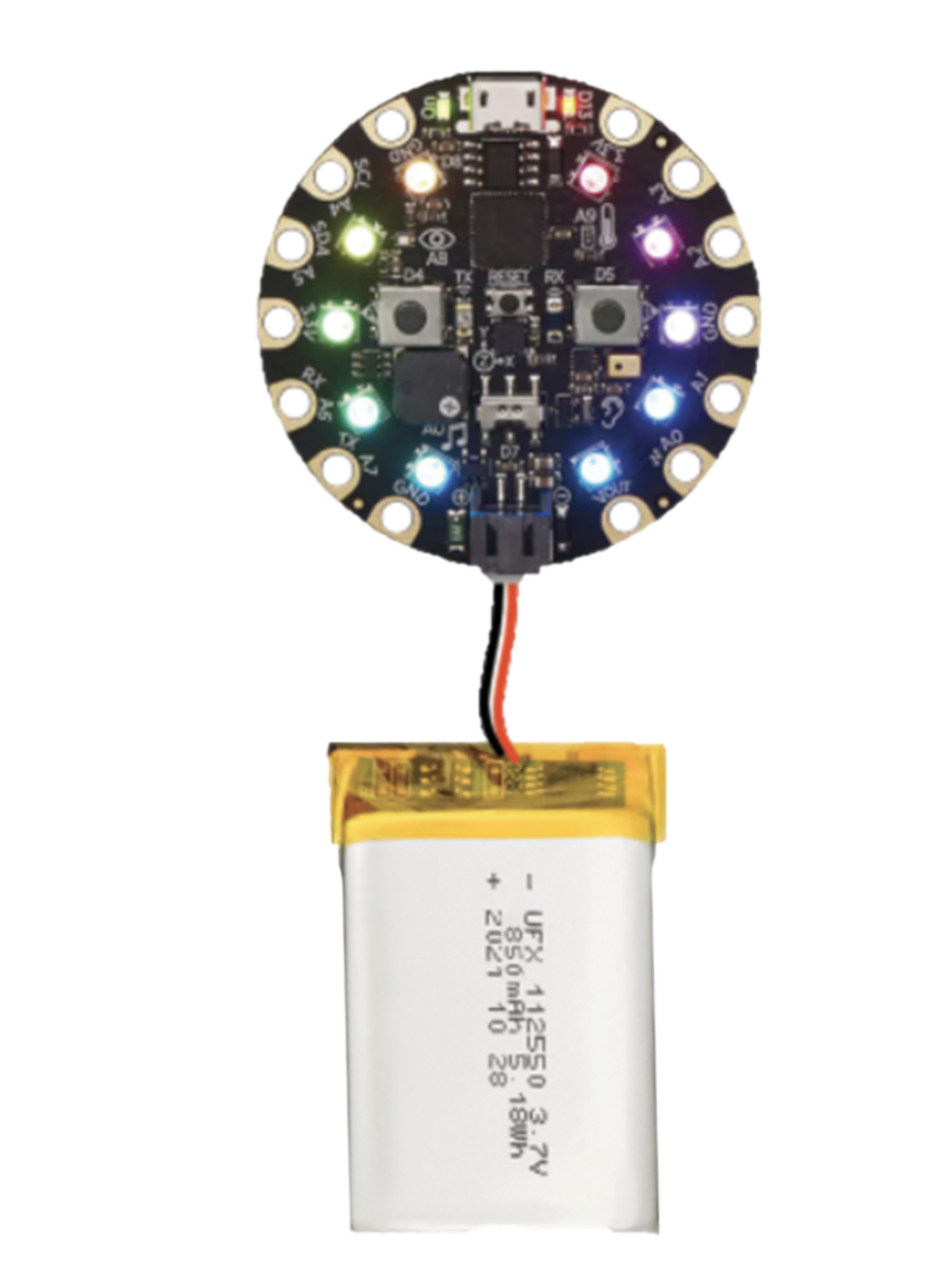

In this project, we will create a small fabric patch shaped like a chameleon. It will light up and change colors based on the surrounding temperature. We will use the Circuit Playground Classic board from Adafruit and a 850 mAh battery.

- Plug the 850mAh battery into the Circuit Playground’s JST battery connector.
- Adjust the temperature threshold if needed.
- If you want an on/off switch, you can add one between the battery and board, or simply unplug the battery when you’re not using it.
