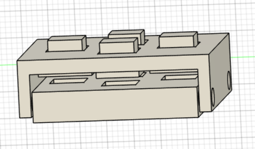

Step 1: Printing Out the Parts
After what feels like days in Fusion360, I came up with the final STLs. I printed everything on an Ender 3 with a Microswiss Direct Drive, but they should really print on any printer. I used PLA for everything including the gears. I don't believe that the slicer settings need to be very specific, but the only caution is to use a raft for the gears and hour hands to prevent elephants foot from reducing the hole diameters. Also, all parts except the RGB Hub and the Main Body should print without supports.
There isn't anything too crazy with the model, but the one thing which I found after much frustration with sticky gears is that by cutting around 0.3mm from the end of the all teeth of the gears really helps to ensure a smooth gearbox.
The front and back plates can be printed, laser cut, or cut by hand, as long as they are 3mm thick.

Step 2: Assembling the Parts
I first inserted the servo mount and buttons, putting the screws through the holes on the end, tightening into screws placed onto the part. You will also need to cut the 3mm rod to size ____. Next, I screwed the stepper motor into place using a m3 screw (only one screw fits, the other interferes with the gears, but just one tight screw seems to do the job just fine. The gear going onto the stepper motor does require some force, and I carefully used a screwdriver and hammer to get it on. Then, you will have to place the other gears onto their axles and through both the seperate piece the stepper attaches onto and into the mount which is part of the main body. Also try to put the slider on its railing on the main body at this step, but it can be done after connecting the side and main bodies, but will require some fiddling. Also attach the servo attachment to the servo before placing it into its mount. Finally, you will have to assemble the button assembly which I have provided a photo of to show you how it works. The pushbuttons need to be inserted into the button base. Screws will then have to go through the button assembly and servo mount to hold them in place.
Then you can connect the side piece to the main body using the 4 slots which go into holes in the main body. This definitely will require the careful use of a hammer. However, if you line up the two parts and it clearly seems like the slots will not go into the holes, you may have to use a chisel to reduce the sizes of the slots slightly. I had some rather significant warping so one hole was much smaller than it should have been. The slots are quite strong, but still take care. I actually managed to break 2 off, but it still all went together fine.
The bearings really aren't that necessary as there isn't much motion occurring, but without them, the rods won't fit straight. If you want me to provide some modified STLs without the bearings let me know and I will happily oblige.
You will have to cut 30 leds from the strip and place them in the RGB holder. Next you will have to place the cover with the clockface on the side of the gears, and insert the slots of the RGB holder into the holes of the side and main bodies. I would do this after soldering wires to the light strip, and place these through the cutout. You may have to rotate all the LEDs so that the start and end point of the strip is adjacent to the cutout. Again a hammer may be required to get this piece into the holes.
Lastly place the hands onto the plastic mounting point on the gear and the 3mm rod.
