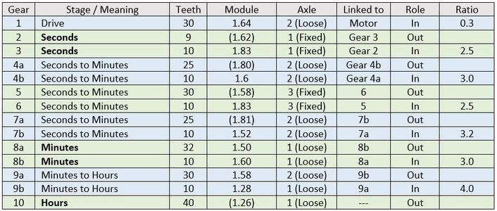

Step 3: Gear Design

The holes in the LEGO Technic bricks have a distance of 8 mm. Hence, the distance between the gears must be a multiple of 8 mm. The module of the gears defines the size of their teeth. Between two meshing gears, the nominal module must be identical. It’s hard to print gears with a module smaller than 1 mm on most FDM/FFF printers, so I have chosen modules higher than 1.2 mm for all gears. The distance between all meshing gears is set to 32 mm, so they can be placed on three axles (at 0 mm, 32 mm and 64 mm, with three empty holes between each axle).
We will use a NEMA 17 stepper motor as a driver for the clock. These motors typically have 200 full steps per revolution. Each step of the motor is expected to move second hand by one step, and this hand should – obviously – make a full rotation in 60 steps. Hence, the first set of gears transforms the angle of a step of the motor (which is 360° / 200 steps = 1.8°) to the angle needed by the seconds (which is 360° / 60 steps = 6° per step). Consequently, the ratio is 60:200 which is equal to 9 teeth : 30 teeth. The distances between the axles of two gears is determined by the following formula:
distance = (teeth_of_gear_1 + teeth_of_gear_2) * module / 2
We know the distance which must be 32 mm, so the formula must be rearranged to:
module = 2 * distance / (teeth_of_gear_1 + teeth_of_gear_2)
Hence, we find that the module must be 1,64. Theoretically, both gears must have precisely the identical module, but as FDM/FFF printers are not very precise in this range, we lower the module of the bigger gear to 1,62. Hence, we get some backlash here. This should reduce the risk of a blocking gear chain which can result from gears coming out too big from the printer, as its resolution in X/Y direction is typically limited to 0.4 mm.
In the next stage, one full rotation of the second hand (= 60 steps) must result in only one step of the minute hand, so the total ratio of this stage is 60:1 (downscale). Doing this in one go would result in very big gears, so we split it up in four parts: 10:25 ➔ 10:30 ➔ 10:25 ➔ 10:32 (= 2.5 * 3.0 * 2.5 * 3.2 = 60).
Subsequently, we do the same again for the translation from minutes to hours, but here we split the downscale in only two parts (10:30 and 10:40), resulting in a total scale of 12:1 since a total rotation of the minute hand only rotates the hour hand by 1/12th. The overall set-up is listed in the attached table where the colors indicate the sense of rotation of each gear.
With these transmissions, seconds, minutes and hours have the same sense of rotation. If you attach a pointer to the corresponding gears, you will have a “proper” clock. However, as the digits for minutes and hours are attached to the gears, they will move instead of a pointer. Hence, the numbers on top indicate the correct time, which requires the numbers for minutes and hours to be arranged counterclockwise.
As another detail, I made the gears "curved". This way, the gears are "self-centering" and cannot move along the axle. This is typically achieve by using herringbone gears, but the curved design with no sharp apex point is easier to print on some FDM/FFF printers and has (approximately) the same effect.
