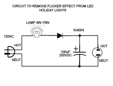

Basically I'm using a low wattage 120VAC incandescent lamp, as a cheap power resistor. To make it adjustable, I use a miniature bulb socket for the lamp so that different small AC lamps, typically used in night lights or decorative lights, can easily be swapped to achieve the desired brightness. Such lamps MUST be incandescent (not LED) types. Higher wattage lamps will have a lower resistance and thus will pass more current on to the LEDs. The lamp is followed by a diode and a 100uF electrolytic capacitor, rated at least 200VDC. That capacitor is probably the only part you may have to hunt or buy. Its voltage rating is higher then you may have in your junk box, particularly if most of your electronic projects have been with low voltage supplies. It's the kind of capacitor you are more likely to have if you've worked with vacuum tube circuits.
Step 2: How It Works
This circuit just converts the AC to filtered DC, while dropping the voltage to compensate for the higher voltage that naturally occurs when AC is rectified and filtered. The conversion and filtering is not high quality, but the load from these LEDs is so small it doesn't take a great deal of filtering to do the job. We simply want it to work well enough so the LEDs never actually turn OFF or significantly dim during the non conducting AC half cycles. Instead, the capacitor supplies power to the LEDs during those brief intervals. However, a resistor is still needed to cut the voltage some! First of all, 120VAC actually translates to 170 VDC when simply rectified and filtered. Second, the LEDs were originally intended to operate during only 1/2 of each AC cycle. So together these factors mean the LEDS would draw too much continuous current from a simple filtered DC supply. Without the LAMP (resistor) in this circuit, they would glow much brighter then when plugged in to ordinary household AC. You can certainly bypass the lamp to see this for yourself, but if left to operate that way it will almost certainly shorten their lifespan.
So why a lamp instead of a resistor? Well let's assume a 7 watt (typical) rating of a 100 LED string. While the math can get a little involved, it stands to reason that a 7 watt 120VAC lamp in series with the 7 watt LED string is a reasonable starting point. In this situation the 7 watt lamp obviously would not actually draw 7 watts, but for safety's sake a substituted resistor should be able to handle similar power. Well a higher wattage resistor like this would be a hard to find part and if you string 5 or more LED sets together, they will require even more power to reach the same brightness. Then if you don't like the final brightness you'd be stuck. A variable resistor might seem like a better solution, but a variable designed for such power is typically a wire wound rheostat, which would not only be large but could cost more than this whole project. On the other hand, a lamp socket allows you to simply screw in several small 120VAC lamps, and regulate the brightness just by substituting different bulb wattages. You'll likely find night lights and "flame" shaped bulbs ranging from 4 watts to 25 or more, and it's a cheap arrangement that works. Beyond being functional, the dim glowing lamp in the project makes for a fun looking "steam punk" conversation piece.

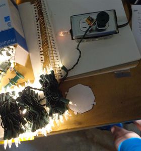

Step 3: My Internal Layout, and a Bench Test

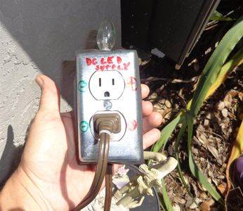

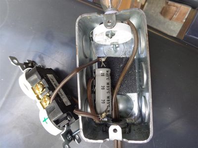

This is the device I threw together. I used a miniature lamp socket along with a metal junction box, a 120V socket, and a junction box clamp for holding the incoming wire tightly. The metal junction box should be the deeper kind so that you can comfortably fit all the other parts inside, along with the socket. These parts are all available at places like ACE hardware stores. An old polarized lamp cord was used at the input. Punch outs in the junction box allow for easy entry of the incoming line cord, and a convenient starting point for mounting a lamp socket.
Mounting that lamp socket as I did was a little tricky. I drilled extra holes in the box to line up with two mounting holes on the lamp socket, but that was the easy part! I had to come up with some spacers to mount the socket on the inside, so that the lamp socket's wiring screws were spaced slightly away from the metal box, to avoid a short. But at the same time I found that if my spacers were too long, the AC socket would no longer fit without bumping into the lamp socket. It all took a little ingenuity and "finagling", but in the end it all fit together well. In all honesty, were I to make another such unit, I'd look for a different kind of lamp socket, perhaps a thinner one intended for use as a replacement socket in a small desk lamp. I probably could have found one in a thrift store. Live and learn.
When wiring this project, its wise to make sure the "HOT" wire from the AC source (which is connected to the smaller 'prong' on an AC plug) is the one that gets connected to the lamp, as shown in my crude schematic. At the very least this helps limit the current, should the output of the completed device ever become shorted to ground. A sure indication that is happening, by the way, is that the lamp would glow at full brightness. Also for safety, consider where you'll put this finished device if used outside. Obviously you'll want to place tt out of direct rain and off the ground so it won't ever sit in standing water. I used some clear silicone caulking wherever there was an obvious opening (like around my lamp socket, but at best this just makes it water resistant, not water-proof!
