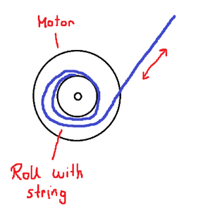

Step 2: Shaft
Here is how the Moter and string are connected.

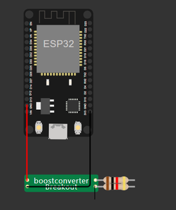

Step 4: ESP32
I added a tazer because you never know when some bad guys are going to try and steal something LOL.
