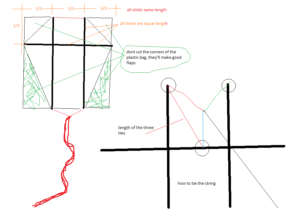

    Sorry, but in Ecuador people (kids) have been using plastic bags for ages. They also use split bamboo sticks. and they use rag strips for the tail. HOWEVER they almost never use th + shape. they make an "H" instead see picture
