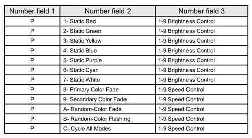

Setting Up Program Modes on the RGB PAR 64 lamp From Elemental Led:

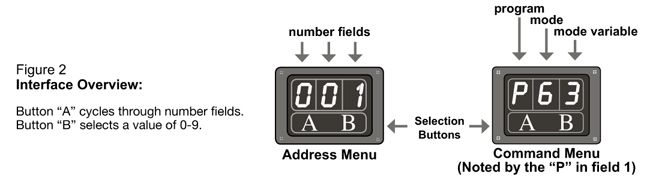

If you are not using a dmx controller you will want to run your wall washer in an automatic standalone mode. The wall washer I am using is simple to setup as it only uses 2 buttons. Image 3 shows a diagram of the screen and the location of each button.
- On first power up you will be presented with a 001 on the screen.
- Press button A multiple times until a letter P appears on the left part of the screen and a flashing letter or number apears in the middle part of the screen.
- Now press button B until the middle number becomes an 8. This will run program 8.
- Use button A to select the right part of the screen.
- Press button B to select a number from 1 to 9 to determine the speed program 8.
- Repeat this process for programs 8 to 9 then A and B.
- Once you have set up the programs, you can select program C, which cycles through the above mentioned programs.
- The number next to the C determines how many time the programs will run before switching to the next program.
