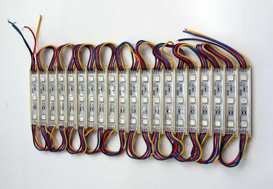

RGB's are usually limited to just 3 LED's per module. They have 4 wires connecting them, one for power and then 3 others, one for each color. In order to work correctly you HAVE to use a controller. If you buy a strip with an included controller then you have no problem. If you buy a strip alone you will need to get one for it. The good news is that you can control many strips with just one controller.
I made it a habit to test each strip as I received them and discovered that they are not all wired the same. The power is always the same but sometimes the color wires don't control the color they are. So one strip will be green and the other red. This is really annoying but also really good to know BEFORE you solder everything together. Always test them to find out which color is which.
RGB's are more expensive than single color. And I can understand that. They take more work to wire them up.

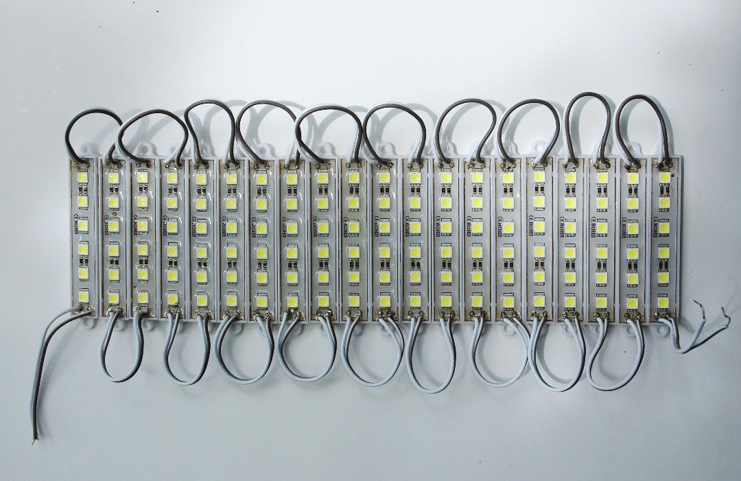

The first strip I bought was a single 3 light strip of 20. I wanted to see what they were and what they could do. I had seen (and bought) the long string of LED's but these strip ones were new to me. The 3 LED's per module was pretty standard. Then some with 5 showed up and lately some with 6. There is a square one that has 4, either in one color or RGB. The most so far that I have seen has been 6 LED's on one module. All the modules always require 12 volts no matter how many LED's they have.
Keep in mind that the more LED's there are the higher the power requirements to run them. For some things the 3 's work great. But if you need more light then the higher number might work. The more LED's per module, the more they cost.
There is something strange going on with the power requirements. The manufacturer often gives a number of watts for each individual LED. But in experimenting with them the numbers don't add up right. Now I have been seeing disclaimers from the sellers that the manufacturers numbers don't add up and that you can't rely on the wattage being what they say. So no body appears to really understand just what the ratings are. I used my own meter and went by that. Basically if the power supply you are using doesn't overheat then your OK. If it does then you need a bigger power supply.
The number that you often see in the description refers to the physical size of the LED's. The 5050 LED is the larger brighter one. I avoid the smaller ones. Most of the strips have 5050 LED's. A lot of the long strings have smaller LED's because they are not intended for lighting as much as decoration.

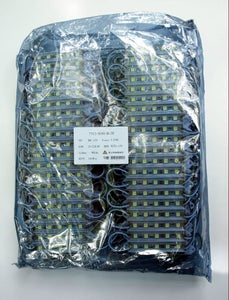

The LED's that I used were ones I bought in a bulk pack, buy it now deal. The are similar to this :
http://www.ebay.com/itm/361102191614?_trksid=p2055...
The ones I bought were a little cheaper than this, but notice the free shipping. They will send you a large box with 30 LED strips (3 of the packages in the picture) all the way from China and do it for no charge. Not to bad.
600 modules is 30 strips. Thirty strips for $212. comes out to be close to $6.90 each.

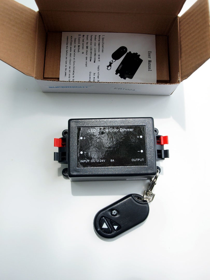

To turn the string on and off and control the brightness you need a controller. For single color ones there are simple in line switches. Some of the better controllers work on RF with little remotes. Interestingly I discovered that most of them operate on the same frequency so one remote can control multiple switches.
The little in line units have a limited power capacity. You can burn them out if you go past what they are rated for. Bigger unites that can handle more power are not as mobile. There are lots of choices available with new designs showing up all the time.

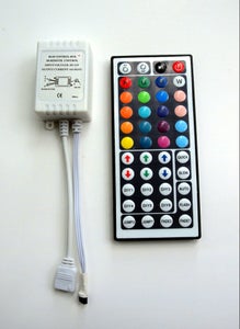

For the RGB units you need a special controller. The most common one is an infrared one with 2 different key size remotes. They work. But a way better one that I tried is the touch sensitive remote that is RF. I really like the unit. Below are a few searches for different controllers.

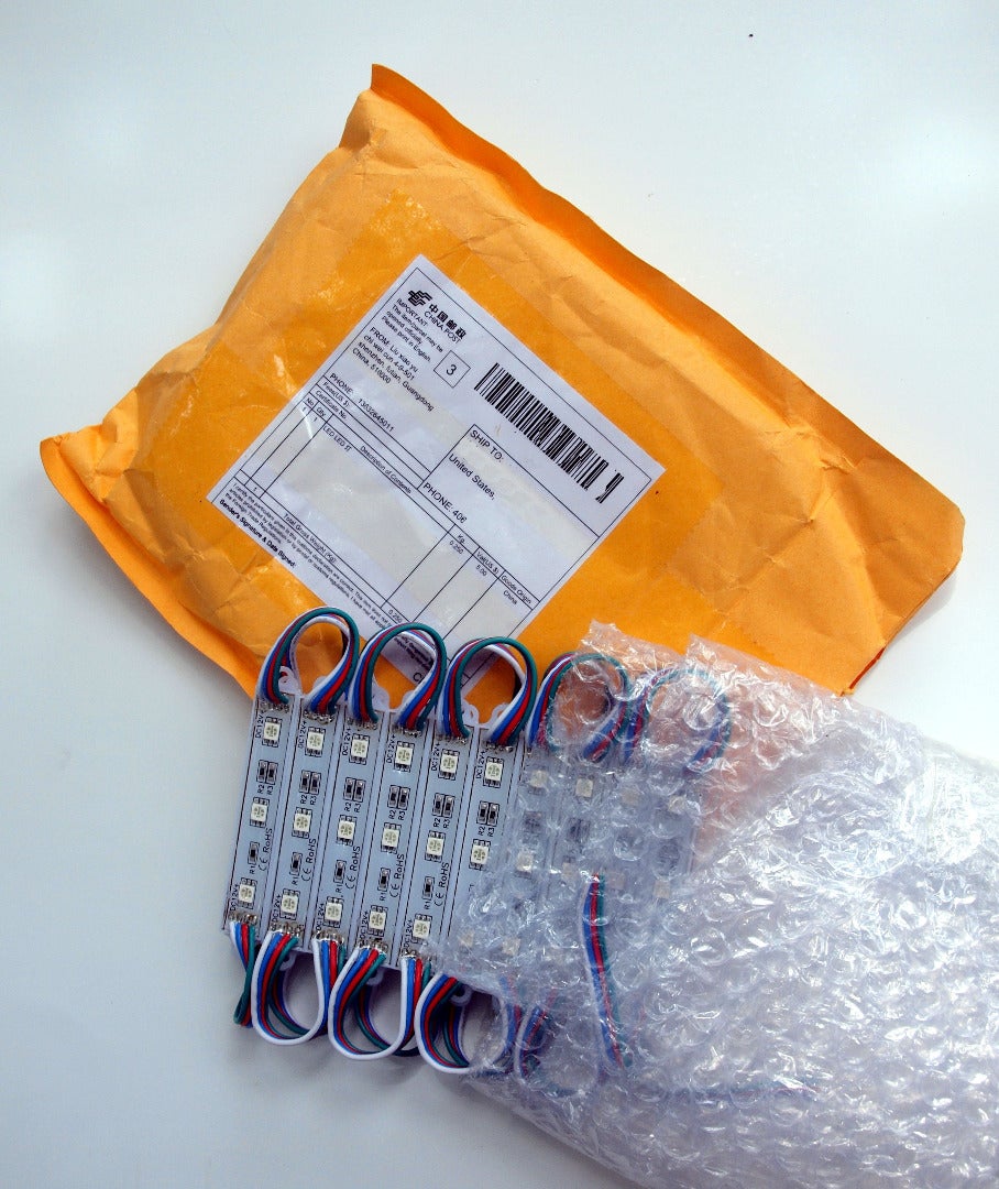

A few rare times I have received what I would call seconds. Items that still worked but had things wrong with them. Like the picture shows, a few modules had some melting on them and the resin coat seal was messed up. It has been a very rare thing, but like in any thing you always take a risk. If it's really bad then let the company know and if necessary file a complaint. If it not a big deal make note of the company name and either don't buy from them again or buy with caution.
