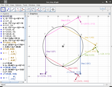

I recently researched a presentation program called Impress (part of LibreOffice). In particular, animation effects for objects. This is when objects appear, disappear, move, etc. One of the results of these studies was the presentation "How to Draw a Regular Hexagon Using a Compass". I needed to calculate the coordinates of the snap points. A graphing calculator is best suited for this task. I chose Geogebra.
I needed to calculate the coordinates of 12 points. Six of them are the vertices of the hexagon. The rest of the points will be needed to position the ruler.
Step 1: Hexagon Vertices
This is not difficult to do.
Note:
In the Geogebra, the ordinate axis is directed upward, and in the Impress - downward. For calculations in Geogebra we will use the fourth quadrant only. We will receive negative values of the Y coordinate. When transferring coordinates to the Impress, we will discard the minus sign.
