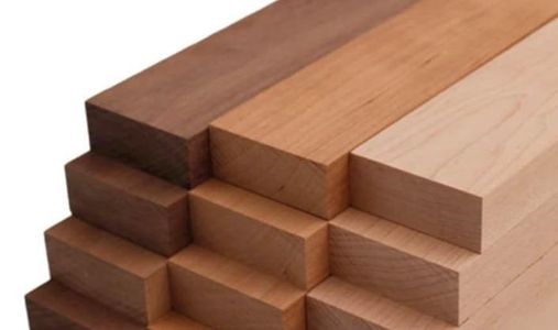

  1. Three contrasting woods (for example: light-tone maple, medium-tone cherry, dark-tone walnut — or any trio of woods with good contrast)

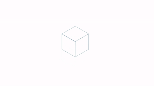

Step 1: Design the (Illusion) Pattern
The tumbling-block illusion uses three diamonds (aka rhombi) arranged at 60° intervals:
  1. Decide on final diameter of your Lazy Susan (common: 12"–18")
  2. Measure out wood strip width (this establishes the cube size) (mine were 1")
  3. Plan rhombi pattern (light-left, dark=top, medium-right)
Design a layout for the tumbling-block pattern to cover a circular disc.

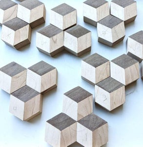

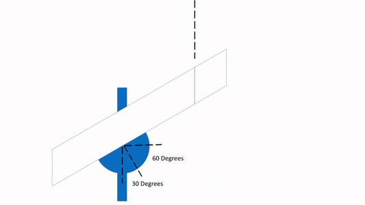

Step 2: Cut the Wood Strips & Diamonds (Rhombi)
Make the component pieces:
  1. Rip three contrasting hardwoods into equal-width strips.
  2. At the table saw with a miter gauge set to 60°, cut consistent rhombus pieces.
  3. Sort by species: light, medium, dark.
  4. Dry-fit a section to ensure clean geometry and contrast.
TIP: Cut extra pieces to allow sorting for best grain and contrast.

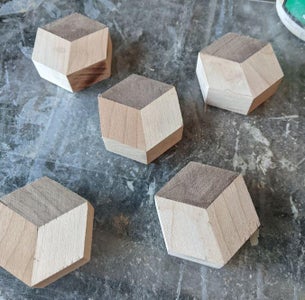

Step 3: Assemble the Tumbling Block Panel
Now the fun and magic starts:
  1. Lay the rhombi out into the tumbling-block pattern.
  2. Glue pieces together in small clusters of 3 then fit to center cluster of 8 piece.
  3. Combine small clusters around the center cluster to build out the full panel slightly larger than your final circle diameter.
  4. If you used a plywood base, the glue up is a bit easier.
Once dry:
  1. Scrape excess glue.
  2. Sand flat (120 → 220 grit).
  3. Check for gaps and fill if needed.
  4. Confirm that the panel is a bit larger than your final circle size. This ensures safe trimming on the bandsaw, router, or jigsaw.

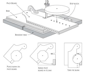

Using a Bandsaw Circle-Cutting Jig (See Jig Ops below )
  1. Set your jig’s pivot point to radius = (final diameter / 2).
  2. Attach the Tumbling Block panel to the jig using:
  3. A small screw through the bottom center, or
  4. Double-sided tape if you prefer no screw holes.
  5. Align the pivot point on the jig with the bandsaw blade.
  6. Slowly rotate the panel through the blade.
  7. Maintain steady pressure — let the jig maintain the perfect arc.
You’ll end up with a clean, precise circle that shows off the tumbling-block pattern beautifully.

Jig Ops:
  1. Clamp the base to the bandsaw table so that the pivot pin and the circle holes are lined up with the front edge of the bandsaw blade.
  2. Lift the pivot board off the base and install a pin in the desired circle hole.
  3. Center the blank on the pin.
  4. Fit the pivot board back on the base with the blank well clear of the sawblade.
  5. Start the bandsaw and swing the pivot board into the sawblade which will cut a reverse circle into the scrap area of the blank. When the pivot board meets the stop block, rotate the blank to cut a circle.
An advantage of this jig is the ease of changing circle diameters. Just liftoff the pivot board and reposition the circle centrepin. There is no need to remove the whole unit from the bandsaw.

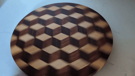

Step 5: Attach Lazy Susan Turntable Hardware
Almost done:
  1. Attach the Lazy Illusion bearing to the bottom.
  2. Add rubber pads to the bottom to protect surfaces.
  3. Gently spin and watch how the cube illusion seems to shift, fold, or invert depending on angle. Lighting makes a huge difference, so experiment with shadows!
Step 6: Enjoy Your Dynamic Art Piece
The tumbling-block pattern is a centuries-old optical illusion (usually seen on quilts).
I thought it would be fun to put that on a Lazy Susan since it's built to spin. You can watch an ever-changing
work of art that creates the illusion of depth out of flat wood. A simple rotation makes the board come alive.
